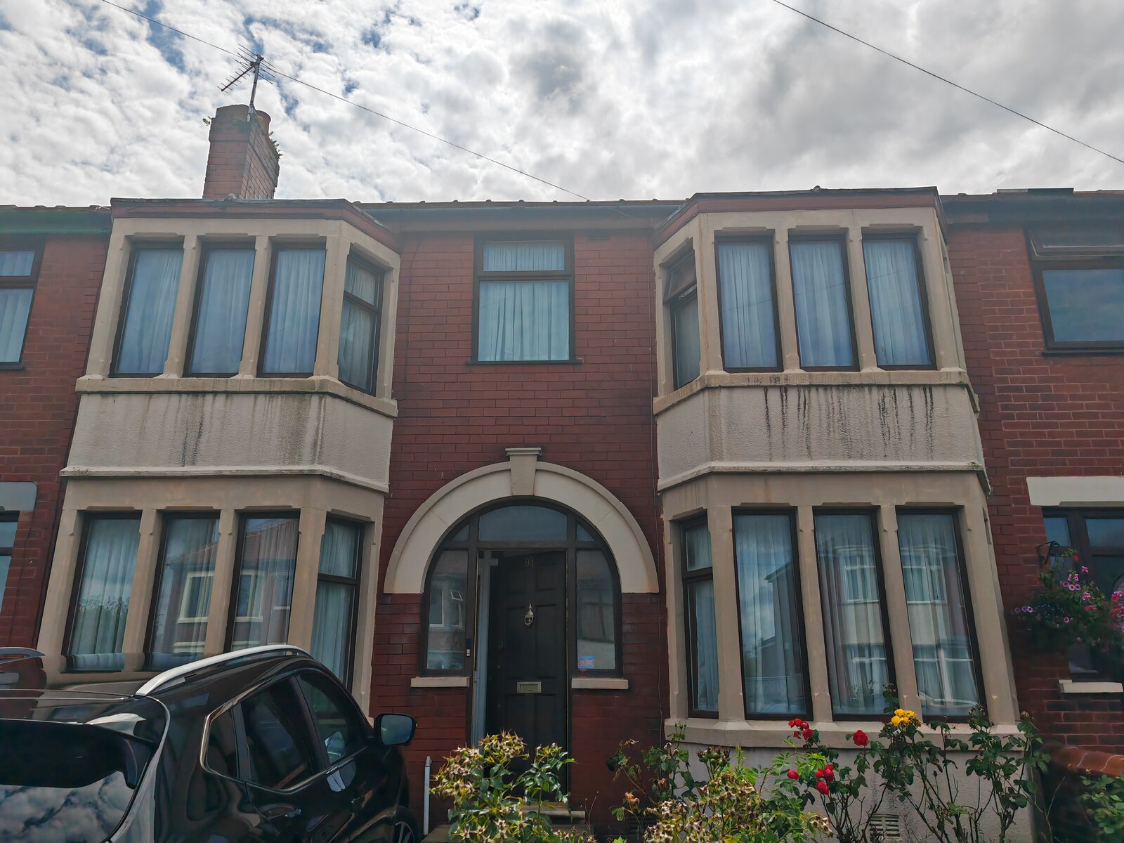

I own a 30's double fronted mid terrace. The front bays have both started overflowing down the front of the house. Initially I though this was a roof gutter issue so had it cleaned and checked. Unfortunately it's still overflowing when it rains off the bays. I can't fit guttering to the bays (the obvious fix) as there's no drainage at the front of mine. A roofer suggested new fiberglass roofs (the ones in are fine that said) with a better drip edge. However, the draining holes he'd fit would still redirect some water over paint stone work leaving a possible unslightly black stain - he said it very well might. I'm perplexed re how to fix this. What's being suggested seems to be just moving it overflowing from the front to the sides. Has anyone any ideas?

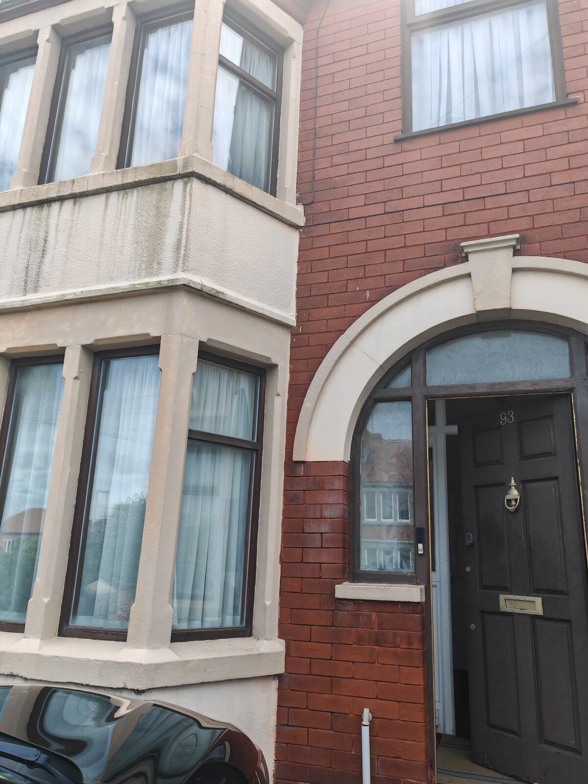

As can be seen it's coming off the bays down the front. The Roofer wanted to fit two new fiberglass roofs with much better lips and drainage holes towards the door. I'm a bit concerned I'm just moving the overflowing to the inner windows of the bays.
If this has only just started then it's not a drainage issue, nor an edge design issue.
Those roofs have always "overflowed", so you need to find out what has changed, and rectify that. It could be something as simple as needing a good clean (the roof and/or the bay) as the overflow is filthy and thus visible. Or the roof may be holding water due to age, or the edge drip deformed again due to age.
It looks like lead, so may well be able to be re dressed or relaid. Otherwise, the remedy may well be recovering, but that should not involve introducing design changes or drainage that was not there previously.
Basically, drainage is not the issue so don't base any remedy on that being the primary factor.
