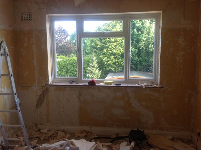

This year I continued where I left off and decorated the front room and have started on the rear room. As it turns out there seems to be more cracks here I have to again deal with but as again would like thoughts from all. These are the images
. I broke the plaster around the crack to get this view. tThe crack does not seem as bad as the front room. The window was not put in by me, and so no resort with a window company. Other facts are it is a cavity wall and resting on a steel that goes over an extension I put in a 3 years ago. However I have a feeling this crack existed prior to the extension. There seems to be a mirror image crack on the other side of the window but this has been filled in probably about 8 years ago. Do I need someone to come in and strap this as well?
