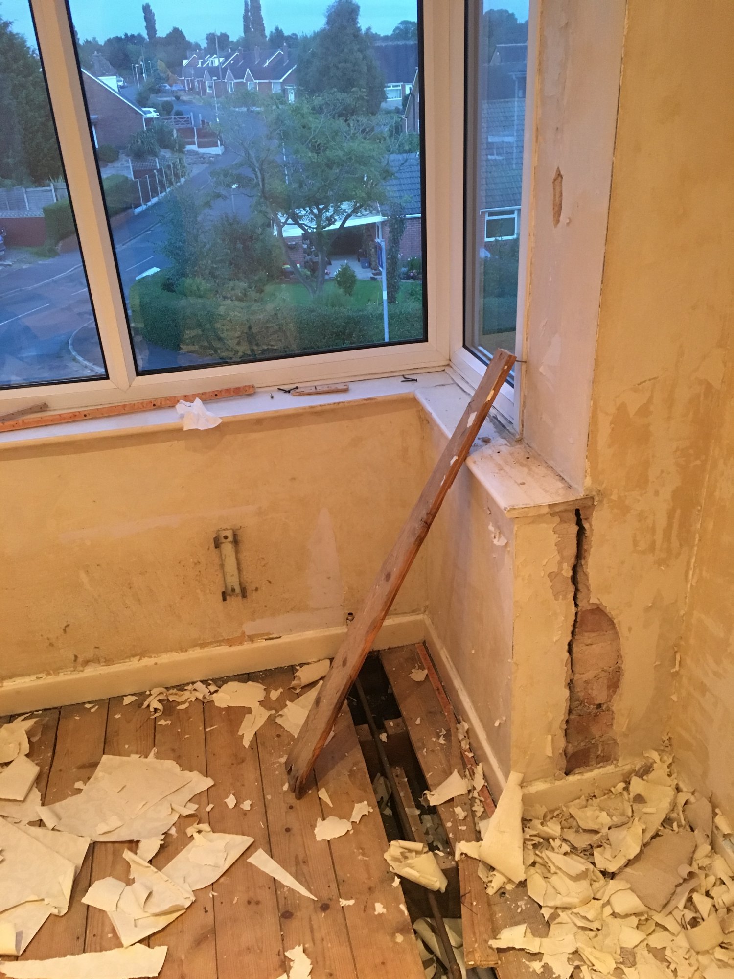

Upon stripping the wallpaper in the bedroom I noticed a lot of filler had been used on the bay window walls, it was caulk type filler. I cut this out and it has revealed a rather large crack, about 2 cm wide running from the window cill to floor boards gradually getting narrower.
It looks like the internal brick wall is coming away from the external if that makes sense?

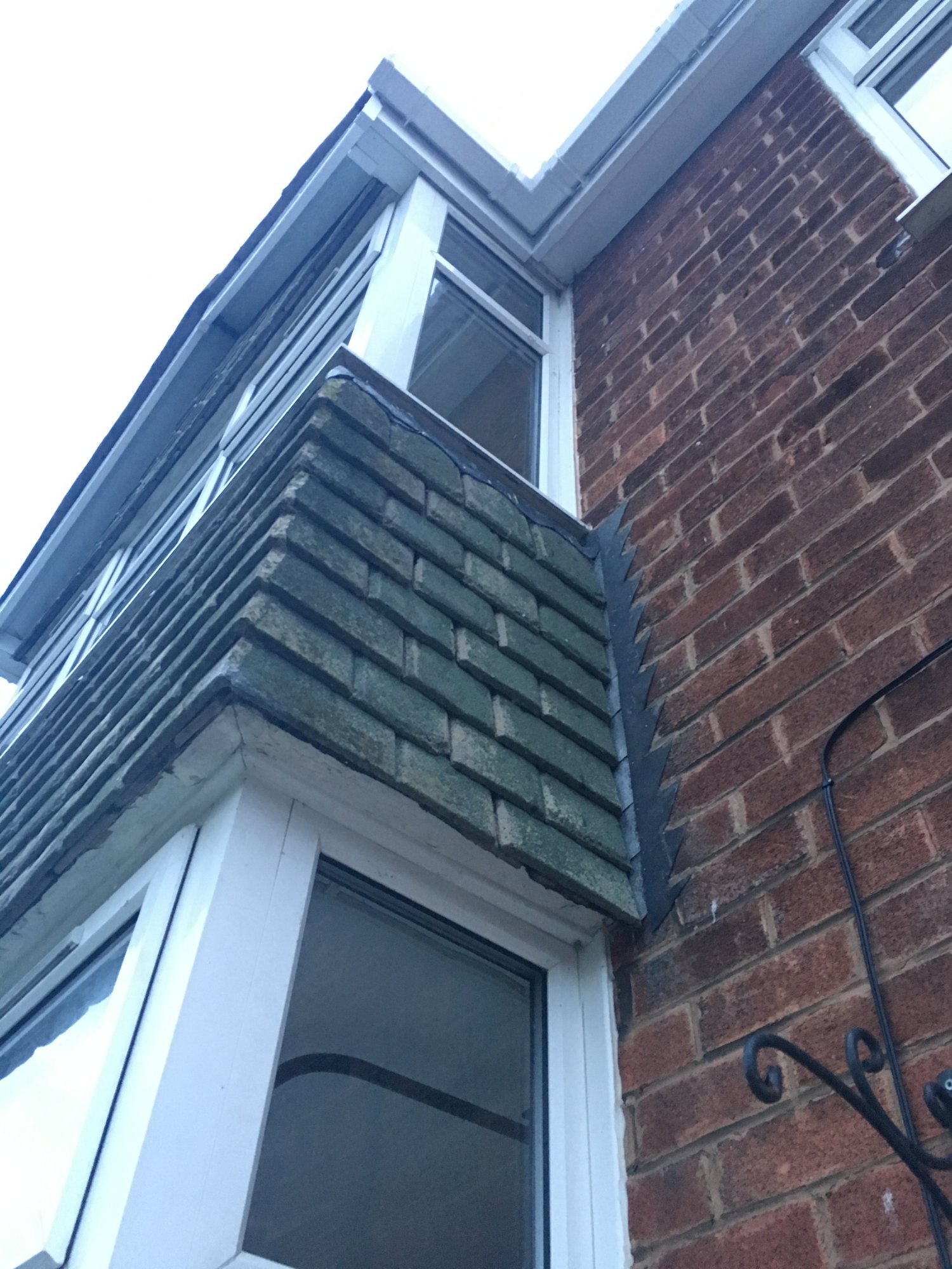

Can anyone advise on what I should do? I can't see any cracking from the outside but I will double check this.
Can the internal wall be tied back to the external? Can I just fill with mortar once tied back?

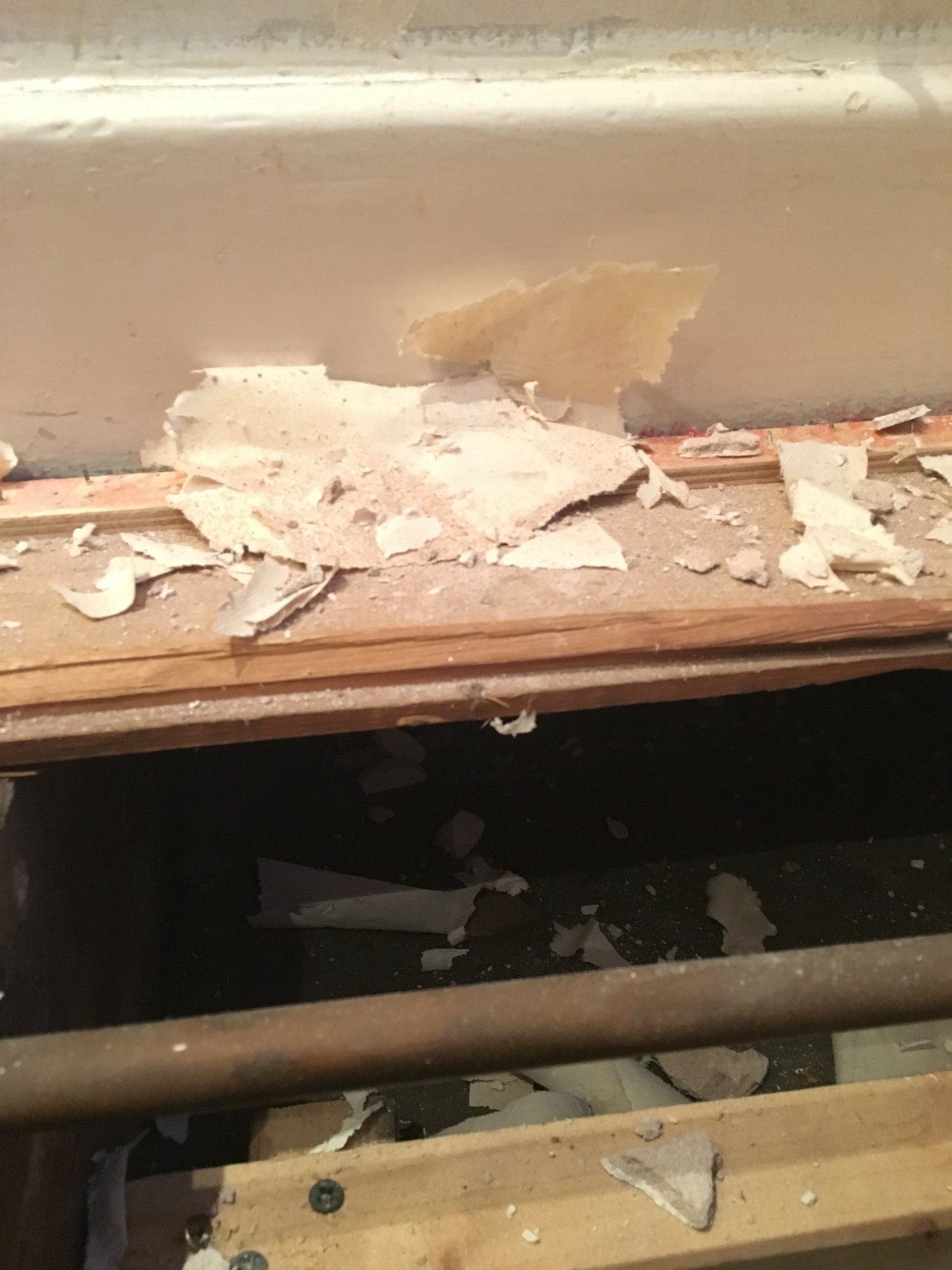

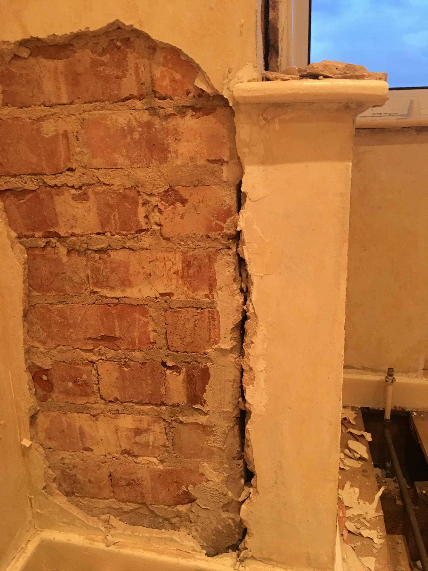

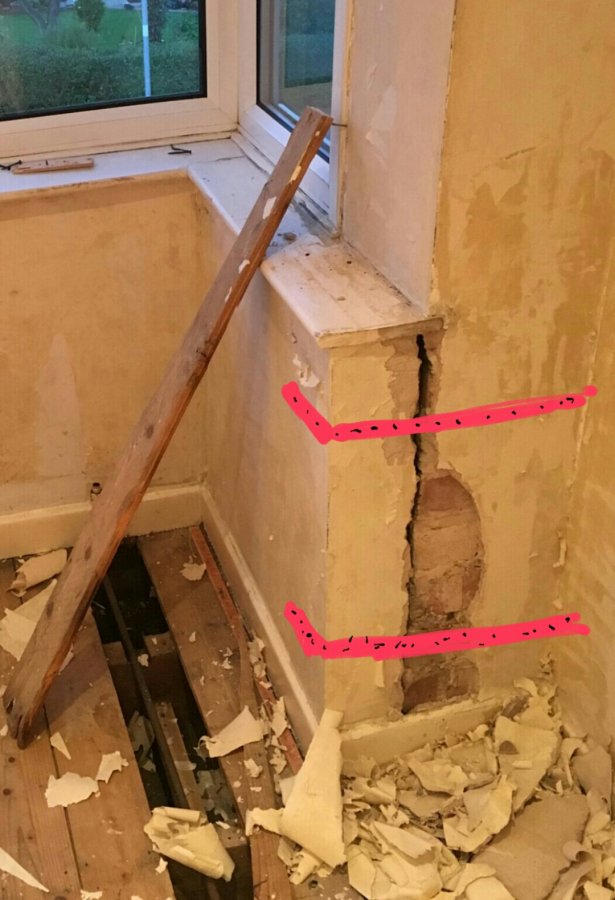

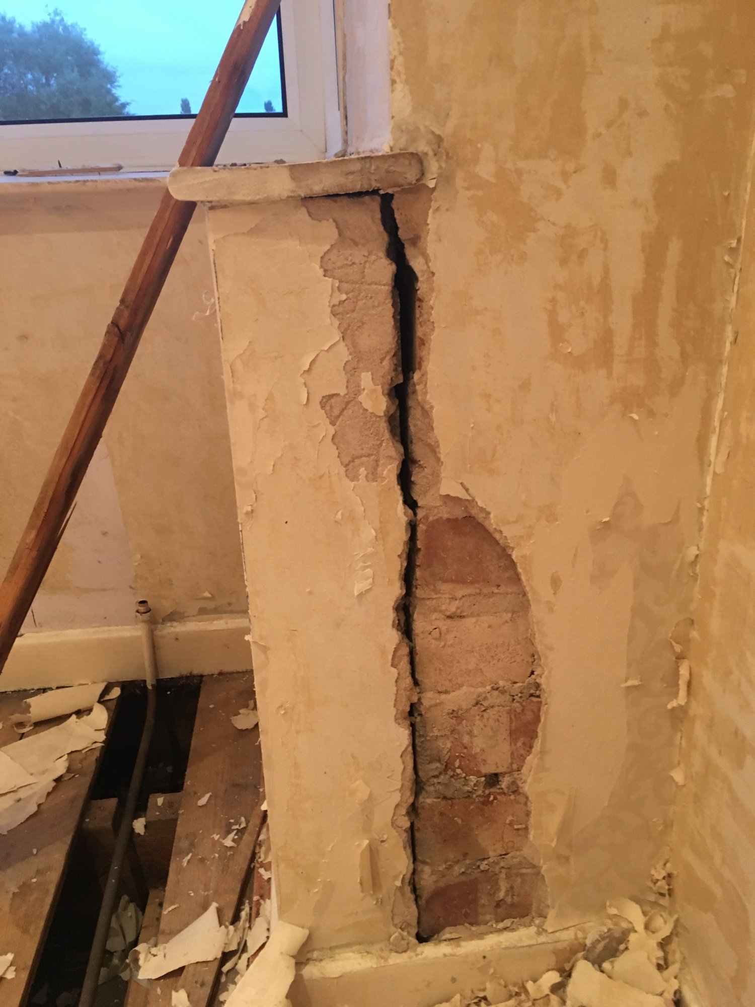

Here's some pictures. So it looks like it's an inner brick skin resting on the joists?!
It seems to be completely separate from the main house walls? Looking under the floor boards the brick doesn't continue - see photos. The whole skin can be moved fairly easy!
It seems to be tied with some sort of steel wire? Has anyone come across this before? The outside looks fine?
Can I simply fill the crack or should the brick not even be there?! Does it need the steel wire replacing to bring the wall level again?
Sorry for all the questions just worried!
Cheers
Andy
If the inner skin is sound, then you could hack out the plaster and screw straps to it.
For that cracked window reveal, is not a structural issue, but you have the outside wall on the inside, despite there being a DPC there. You need to line it with a DPC or membrane and best to add some insulation too before plasterboarding.
Thanks for taking the time to edit that! You have somewhat put my mind at ease now!
Makes sense to me now. I'm glad its not structural! Not convinced the bricks are in the best condition, downstairs they are loose and I suspect the same upstairs.
So line the reveal with DPC of some sort and the insulate that whole wall / reveal / bay with knauf plasterboard or similar?
