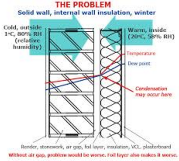

Indeed you can't perfectly seal, but you can improve things. As with most things to do with moisture, you either want it to be able to dry faster than it gets wet on average, or you want to have a drained cavity to outside (ventilated too if there is timber in there).
The thicker the insulation, the worse if the permeability is lower towards the outside.
Example: the wall and insulation have equal value, but the wall is impermeable and the insulation is wool.
Indoor temp 20c, outdoor 0c.
The surface of the wall will be 10c, so you might get condensation.
New example, the insulation is 9x as good as it was.
The surface of the wall is now 2c, so you're pretty much guaranteed to get condensation.
Improve the vapour control layer and you reduce the risk.
You can take sections through the wall and draw graphs of humidity against temperature if you're really inclined - sorry about the size
Here's one we did earlier....

Thanks John - I called Celotex, but they have no charts for heat loss through their PIR, a chart would have been interesting to do.
Will need to look at your diagram a bit more - still don't understand that by increasing the insulation thickness (and therefore reducing the temp. on the face of the PIR) you get more condensation - assuming a sound VCL.
Does this not help keep the temp in the air gap lower, and outward face of the PIR lower - I thought condensation occurred when a colder moisture laden body of air comes into contact with a warmer surface (or air front - hence we then get rain).
Noseall - Celotex suggested the additional 50mm layer over the top - as you have done, so you have gone for two layers of PIR (75 and 50mm), and tried as best to form an impervious Vapour Layer.
I will assume yoo only have 25mm gap ?
You have no air venting for this void ?
I have plaster over the brick work, guess that should be stripped off as it would just act as a sponge, drawing moisture in.
Assuming a perfect vapour seal on the inside, there won't be a problem, but that's a big assumption.
And condensation occurs when warmer air hits a surface colder than it's dew point. So your bathroom window when you have a hot shower for example.
