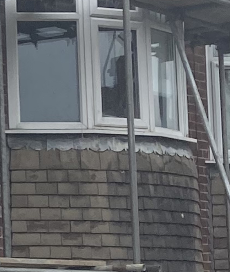

Hi all,
I need your help. We are looking to getting our front bay tiles replaced and re-sealed etc.. Some leaks in the past and want to make it right.
We have been quoted £1500 to do this. Is this correct? It seems excessive but I am a complete novice.
thanks
I've found bay windows very shoddily made, with a light wooden frame supporting plaster on the inside and tiles on the outside. So uninsulated, draughty, and full of spiders.
I'd want to include a roofer's membrane under the tiles
I'd prefer sarking board
then 100mm or more of insulation
then your plaster.
