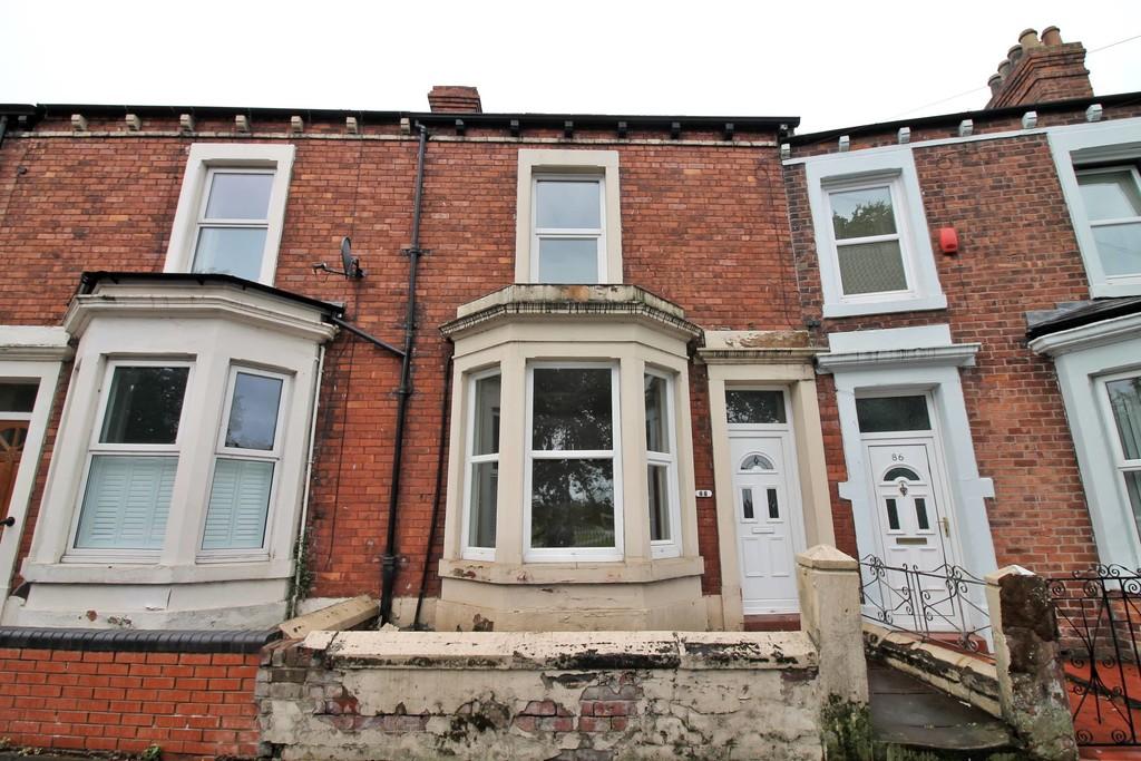

Hi,
The single story bay window on my Victorian terraced house is beginning to tilt away from the front wall. Neighbours have said that the soakaway for the downpipe that is within a few feet of the bay window is the likely cause and that others have added an extension to the down pipe so the water is taken to the front of the small forecourt and away from the house.
Does this explanation sound feasible?

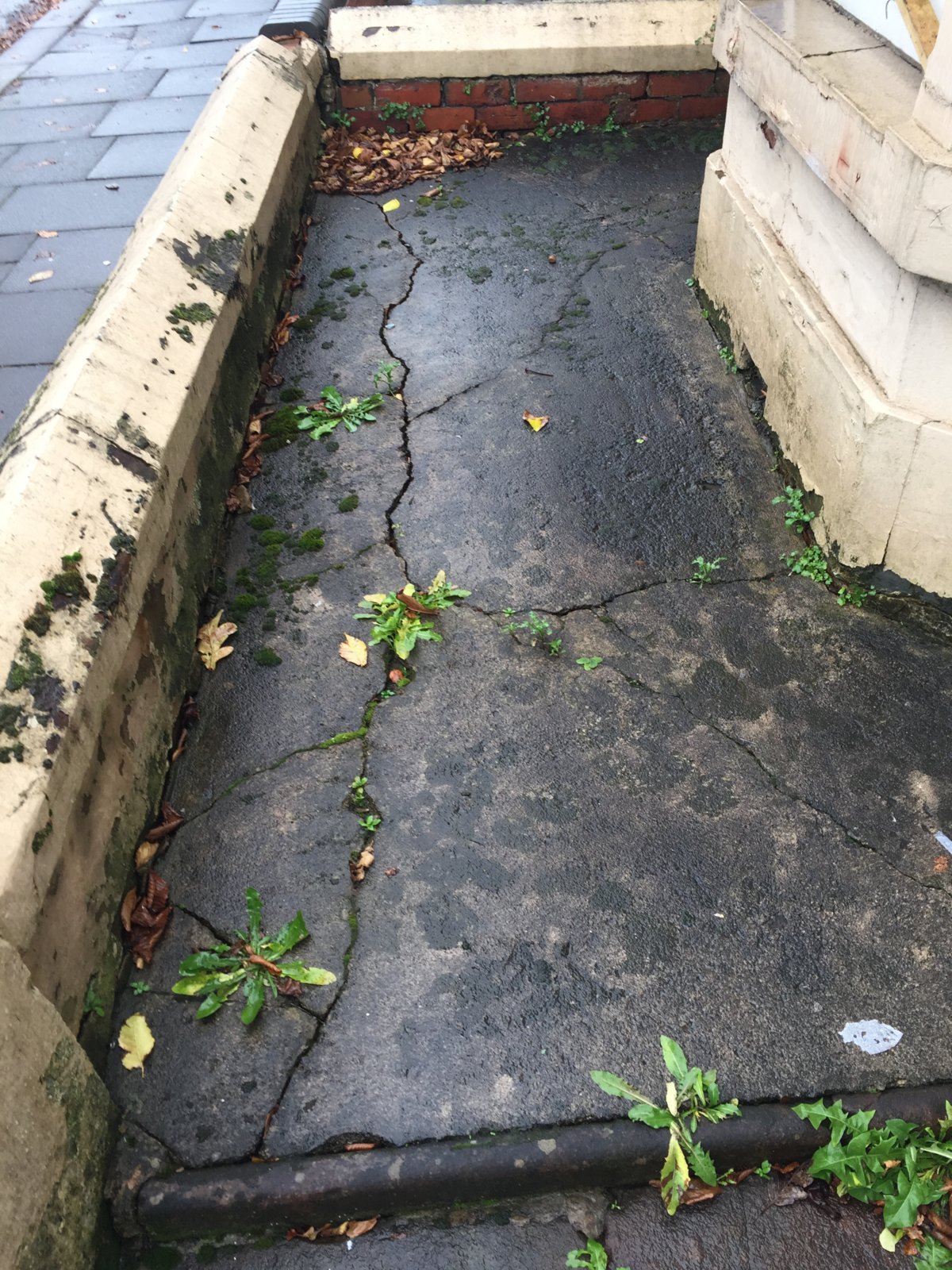

If the soakaway has washed soil from under the bay window foundation then should I replace the concrete covering the forecourt with a permeable paving solution so that rain water can gently wash soil back into where the soakaway has washed it away?

you need to plan the future arrangements for water disposal before attempting anything with the bay itself.
your, far too small, discharge pipe from the bay roof has been dropped independently, it should have been tied into the old CI down pipe like your neighbour has tied into it.
attempting to sump the discharge water anywhere in your little forecourt will probably undermine either the garden walls or the bay - some householder's pipe the discharge to the front garden wall and tunnel through the garden wall just above pavement height to discharge over the pavement.
neither the Council nor the Highway authority approve of such arrangements but they were often used in the past.

plus a shot of the small forecourt?
above the main elevation opening for your bay there is a wood lintel called a Bressummer beam - check it for level and any obvious damage.
there are a number of obvious other issues in your photo but for now - the bay.

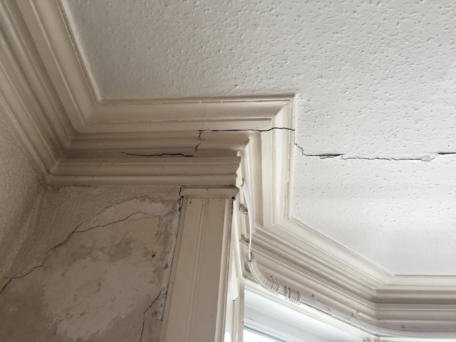

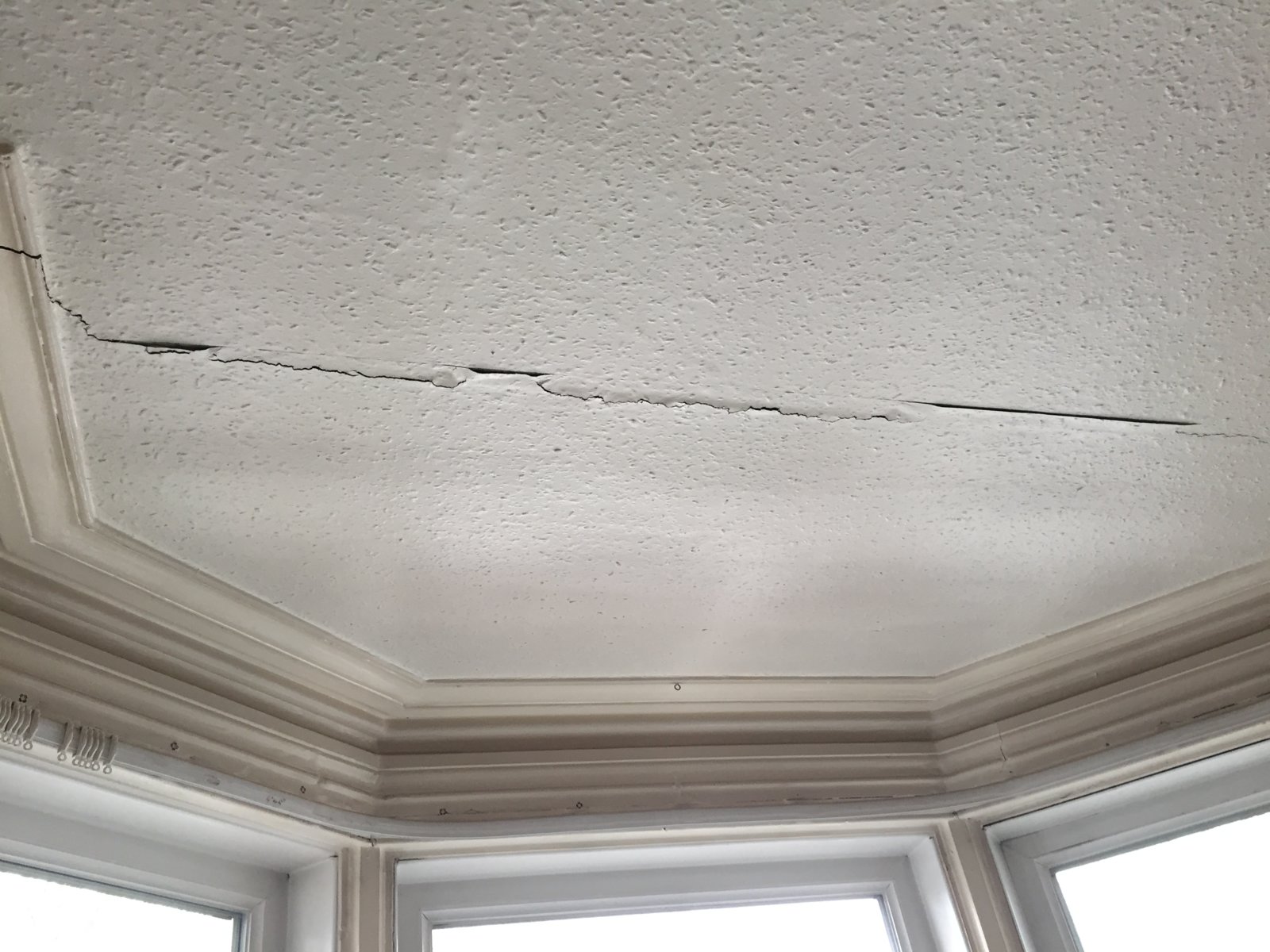

I am away for a few weeks but have some pics on my phone. Unfortunately none show the gap outside at the top which is about half an inch on the drain pipe side and it has pulled the lead flashing out of the brickwork there, but it is only a small crack at the other side.

the crack in the ceiling is the position of the Bressumer beam.
even if the timber beam is not water damaged its now possibly being exposed to decay.
a SE will have to make the calls on your bay - worst case will involve propping and pinning, and a re-build of the bay and any affected abutting walls - the floor will also have been disturbed (fwiw: there's probably existing damp problems in the lower panels and flooring).

re-build is a "worst case" not a first case - you have three large openings and very little brickwork in your front elevation.
check out which way your floor joists run on both levels?
check if any knock-throughs have previously taken place in the property?
notice you are on a slight forward slope?
i'm surprised you dont have a cellar.
its possible that your Victorian bay has Differential Settlement besides the other difficulties.

That concrete surface on your front yard- is it a thin skin above the original (probably) glazed blocks or earth or is it a proper 4" slab? How much traffic is there on that road, have the council put speed humps in?

It is possible that your bay was chucked on to the house well after it was built (there a quite big differences between it & your neighbours)- if that's the case you may well find there are no foundations (or very puny foundations) & that's why it is moving (don't ask me how I know this). Any plaster cracking or other evidence of movement in the room above the bay?
Given the structure of the thing (lots of solid stone) you might be able to use micropiles- loads easier and less intrusive than digging out and throwing cubes of concrete at the job. Would agree that getting a structural engineer to have a look (ideally a local one familiar with local ground conditions) would be a good investment.
"That concrete surface on your front yard- is it a thin skin above the original (probably) glazed blocks or earth or is it a proper 4" slab?"
I haven't looked closely but it looks like there is only soil below and probably only a few inches thick.

the concrete forecourt is a 40mm-50mm skim. remove all the concrete.

inside - open up the ceiling following the crack line - its possibly plaster laths.
open up back to brick the cracked LH wall panel shown in your pic.
