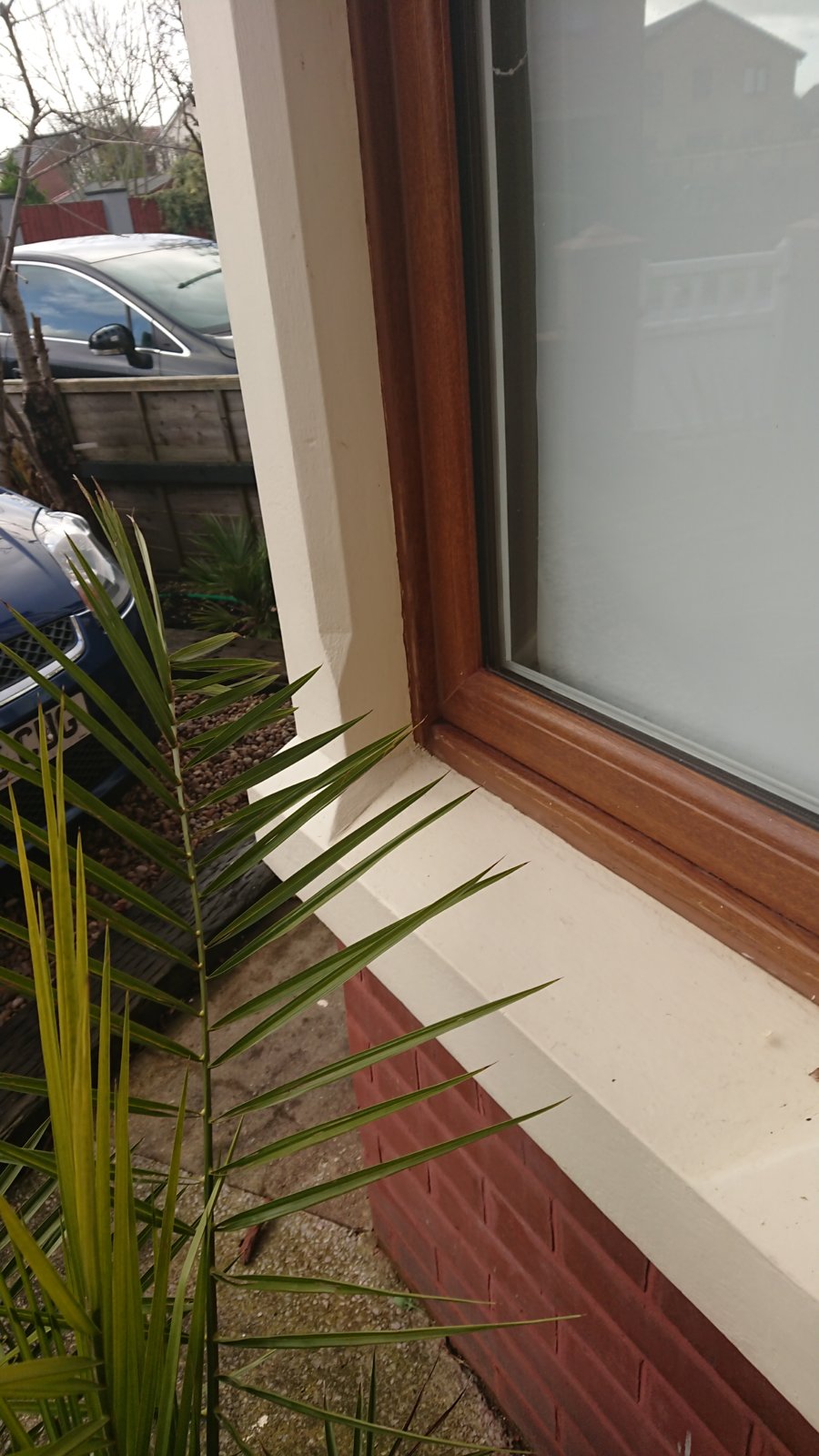

If they were originally sliding sash windows then theres 2 ways how the replacement upvc windows could be fitted, either within the original sash 'box' frame, or a full rip out, the first way is quick, easy, cheaper and way way way less mess and damage to decor, the second is removing every last timber bit of the window back to brick, that includes about 100 years worth of dust, birds nests, wasps nests and any other type of nest, will involve a boat load of replastering, new windowboards, new reveal linings......but its the proper and only way in my book, fitting a new window within the old timber frame means painting is still required and it leaves voids within the boxes where the weights are which could let the cold and noise through, will need some pics from outside to see if they've been fitted within the box or if its a full rip out

There are no original parts of wood frames left.
The original wood cill is visible under a upvc cill.
The windows were already fitted in the house when I brought it 11 years ago.
I am planning to redecorate the living room and front bedroom which have the bays next year, so not really bothered about any mess or how far I go with insulation.

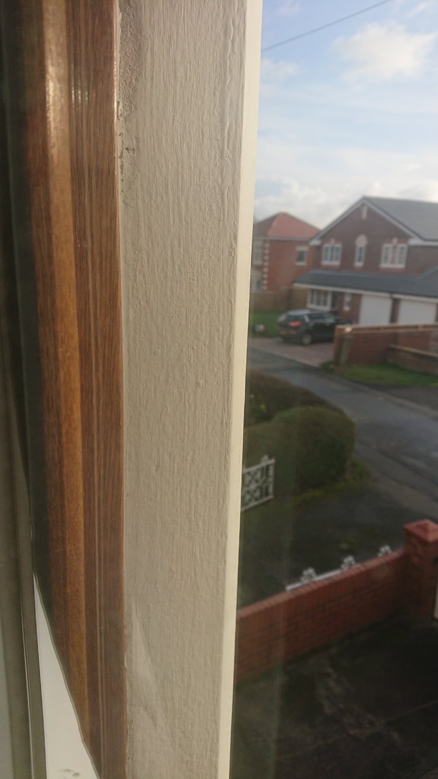

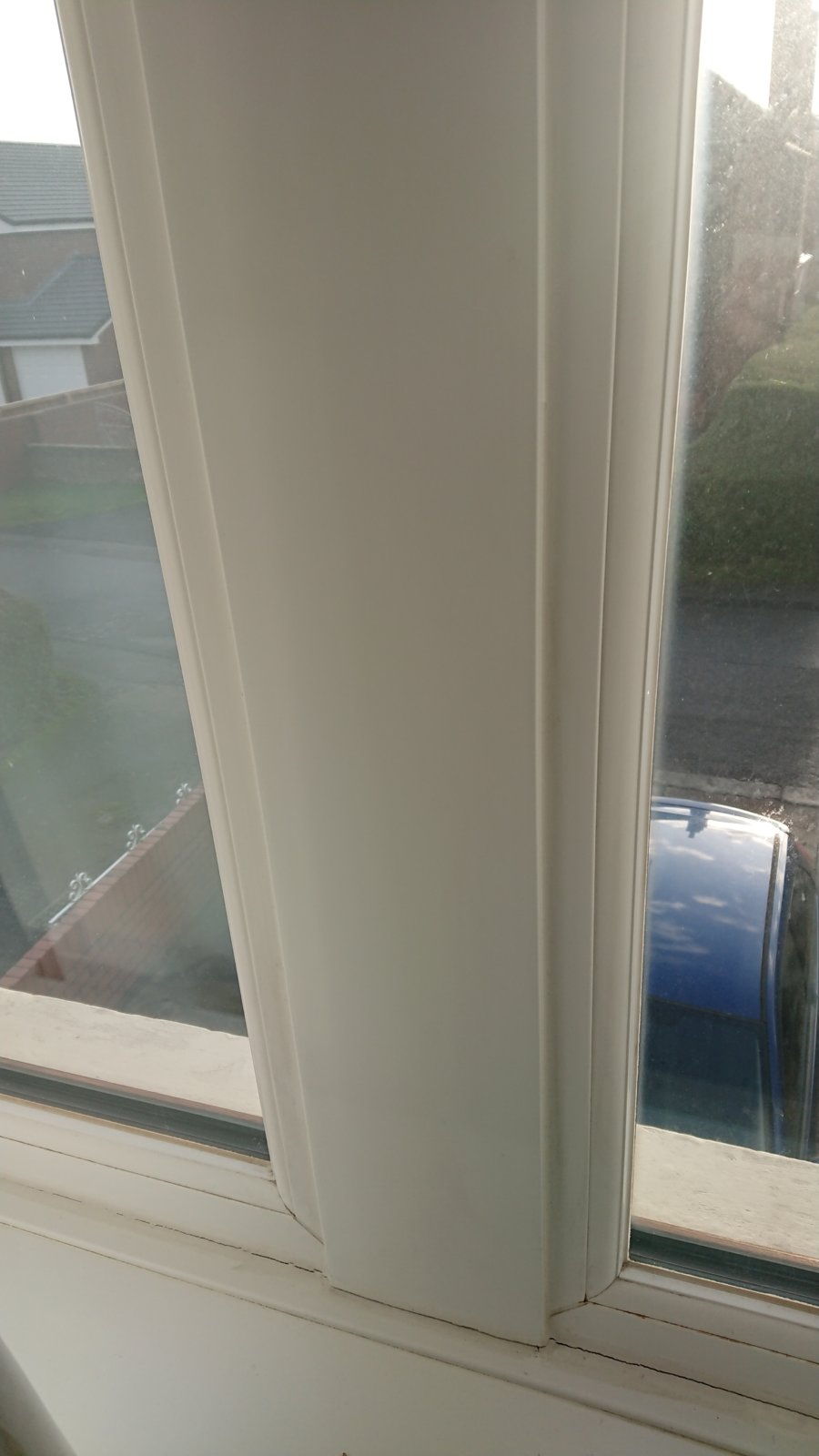

On the inside of the mullions between the windows there is a upvc trim which is about 200mm wide running vertically top to bottom.
I really want to carefully remove it and see what's behind, any foam, fixings.
I will post some photos tomorrow.
Cheers.
He's some photos,
