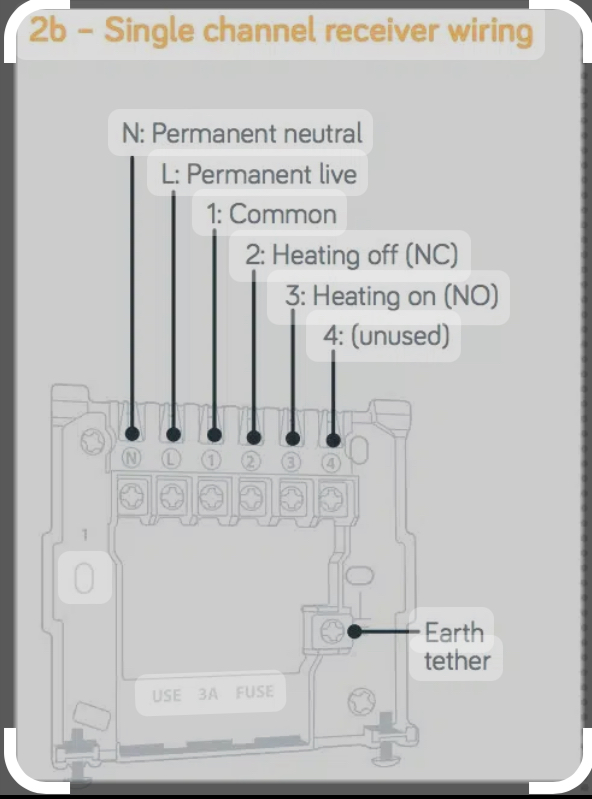

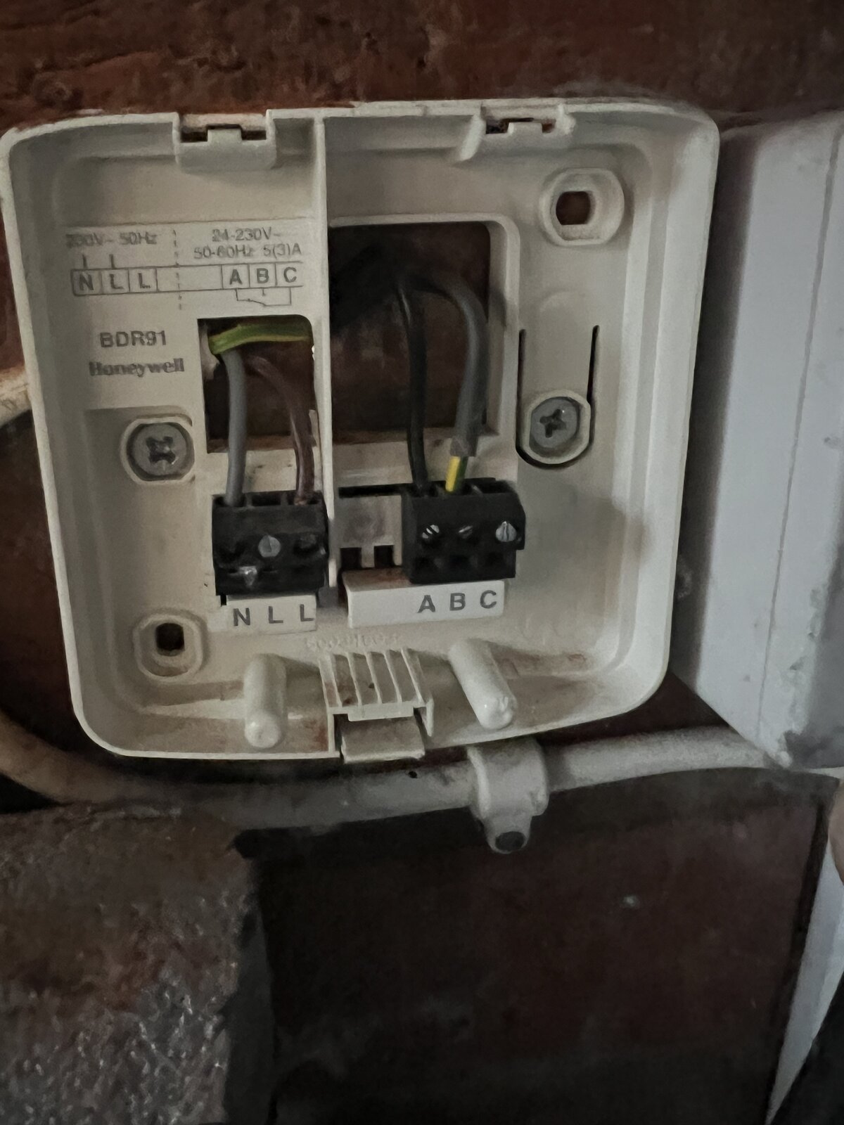

I’m wanting to switch out my current BDR91 receiver unit for a Hive receiver.
This is my current wiring set up in the BDR91
And I am unsure of how the wiring configuration will transfer to the new Hive unit
Please advise
Thank you
L to L
N to N
A to 1
B to 3
The earth/cpc has been used incorrectly but is sleeved.

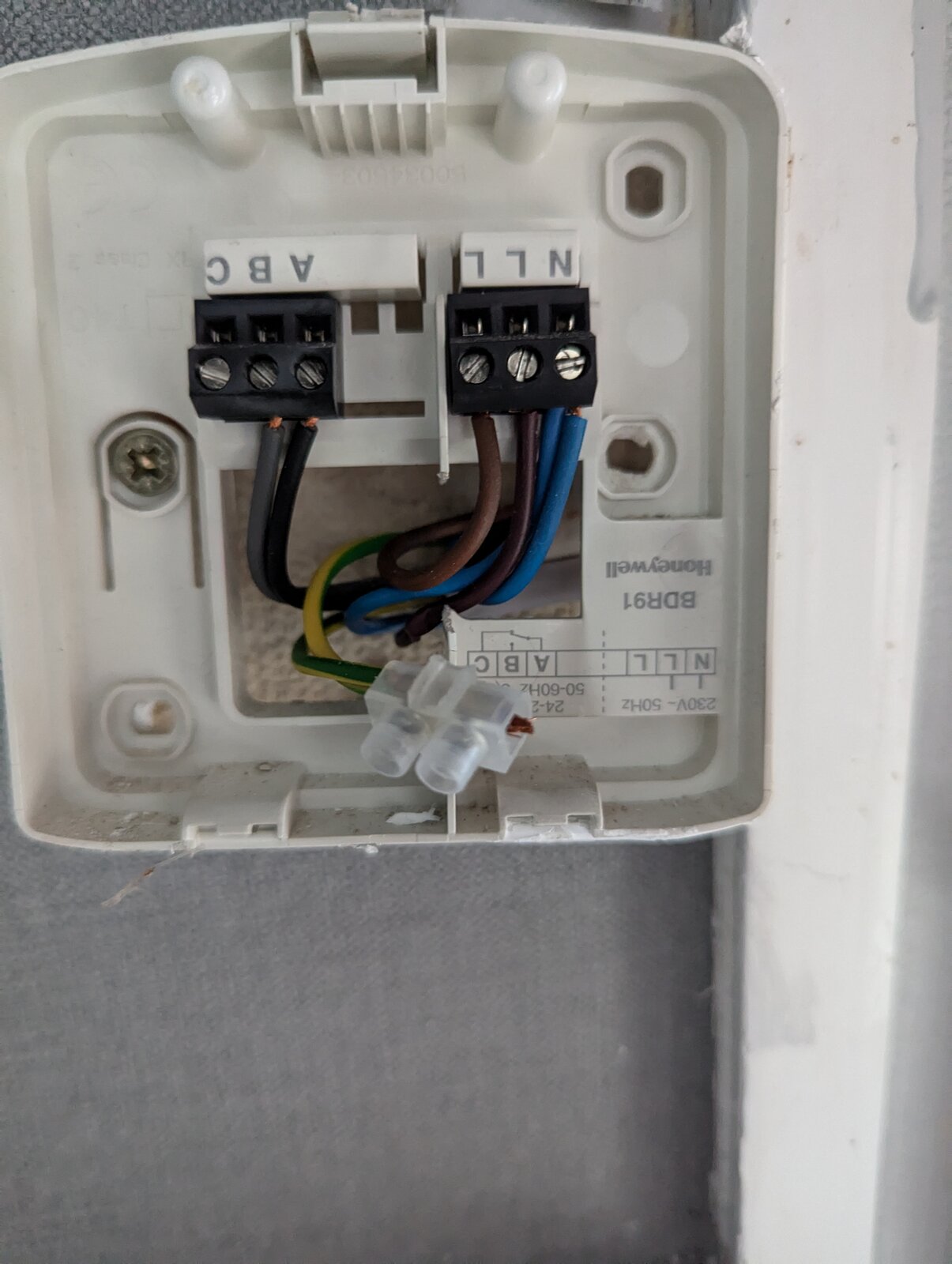

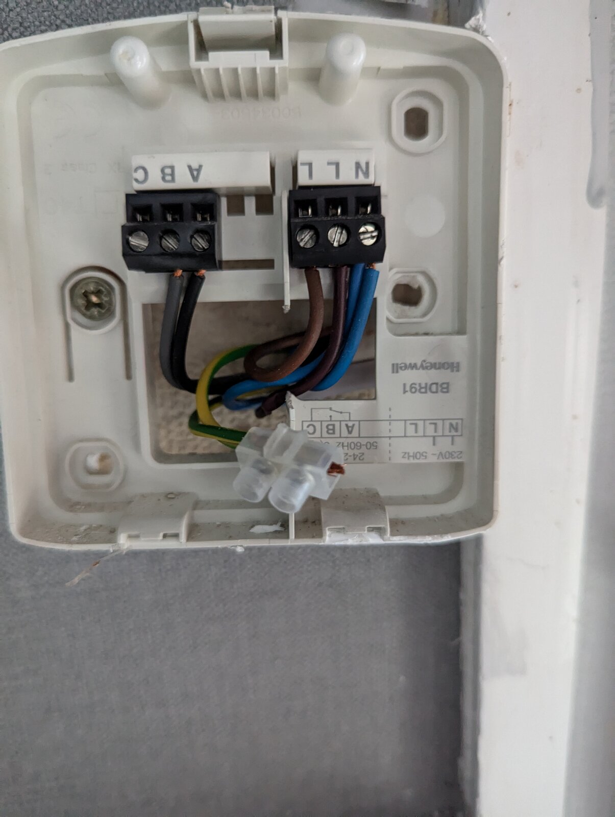

Hi, I have a similar issue , only I have 2 Live wires, one connected to the reset switch, where would I put the second live in the hive receiver?
put both lives in the same terminal. there is link in the bdr unit that just creates 2 live terminals to make life easier
