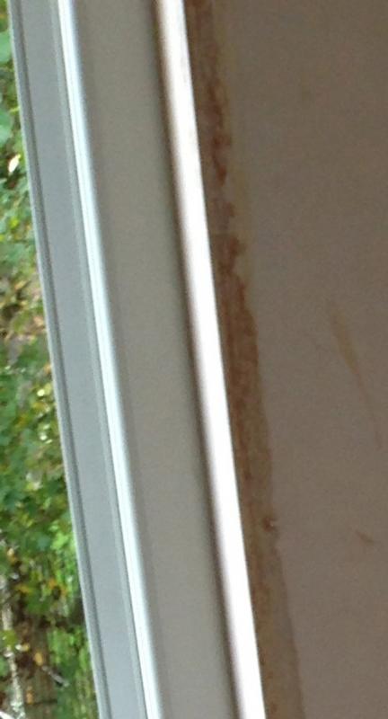

Thought a couple of images might help explain the issues, sure you guys come across this on a daily basis:
So here is a shot of the corner 4 weeks after being skimmed

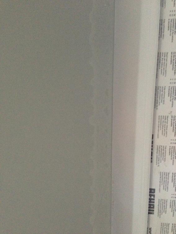

I applied a mist coat, then once dry applied my first coat of dulux matt emulsion and 12hrs later this is what it looks like:

In the first pic the edge was not dry eneough to paint in my view.
But as you have painted just go ahead as I said, option 1 in your list. The worst that will happen is a bit of flaking on the edge at some point.
Painting with oil based will not help it to dry out.
As footprints says it wasn't dry before you painted it, plaster around windows and doors always takes longer.
Very bad idea to put anything oil based onto wet plaster as you will get saponification which is a soapy leaching through the plaster, glad you didn't do that. You need to apply a stain block to the area as its highly likely you'll get a water stain coming through your finish coat.
None of this has got anything to do with your plasterer.

you know that was my first thought but I checked every few days to see if the darker areas were contracting however they seemed to stay the same size, in the end I left it just under 5 weeks before painting but maybe the pressure to get in got the better of me :(
@dcdec
Bugger, I should have been more patient! Is there a particular stain stop I should go for? Will it be ok to just apply it to the areas in question then two coats of emulsion over the top?
As dcdec says you may get water staining but if you want just try painting with the emulsion and see, you can always use stain block later if needed.
I would go for zinsser bullseye 123 if you want to use it as that is water based rather than solvent.

Use cheapo oil undercoat. Never fails.
So two coats of tinted Zinsser and it was looking good, another coat of emulsion and I can still see faint marks... Reading more online it actually seems like the marks are more likely due to PVA residue rather than water marks.
I've had tons of rooms skimmed over the years and never painted before it's dry and I believe this time was no exception, I checked daily and waited nearly 5 weeks and the marks didn't get smaller. Seems like the only option like Joe-90 said is to use a cheap oil based undercoat to give the emulsion something to stick to...
