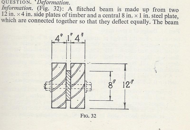

Have you thought of using a flitched beam, in which a thin steel plate is sandwiched between 2 timmber beams> The principle is that the steel carries most of the stress, while the timbers prevent it from buckling. If you know of a local SE who will be up to speed on your loadings /permissible stesses etc, it is fairly straightforward to size these.
Example pic from a structures book;

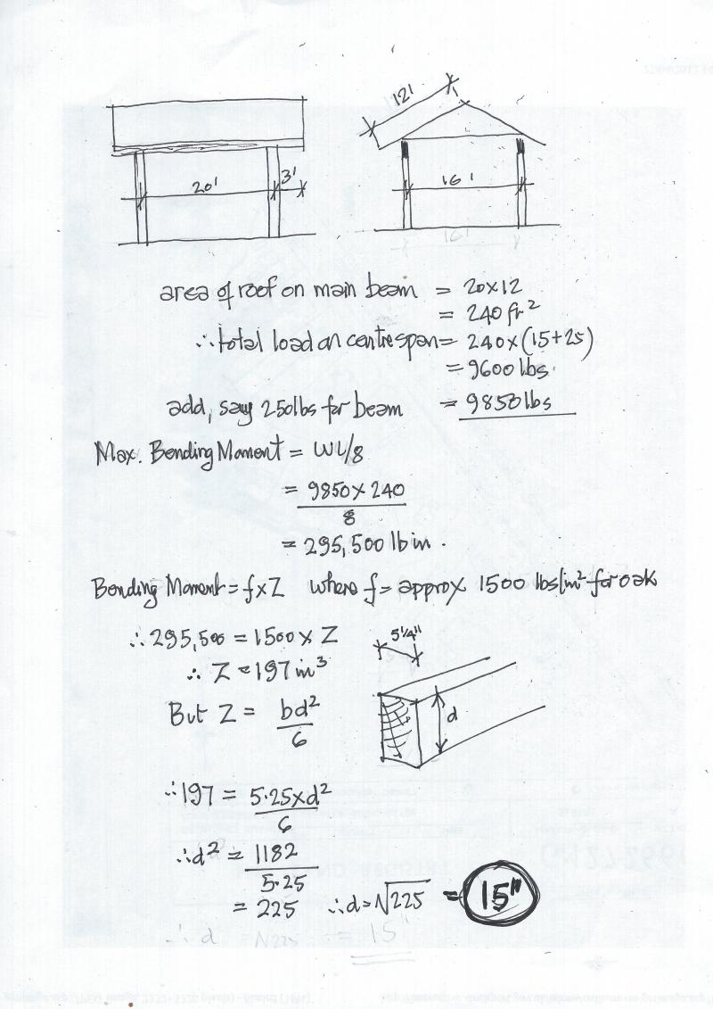

I have any number of large red oak trees on my property. If I cut a solid red oak beam that was 26 feet long and 5-1/5 inches wide how tall would it have to be to carry a snow load of 25 PSF and 15 PSF static load with a 20 foot span and 3 foot cantilevers.
