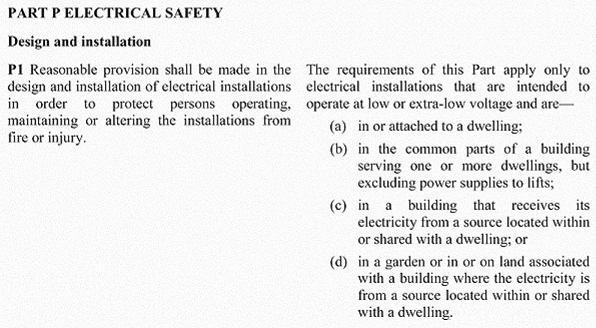

Part P is a Building Regulation. There are no courses on it.
That's it; there is no more.

thanks, yep I know part p is a building regulation, but for some reason the modules listed on the domestic installer course they label as part p.
so I was under the impression that I needed the 3, 18th edition, the part p qualification and inspection and testing to join a CPS.
