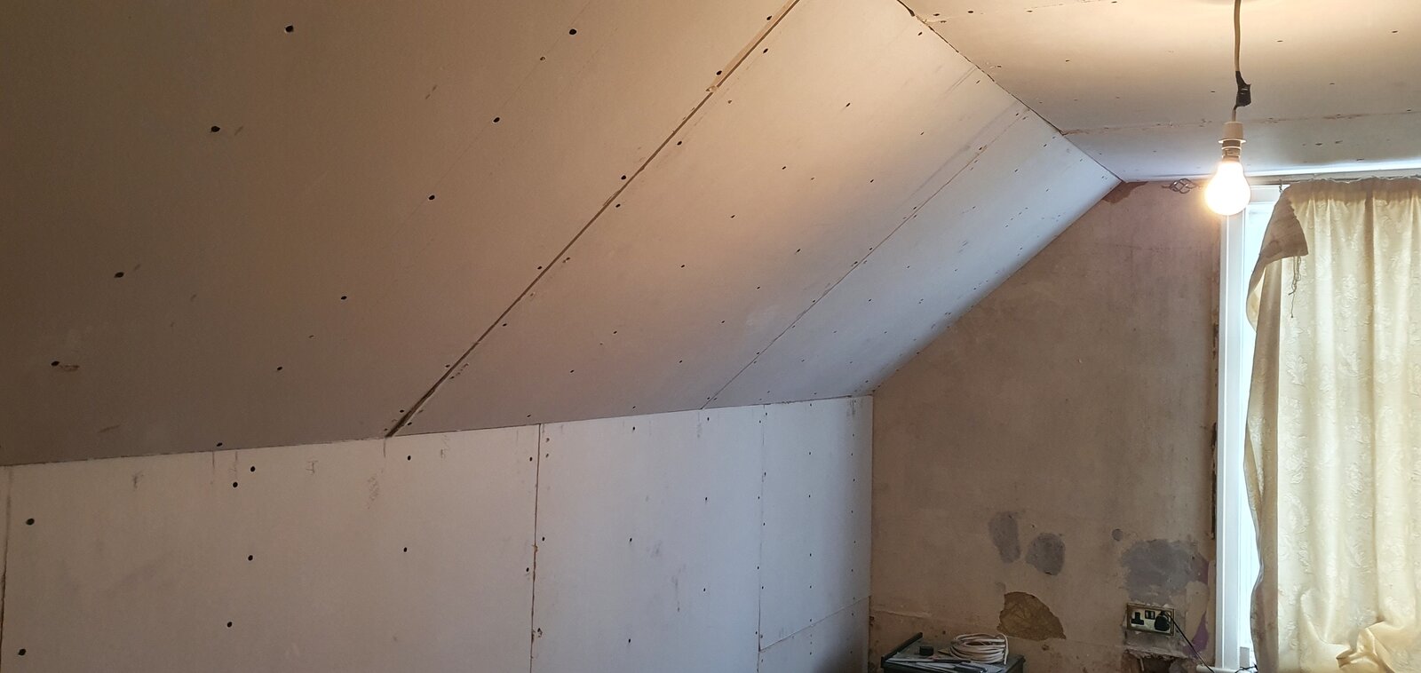

Hi everyone,
I have a 1930s chalet bungalow,. Cold drafty house, with issues. Expensive to heat!
Insulation:
1. it has cavity injected insulation.
2. Loft insulation ordinary type 100mm under loft boards and 400mm on none boarded areas, I realise I could put pir under boarded section to improve. I'm considering foil under rafters too to cut down radiant heat - old slate roof no membrane, realise may need vented ridge tiles.
3. I've just finished ground floor putting 100mm pir from crawl space upto floorboards with gaps spray foamed. Intending putting foil type underlay on top of floor boards too under carpets / laminate.

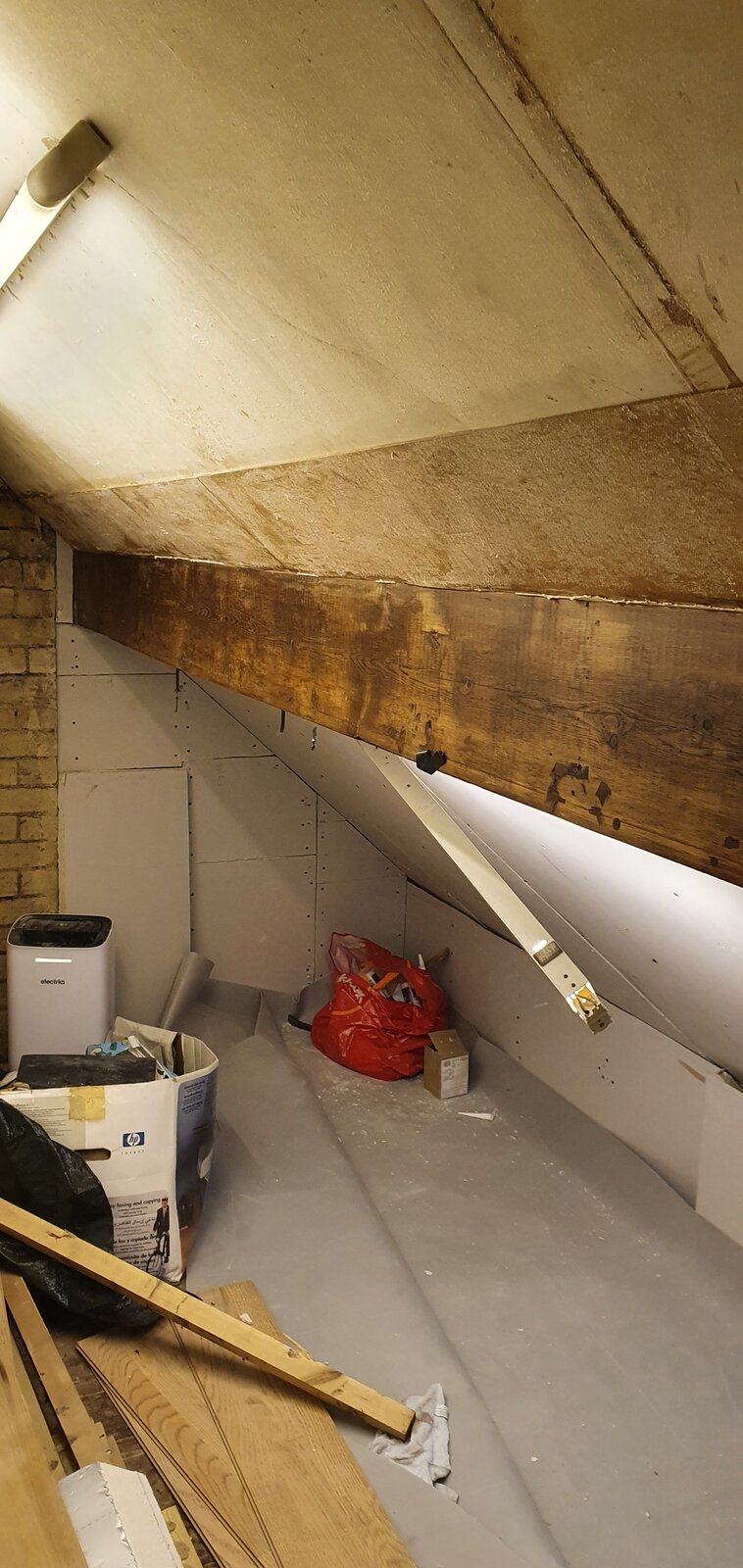

4. I've now started on my bedroom, if has a stud wall (insulated to back), sloping ceilings - no insulation, ceiling (insulated above this with 400mm loft insulation), then down sloping ceiling to almost floor level - none insulated (this area is used as storage behind wardrobes).
I've almost finished insulating all above with 72.5mm insulated plasterboard. See photos.
I'm considering fixing insulated plasterboard to the inside on the external wall ?? As mentioned it has injected cavity wall insulation already, I'm concerned if I don't do it now prior to plastering I'll regret it or could regret if I find it causes damp issues?? If I was to do it what thickness??

should I add pir insulated plasterboard.to inside of external walls
It's law of diminishing returns but I'd say a generally useful upgrade; you didn't say how big the cavity is, but 100mm of wool or bead insulation is vastly better than nothing but only worth about 50 ish mm of PIR (what you get on the back of plasterboard)
Look to resolve draughts too; no point putting insulation everywhere if you let cold air blow past it. Your Flor can come in handy for that; on a cold day, with the heating on if you can arrange for a high volume extract of the house air you'll find where the cold air gets sucked in
The maim question is should I also put insulated plasterboard on the inside of the external wall, if so what thickness, the cavity is 100mm with injected wool type.
I realise the generated moisture is an issue so considering new windows with trickle vents / using dehumidifier too.
Draughts much improved by recent under floorboards ground floor insulation. The under carpet foil im thinking of is more of an underlay with foil backing.

Aware could change dew point so need advice on applying internal insulated plasterboard to the inside, what type of pir ect, what thickness????
I put 50mm PIR on internal walls of my 1930s bungalow, no cavity wall. I don't know about U values, but it has massively improved the warmth and comfort. We never have the heating on at night, even when minus 5 outside. Floors were also insulated, and plenty stacked in the loft too.

..but in a normal house you might be more like "what can i sacrifice in terms of wall thickness, and how much do I want to spend on insulation etc" - you might only have a 100mm gap and you really want to get to 0.2 U so you're putting 100mm of kingspan in there. You might be aiming for 0.15 and have loads of space so 300mm of wool it is, and it's the same price as kingspan
If you get the walls U low enough that the waste heat from all your household appliances, your body, and things like sunlight streaming in through the window, covers the heat loss then you don't need to run the heating - that's a passivhaus but they're designed to the finest deail and constructed with a percision like nothing else. It's huge work to get a 1930s anything to that, so most people settle for leaps and bounds improvements that come with some reasonable amount of insulation and careful detailing. I'd use 100mm PIR
Yes, but favourably; it's easier to keep the house warmer, with less fuel. In general, strive to keep internal surfaces above 13 degrees, and also strive to minimise the amount of moisture you load into the air
