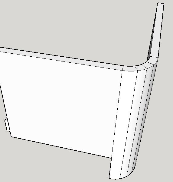

I want to make a bed frame out of MDF or MFC to match a headboard that I am also making but I am struggling with these corner pieces in the design (see attached image). I understand these are made from real beech wood for structural integrity and sprayed to match the melamine finish (Egger melamine) but no idea how to go about this. Is this a specialist job? The straight pieces seem ok but these corner pieces are quite difficult for me at least. If I go to a timber yard which has a cutting facility, what should I be asking them for? Is it even possible to get a real beech wood to match a melamine finish?
I know this image is primitive but please try to imagine straight pieces connecting at each end to make the right angle..
Thanks in advance for any advice...

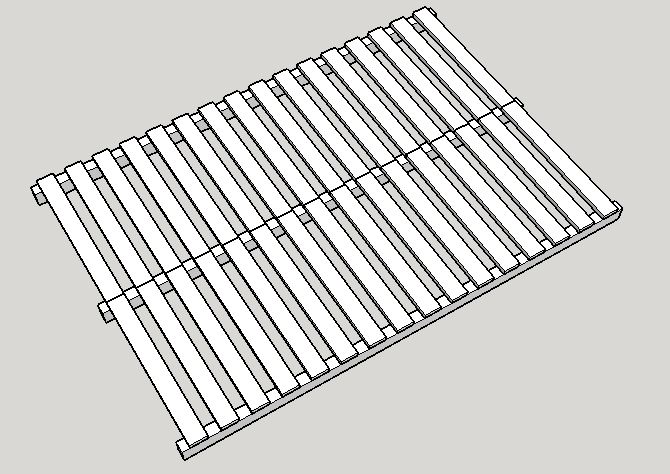

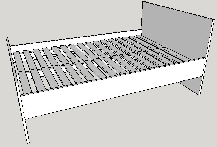

It is generally accepted that the best and cheapest way to support a matress whilst allowing it to "breathe" is to support it on unfinished softwood slats. Leaving the slats untreated seems to reduce any tendency to mark the matress as well as reducing any effects of moisture (e.g. potential mildew, etc). It is also the accepted approach that you cannot exceed about 1m in length for slats without experiencing support issues so your support would need to be, in effect, two slat frames supported down both sides of the bed with a central support:
Those support battens, at about 3 x 2in (70 x 44mm) give you a fair amount of strength and when connected to a bedhead and a toe board can form a substantial part of the bed structure:

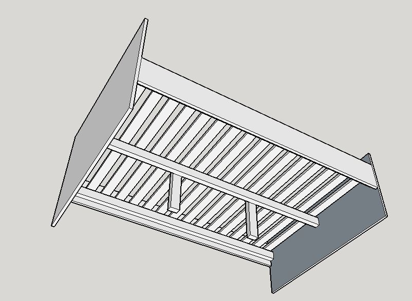

Unfortunately three 3 x 2 in softwood aren't quite rigid enough to carry the full weight of a matress and tw adults without flexing in the middle somewhat so a deeper side rail is needed to make the outer battens more rigid:
and to give extra support in the middle one or two vertical legs must be added (screwed) to the centre batten (viewed from beneath):
The issue is how to fix the structure together. The outer battens are simply glued and screwed to the insides of the outer rails. The rails are fixed to the bed head and toe board using simple steel bed connectors. There are a huge number of these around. but take a look here to get an idea of one approach. The softwood slats need to be connected together and constantly spaced - for this four lengths of 50mm furniture webbing are used and these are tacked or stapled to the underside of the matress slats from end to end and about 50 or 70 mm in fom the ends so that the slats can be rolled-up into a bundle if required. Lastly the centre (single) batten can be screwed to the bed head and toe board using 70mm angle plates (two at each end).

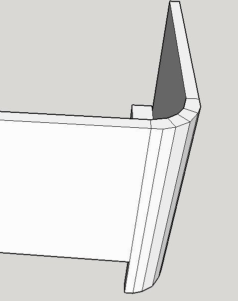

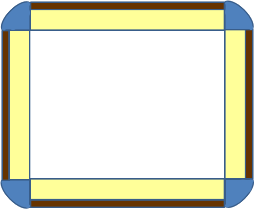

Thanks for your advice once again JaK and chappers. I have done a rudimentary design below but this is nothing compared to what you have drawn JaK -as an aside, how did you draw yours ?
Where the items in blue are the beech or equivalent pieces, the items in dark brown are 18mm MDF or MFC material that I want to match to a headboard and the light yellow is the softwood I will use to bolster the frame for structural integrity (not sure of the thickness of these as yet though).
As a concept, please can you advise if this would work bearing in mind what you have said above about the slats ? I forgot to mention that I am not looking for a headboard to be attached to this frame, all I am looking for is a bed base that can be wheeled in a out of a fixed wall headboard (hope that makes sense). If I use slats, is there a possibility of buying ready made slats in a metal frame unit which I can simply drop into this bed frame with the right support ? I was hoping I could buy something off the shelf for this purpose. As for the fixings on each quadrant, I was hoping to use something like this:
Would this work in your professional opinion ?

i use 4x1" planed [95x21mm] with a 55-70mm gap between slats slats rounded over
a bit off 2x1planed[44x21mm] down the center fixed top and bottom to tie them all in together underneath with 2 screws per plank
never ever make a bed base till you have the mattress as there is no such thing a mattress for every size
I was going to suggest a pre made slat system yes you can buy them off the shelf and they are altogether on a frame and pre sprung so no sagging. You can also buy just the slats pre sprung, otherwise known technically as bent

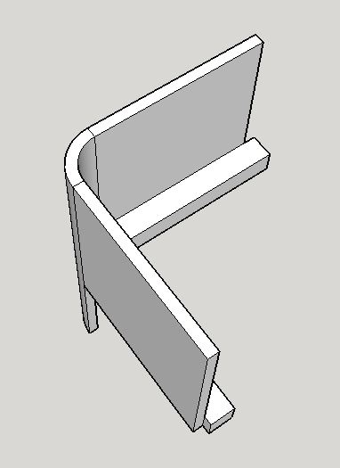

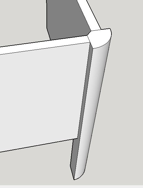

I'd say that looking at your design the blue corner pieces appear to be of massive cross section (something like 70 x 70mm section):
where the leg section itself will impinge into the matress area (matresses tend to have fairly square corners with a modest radius). In real terms this simply won't work becauze the matress will be able to slide all over the place. A possible solution is to make-up corner pieces with a radiused inside profile as well:
But this becomes a problem, too as you will then be dealing with a much more difficult component (to manufacture) as well as having the additional issue of short grain in the leg structure. A leg with short grain is likely to fail under heavy loading - think about the bed being dragges across the floor or being struck by a vacuum cleaner and you'll understand some of the things which can happen. The short grain issue can be overcome by coopering the corner piece (i.e. glueing several pieces od straight timber together which have been planed with appropriately-angled edge bevels:
These are then radiused using hand planes and a sander to give the appropriate radius:
This still leaves the issue of how to connect the structural softwood pieces and how to tie the legs into the corners. It also requires a fair degree of accuracy on your part and in view of the fact that you are considering putting out the making of the corners are you sure that you have the necessary skills and tool kit to achieve this?

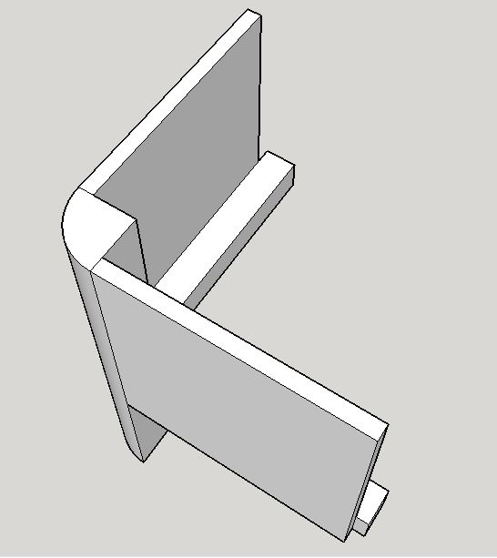

I wonder if a more "limited" design might not be more readily achieved? Something like this:
In this case I've taken a 44 x 44mm square section leg and radiused the outside and put a small chamfer on the inside edge. Simpler and far cheaper to makefrom one piece in the solid (don't underestimate the skill required to o a coopered joint)
Were I using solid beech for the corners then I'd look to make the main panels from beech veneered MDF rather than MF-MDF or MFC. That would allow me to utilise solid beech lipping to obtain a more "integrated" appearance (I also note that you haven't proffered a solution for the edges of your MFC or MF-MDF - both can have a razor sharp edge off the saw and so the issue of edging needs to be addressed)

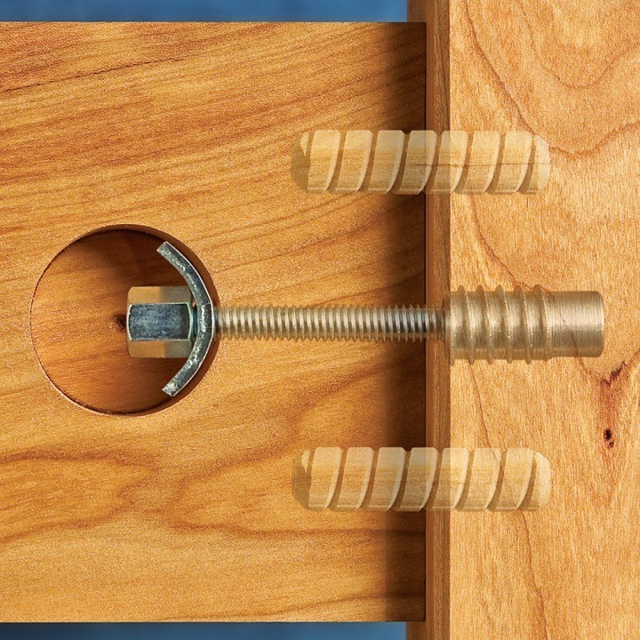

Your joints need to be strong enough to withstand this, especially as you intend to build a free-standing double-size unit.
I agree - does the bolt and dowel technique I posted in my previous post address the joints sufficiently ?

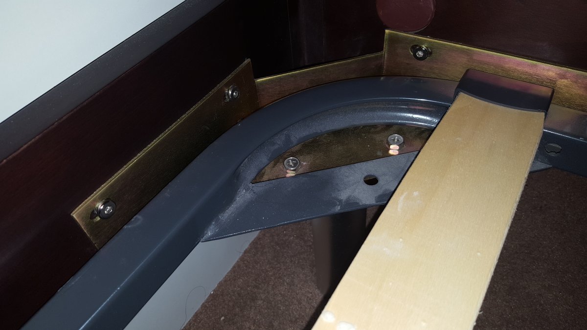

I think you are broadly correct except that I would be having another piece of softwood behind the MDF/MFC to bolster the frame (the yellow pieces in my previous post). If this is the case then presumably I would have right angled corners internally ? Would I still have the issue you mention above ?
Right angle corners internally would mean that the walls of the bed would need to be extremely thick. That carries a massive weight/bulk penalty.
Also I wanted to slightly move away from the traditional design where a leg goes from each corner to the floor as I think this would be vulnerable to damage
You are now getting into the realms of a "2-layer" frame assembly - which is again heavy and potentially complex because no bracket is going to offer a sufficiently rigid solution IMHO. You really need to consider this as a 3D solution - make a 1/10th cardboard model or the like to see why you can't do things. The brackets shown cannot support te side-stresses a bed can/will place on them. Tale a look at the bracing on a decent quality dining table and you can begin to understand what is required
Only if there is sufficient strength and thickness of tiumber in the corner components. It will be worthless for fixing the legs in place (no lateral strength) and it will probably be anappropriate for fixing an upper layer to a lower one
