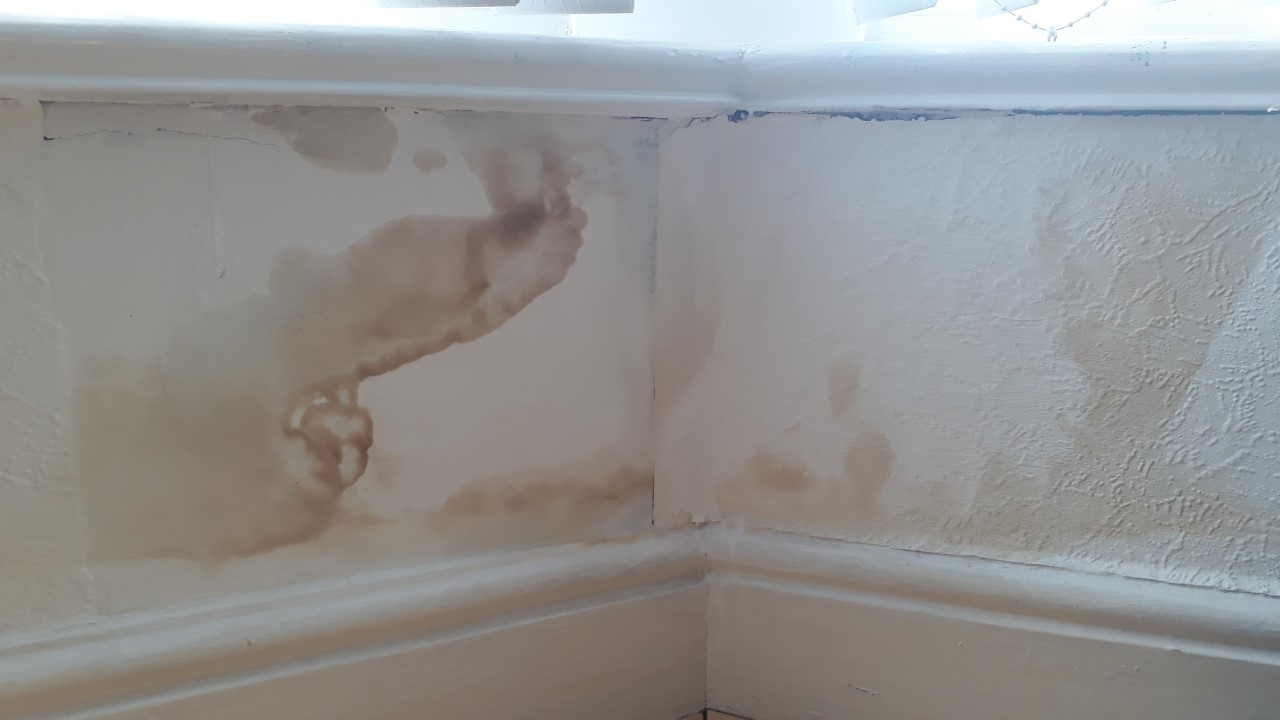

Hi,
I have had what appears to be either a penetrating damp and/or condensation problem in a bedroom bay wall. Pic below shows the worst section of staining but other areas of the bay also suffered from dampish wallpaper so I decided to remove all the plaster in this area (possibly foolishly).
The wall is solid brick (no cavity) and when I removed the wallpaper could see the worst section appeared to have been patch plastered. I'm presuming maybe if water has been coming in at this point it may be a recurring issue in the house.

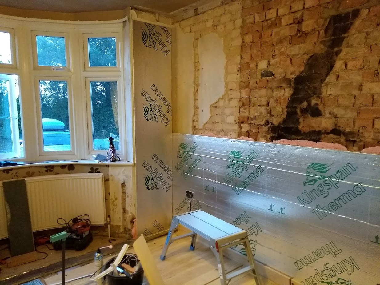

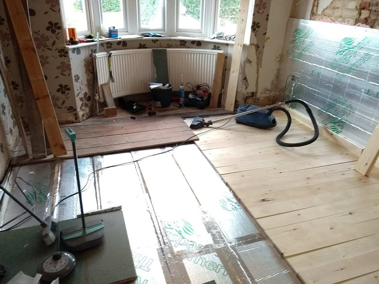

My 1930s bungalow - insulating ... note the Cillitbang black mould remover - sprayed that everywhere before covering with insulation!
floor
finished job
One year on and not a drop of mould.

I did have to insulate the bay.
So I did similar to keen:
- re pointed bricks with cement mortar
- Put in treated wood batons screwed to wall using Framing Screws (I used treated 25mm deep battens from wickes as I used 25mm PIR there as was linted on space.
- Note that for speed I put up battons by hand pushing them aganst wall, and drilling pilot hole straight through wood and into brick using a singe masonary drill bit, poping in framing screw and hitting it home with hammer (this is how you are supposed to screw in Frame Screws).
- Put PIR between each batten.
- Tape up all battens and PIR joints with metal tape
- Screw plasterboard onto battens.
I was luck as window cill over hang by ore than 25+12mm, so I did not have to change it.
