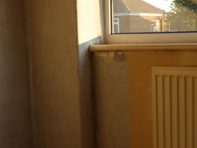

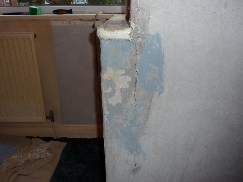

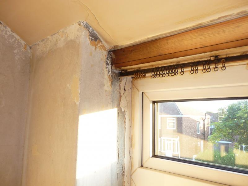

The bedroom has a box-shaped bay window, the wall below the window sounds hollow to the tap (plyboard/plasterboard?). When I pealed off the wallpaper around the corner leading into the bay it not only took chunks of plaster from the corner with it but I also discovered a huge verticle crack from skirting up to window sill.
If I nugde the sill the crack will either widen or close. Can this be repaired or am I just saving up woes for another day? If it's advisable to remove the section of wall and replace, if so how big a job is it and what's involved?

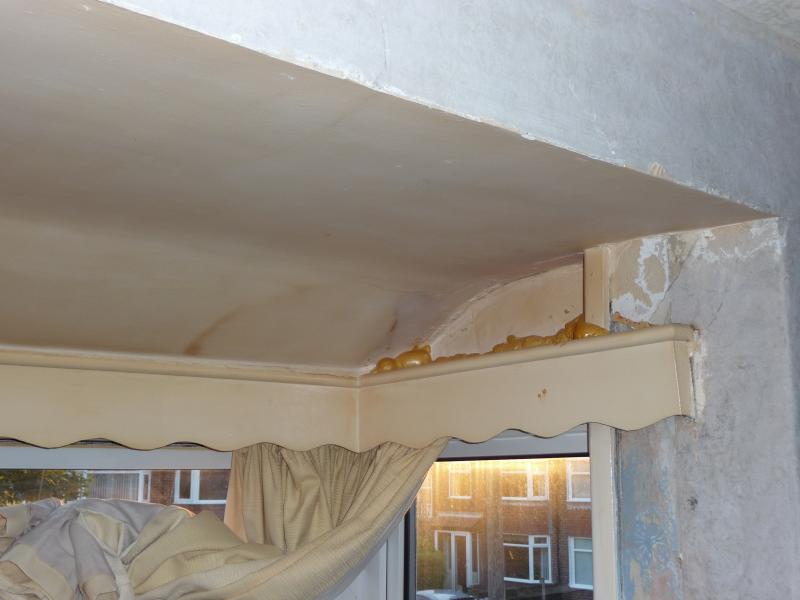

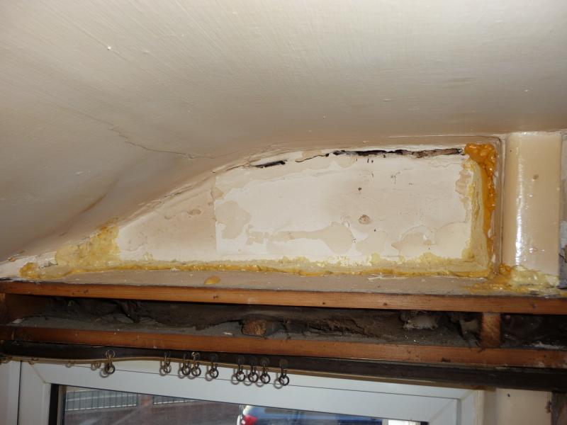

Above the side window the previous owners have had expanding foam used to seal what I presume was a leek at some point. From the outside it looks to just be plyboard (which is falling apart).
Whats the best path to getting that remedied - roofer to sort out the roof edging and then builder to replacing the plyboard and make good or is this something a builder can do?

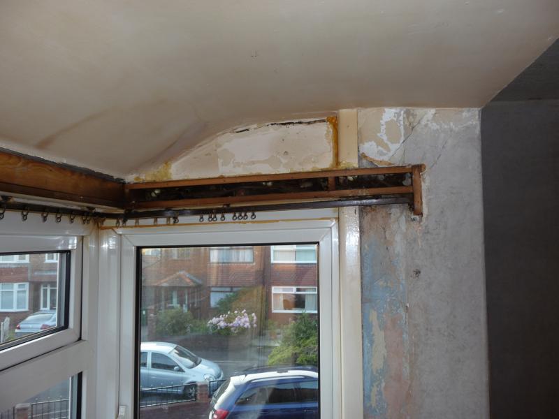

Finally the pelmet has to go as it's not level (and ghastly) and i'd like a firmer footing for fitting a curved corner curtain rail but ther isnt much room for fixings, the bay ceiling has a slight curve to it but a large water damage mark on it and a few cracks through. If I wanted this removed and replaced should a builder be the correct trade to use or is there a trade more specific for this?

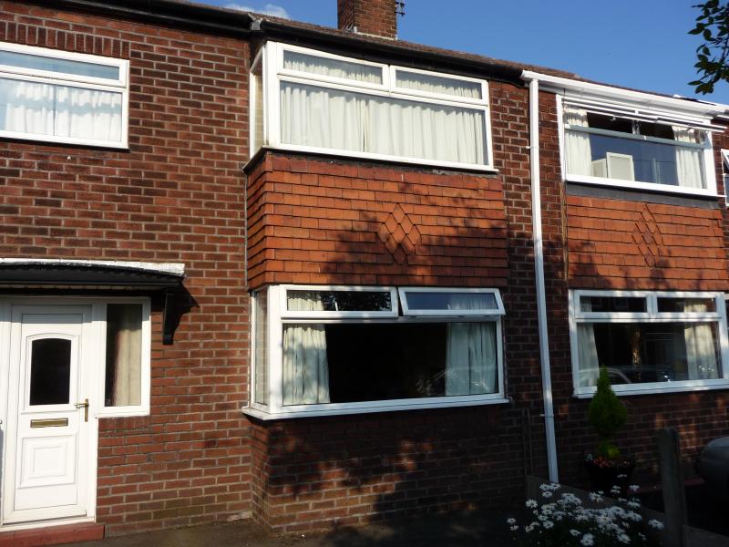

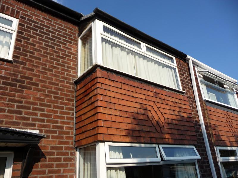

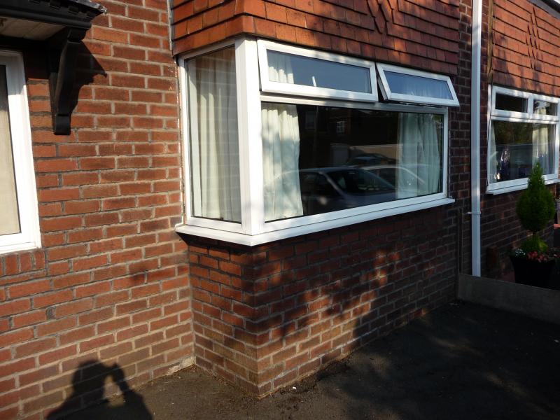

Your bay, from the first floor up at least, is timber framed. This is causing differential movement between the different materials of the bay and the masonry walls.
There could even be some slight differential settlement but you would have to post pics from external ground level and in the room below.This is very common in such bays.
Carefully examine the external join of bay and house walls.
I suspect when the PVC bay frames were installed that they disturbed the original detail.
The work to strip and rebuild the roof with suitable verge overhangs - the cill below is receiving splash - is simple enough for a builder or a roofer.
Remove the pelmet and drapes and foam, and post pics. The stain is irrelevant and can be treated after the work.
Movement at the interior corner - perhaps remove the plaster to reveal if the timber framing is loose from its fixing into the brickwork? Is it only one corner with cracks?

External view:

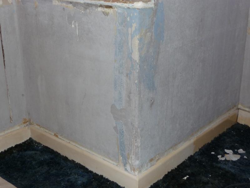

Internal downstairs:
Internal upstairs:

On close up of the interior, much of the cracking and discoloring of decorations appears to be the wear and tear of age. Perhaps a liberal use of first generation foams is also to blame.
I can see no obvious signs of the bay pulling away or sagging.
The major cracks are as i mentioned above, and you can rake them out and fill them, or hack out and patch plaster more significant ones.
The timber detailing for the pelmet can be made respectable by any joiner.
The roof should be dealt with as above, paying attention to the lead flashing leading off the main roof to the left of the bay. Perhaps use lead cheeks at the tri-angular sides.
The bressumer beam/lintel in the lounge is level and there are no signs of water stains - after stripping the lounge wallpaper more delapidations will perhaps become clear.
Essentially, you have a little aging house maintenance to take care of.

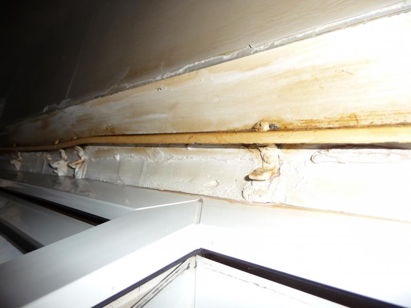

I will add one or two more photos when I get in tonight as there is a further (small) question regarding finish - under the timber where it meets the window.
The crack on the interior wall just to the right of the corner that widens/contracts when the window cill is nudged - Would a prefered solution be to strip that section back, check if timber frame is still soundly attached to wall, emply/affix new plasterboard pannel and skim?
Regards
Yes, i said as much in the last para of my first post - to be brief, remove plaster patches for about 300mm either side of the corner. Below the cill might be plaster lath or loose brick infill. Then post pics.

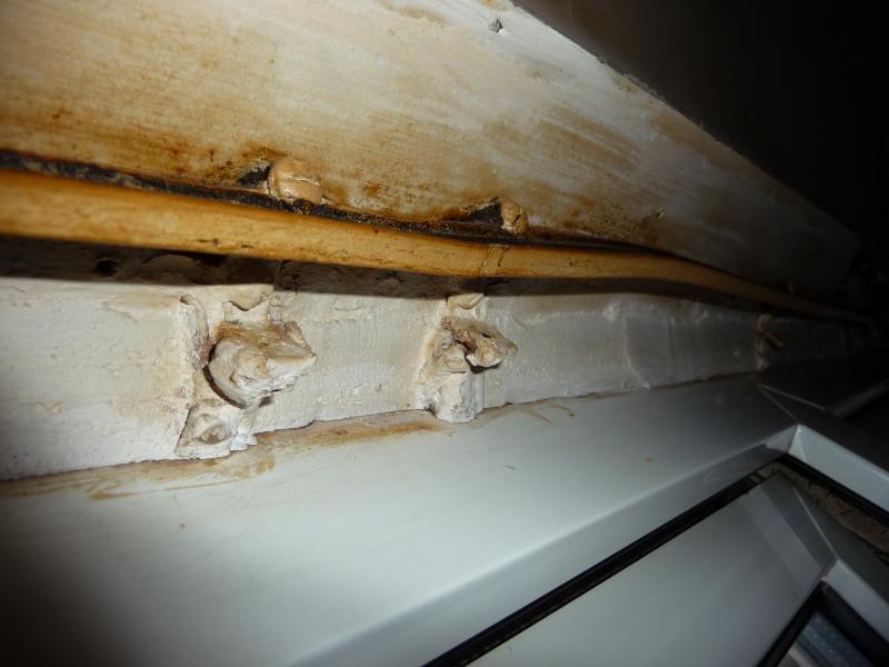

This unsightly plaster/filler sits between the UPVC window and the pelmet frame.
I'm going to go with it being a filler cement kind of thing as it is whit and rock hard. I presume once removed I'm best just using a simple silicone sealant? unless of course this is concealing more than just a join.
