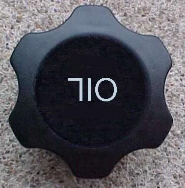

I always ask for grade 710, per the maker's guidance on the cap
