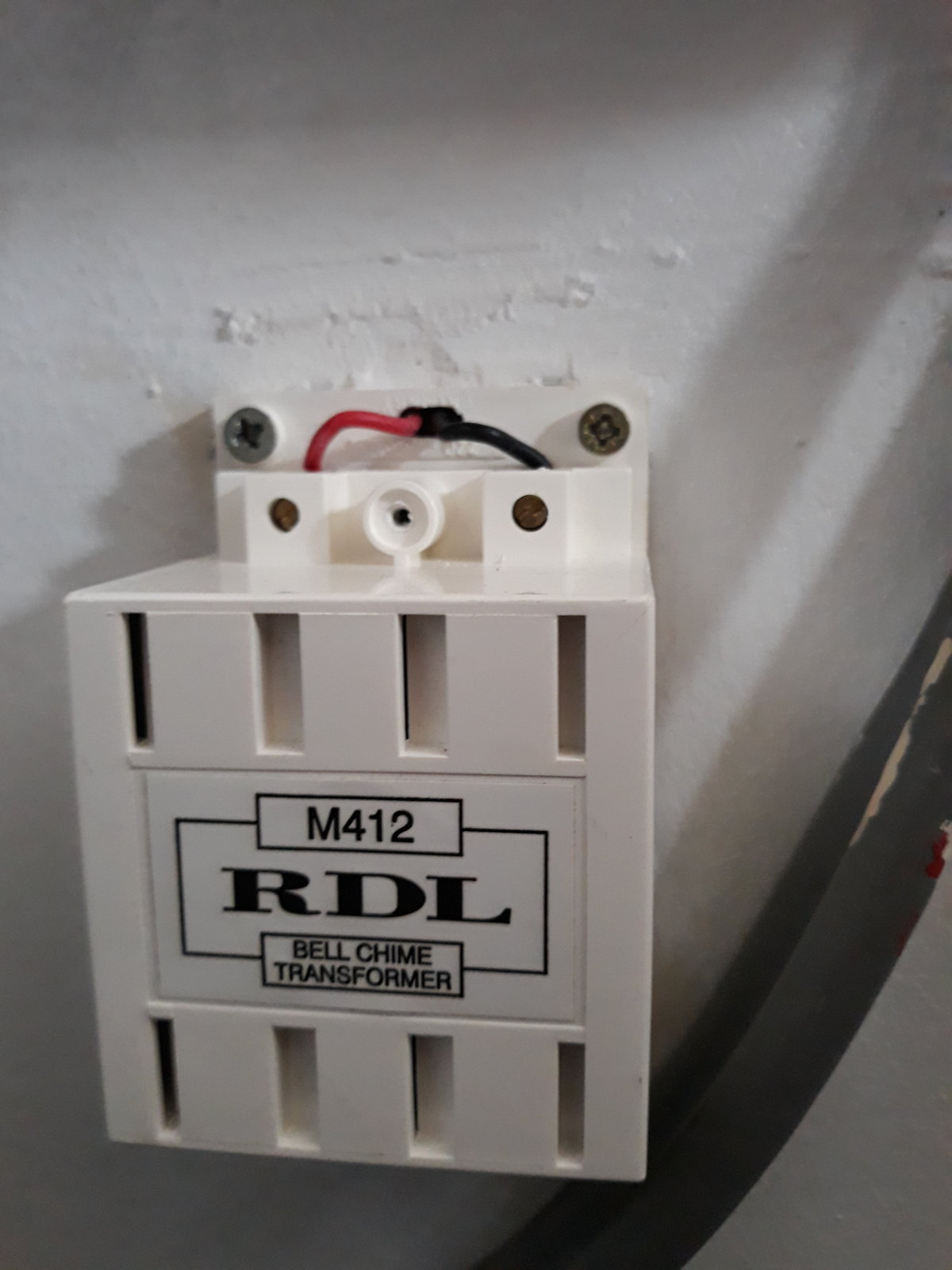

Hi all, i have a typical wired doorbell setup, the transformer is a m412 RDL next to the consumer unit. My biggest concern is the output from this the transformer is not fused, it just wires directly into the chime as you would expect, then from the chime a cable to the bell push. I know its extremely unlikely that the bell wire would ever become damaged or short circuit, but if it did i worry it would just melt as there is no fuses visible on the transformer output, unless its internal in the transformer like a thermal type?
I know the output is around 8 to 12v, but in the event of a short circuit I somehow doubt the ouput would have sufficient current to trip the b6 circuit breaker on the mains side and i fear the bell wire would just melt.
Is it common/ likely that bell wire is unfused? Or will the transformer have some form of protection for the output built internally like a polyswitch or something similar?

Some transformers have fuses in their outputs. Some don't. The transformer would not be able to supply sufficient current to melt the bellwire but may get hot itself. It may have some other internal protection, who knows.

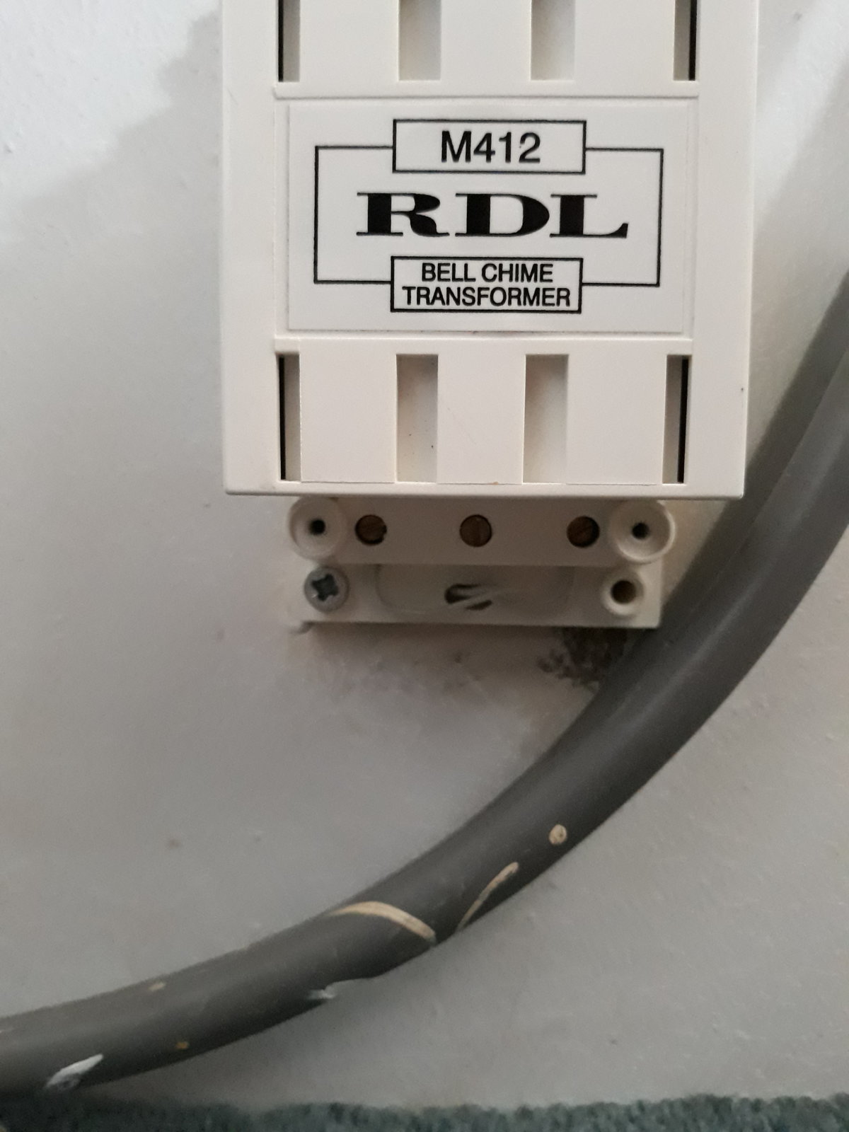

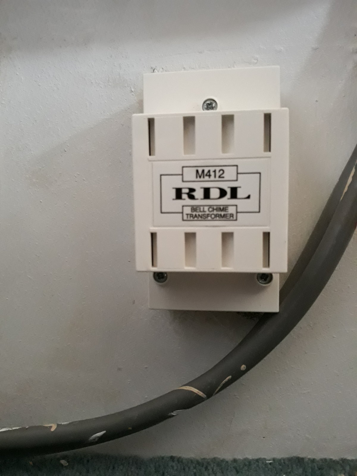

Thanks i can appreciate there are many different transformers so here is a some pictures of what i have.
Hopefully some may have seen or have used this transformer. As you can see there are no visible fuses, could there perhaps be some protection inside this transformer for the outputs?

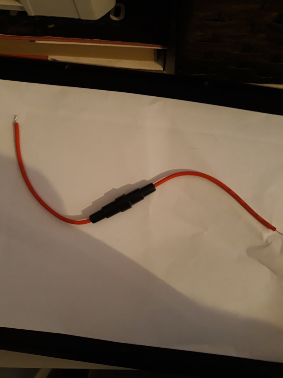

20191009_131330.jpg This is the chime obviously i was thinking of putting one of these20191009_131525.jpg inside the chime unit in line with one of the wires coming from the transformer. How power hungry are these chimes generally ? Would a 1 amp fast blow do the trick?
As you seem to be worried about the bell wire becoming short circuit the fuse should be at the transformer output not in the chime.
I will try fit it at the transformer, the reason i said chime is i am unsure the inline fuse will fit.
Will a 1 amp fast blow do?
yeah, Id use a slow blow
but its all rather pointless. I'm sure they test them with the output shorted.
They probably have a thermal fuse
Low current output transformers usually have a built in fuse but, after this blows, the transformer is useless and must be replaced.
I think that the smallest in line fuse available locally is 650 ma. You could measure the current when you operate the bell-push and select a suitable in-line fuse based on that reading.
