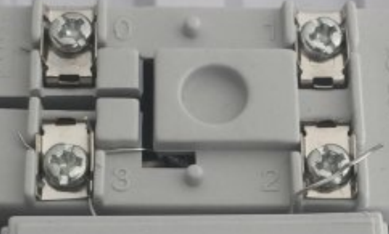

I just bought a new build house and it came with a delta C3500 bell with built in 6 volt transformer.
I changed it today to a Byron Bell chime with 8 volt transformer. However I need help identifying which wire goes where. I have plugged both mains wires to the bottom of the transformer and I note there are two wires for the bell.
I note the numbering on the terminals but unsure which one equates to Trans and Front etc ?
I have outlined a photo below and any help would be appreciated.
If the leads from the transformer go to the terminals with red rings AND there is a wire from terminal 0 to the coil ( as shown in green ) then connecting the bell push as shown in white should work.
I cannot see a wire from 0 to the coil hence the question.
I am wondering if this is a genuine Byron as the mains transformer lacks any standards markings and there is what apears to be a loose wire from the transformer close to terminal 2.
I've just read the user manual and it confirms 0 and 2. Make sure the cover is fitted to the mains wiring.

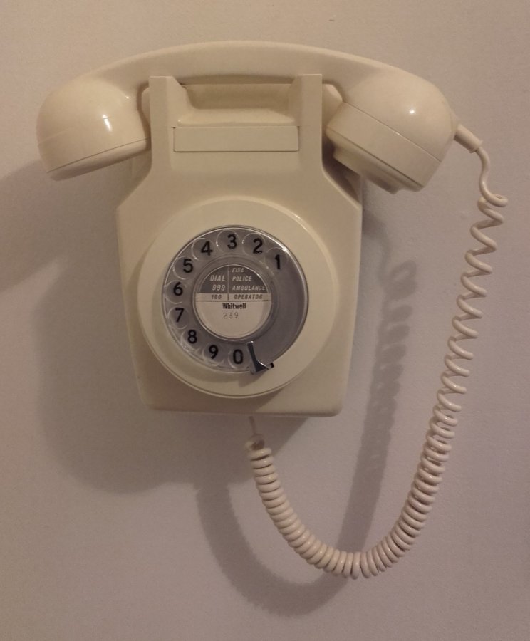

I'm missing something here. I had a call earlier if that counts?
Oh I get it now! I'm too young for a 3 digit phone number!

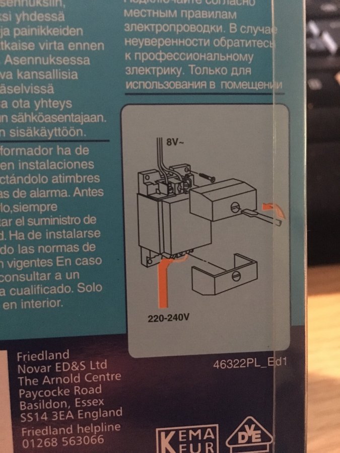

Hi All,
Thanks so much for your help, since I posted the message yesterday, my situation has since changed and I would welcome your guidance once more.
I have had clarity today that the Ring Video Doorbell Pro I was trying to install now only requires a transformer as the chime is redundant owing to the use of a wifi door chime.
I am now planning to install a Friedland 8V Transformer and understand the blue and brown cable go into the bottom and then the bell push cable (blue and orange) go into the top (please confirm this is correct?)
I also understand with the Ring Video Pro and an 8V transformer, I have to utilise the Pro Power Cable (https://support.ring.com/hc/en-us/a...-Installation-for-UK-Europe-8VAC-Transformers)
My question is which cables from the transfer do I run into the clips?
Thanks once again for your help, I really appreciate it.
