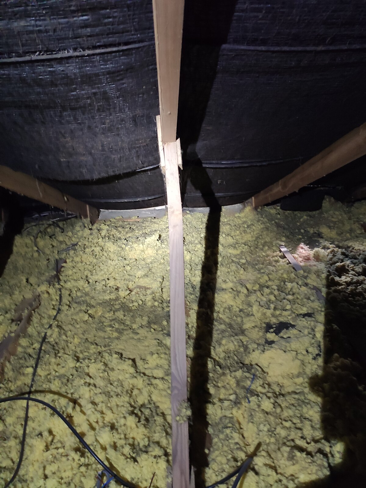

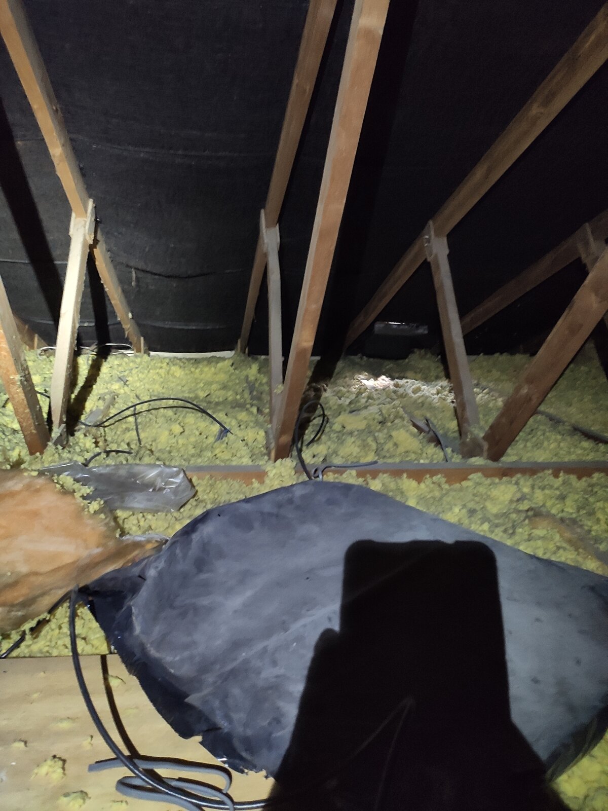

Today I was in my loft as I am in the process of replacing the insulation and I have noticed that one of the trusses is bent laterally.
I have bought the house a year ago so I don't know if it's getting progressively worse or not. It seems that there's a knot where the truss bends. Is this something I should worry about or likely to be stable?

I'd strengthen. Fix timber to the side with Pva, screws and clamp.
Those truss timbers with knots are a weak spot.
Father in law stood on one like that and it snapped at knot while he worked in timber construction roofs.
He was OK.

No. Unless it snaps.
Would that not became a big problem at that point?

I thought about doing that but I'm kind of scared of making more damage than good
Bridge a length of 4x1" across 3 trusses to help brace it.
If I do it that way, should I fix the brace to the top of the bent element?
Also... should I decide that I'm not comfortable doing this myself, what kind of professional should I look for? I suppose this should be a job for a roofer
You don't appear to have any diagonal truss bracing, if so the problem is bigger than one truss.
Yes, there's no diagonal bracing. It's a former terraced council house from the 70s. I thought that if the roof has been fine until now, that should not be a huge concern...
No past performance is no guarantee of future performance - that truss is evidence of that.

5)some of the trusses are not perpendicular: basically they are leaning on one side. There might have been movement overtime or it might have been like that from the beginning. Is that going to be a problem? I suppose that the bracing will stop that movement...
