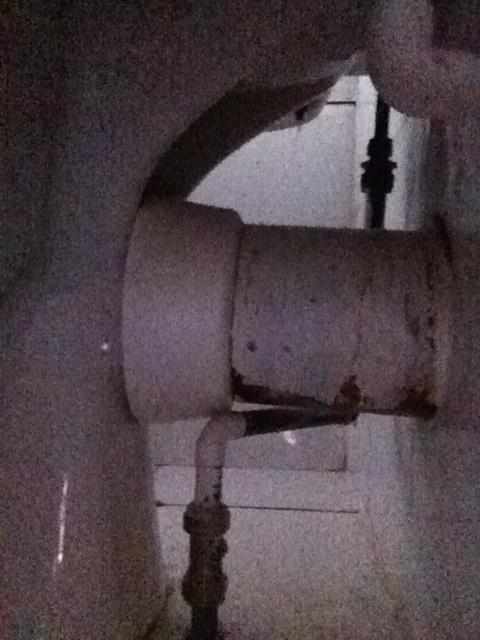

Are you sure it's the flush that's the cause?
No blockage, no sharp bends or other restrictions in the outlet pipework?
4 litre flush into an old 9 litre flush pan?
Oh no, I actually suspect a really cheap bowl coupled with a horizontal outlet (which I read somewhere isn't brilliant) straight out the back of the toilet, through the external wall and into the stack.
However, as I'm remodelling, and want a concealed cistern and wall hung bowl, I wanted some suggestions on the best systems available with emphasis on non-cloggability and bowl cleanliness.
Your 'not really' looks like a roughly 14° fall. That, coupled with the distance to the stack (roughly 18"?) should not cause a problem.
