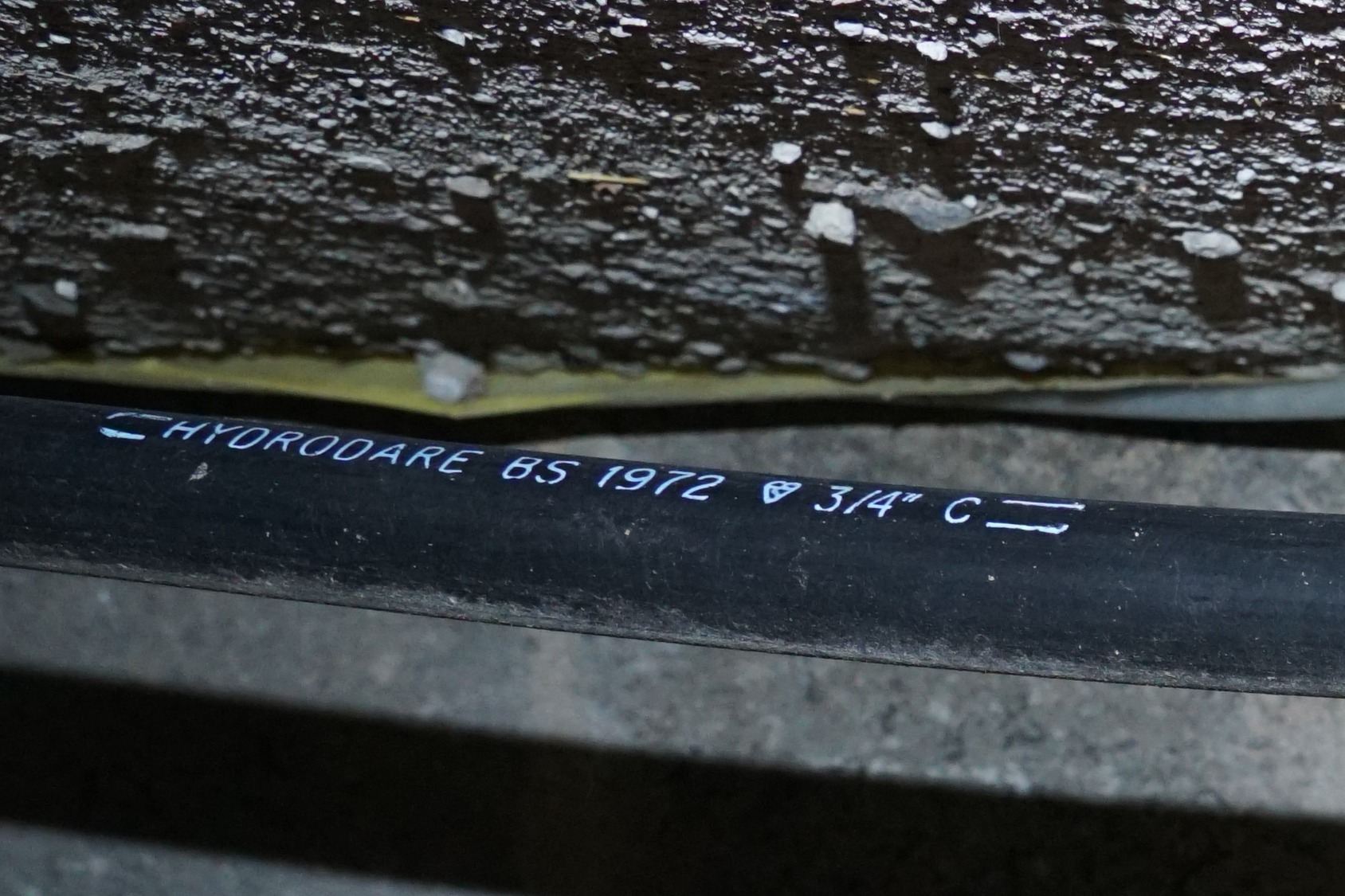

I need to join a piece of black plastic water pipe to 22mm copper. The plastic pipe is labelled Hydrodare 3/4" class C (photo attached). I measured OD at 27mm, which seems to confirm the sizes given here -> http://www.stevensonplumbing.co.uk/alkathene-accessories.html
I have looked at the Plasson and Philmac websites and I'm struggling to work out exactly which fitting I need for this. The house that I'm doing this in is fairly remote, so I need to be sure that I have the right components before I go to do the job, otherwise the place is left without water for as long as it takes to source the correct piece.
So can anyone tell me exactly what I need to join this to 22mm copper? Thanks.
