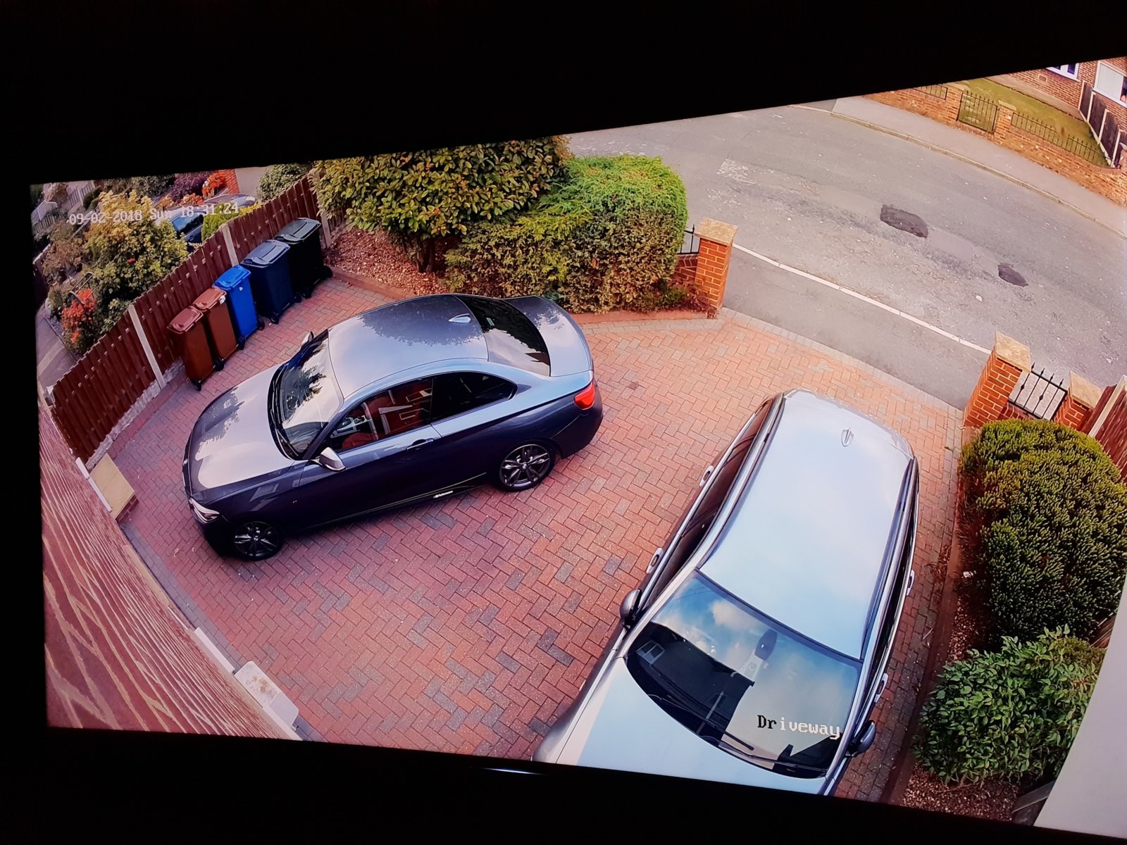

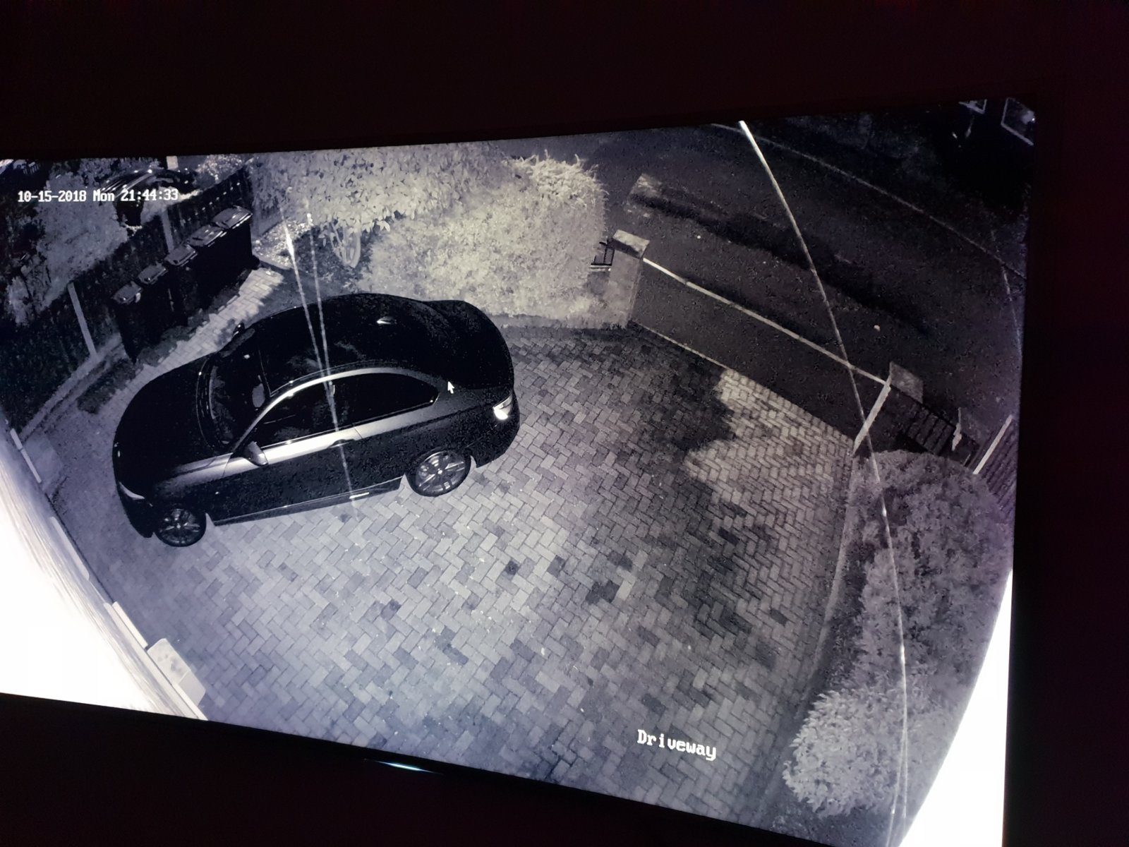

Hi, I've recently installed an Hikvision 4k turret camera (DS-2CD2385FWD-I/G) on the front of my house which connects to a Hikvision 4k NVR (DS-7608NI-K2-8P)...both proper UK spec, NOT grey imports. The front of my house is fairly wide, about 9 metres and about 8 metres deep to the road. The camera is mounted underneath the soffit looking down (two story house) and the wide angle lens covers everything really. Really happy with the setup, picture quality is outstanding, I have run an HDMI lead from my loft to my 4k TV in my living room and also ethernet with cat5 to USB converters so I control the NVR/camera with the mouse without having to go in my loft. As good as the picture is in daylight, and it is really really good, but, as expected, with such a high pixel camera the night vision quality is pretty poor...and I knew it was going to be. I am now looking for some LED flood lights for the front which I am going to set up on PIR's, possibly controlled by my Texecom alarm, not decided. Is there any particular type of floodlight which would suit my setup the best. I am thinking of 2 x 50 watt LED floods in 6000k cool white mounted under the soffits. I have seen these which look good and seem to be a reasonable price.....
https://www.wholesaleledlights.co.u...hts/standard/infinity-50w-led-floodlight.html
I would like it to be illuminated as much as possible as we have two fairly nickable cars on the drive which is why I put the CCTV up in the first place, would 2 x 50 watts be sufficient or over the top for the size of area described ?

Just taken a photo of my TV screen, this is my driveway
A high intensity LED may use pulses of very bright light and not continuous light. If the pulses of light are not co-incident with the camera's frame rate then strobing affects will occur. This can result in the image being dark for most of the time even though to the human eye the area is brightly lit.
Thanks for this, I contacted the retailer who confirmed they were continuous and perfect for CCTV. They recommended 2 x 30 watts for the area though rather than 50 watts so placed an order. Will post a picture when installed (y)
I have two 30w LED floods, mounted at opposite ends of the soffit, and covering a rather larger front area. They are operated by a separate PIR and give enough light for a good colour picture.
