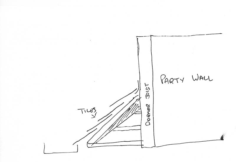

Thanks for the advice and the link. As it happens right now I do not want to start insulating the party wall (I just ripped a load of plasterboard off and found out a bit more). I have attached a diagram to explain... Basically i have a triangular roof void that butts up to my dormer at the front and rear of the house. This roof void continues right through to my neighbours dormer without anything in its way.
To make matters worse the plasterboard looks to be only 10mm and there is virtually no insulation for the walls attached to the void. This means I can hear an awful lot, often a lot more than I would ever want to... So, I have to find a way of stopping the noise as much as possible coming through that void, now the sound insulation material is very dense, would sandwhiching a lot of normal insulation between two pieces of plasterboard do the same job?

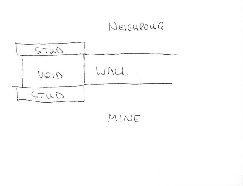

Looking at the second diagram, my plan would be to create a triangular wooden frame faced with plasterboard either side and filled with insulation. Attach that to the stud on his side and seal with expanding foam, then fill the void in the middle with insulation and finally create a second triangular frame and attach that to my stud. I woudl then insulate the outside walls to finish off.
Does this sound stupid, is there something different that may be better that someone can recommend?
