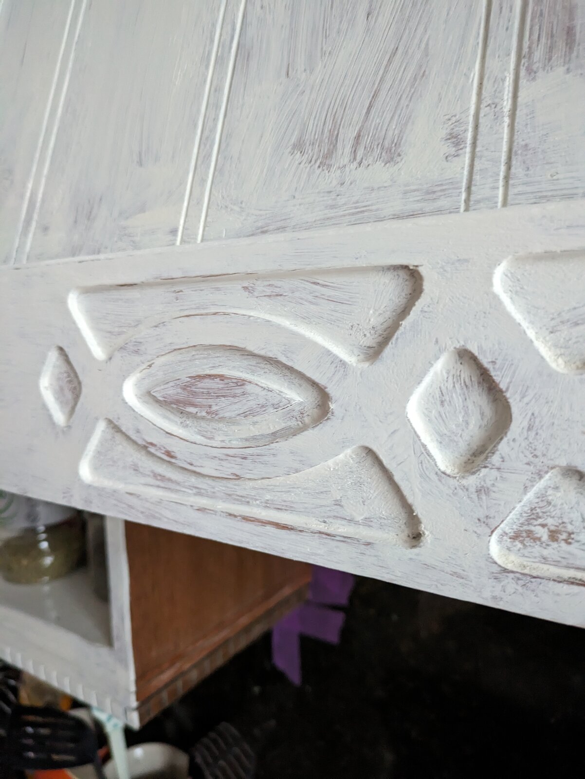

Hi all
Want to sand some primed kitchen units to a smooth finish, ready for final coat.
Some of the decorative moulding has swirly shallow inlays (see pic). How best to finish-sand the edges? Just patience and a sanding sponge or sheet?
Cheers
320 grade sanding sponge.
They don't last long as clog up but that's just how they are.
Go easy so you don't affect the moulding.
Forgive.
If that's your primer that you applied you need a better application technique.
Your going to go around in circles otherwise.
If you are struggling try a spray can on the mouldings.
Foam roller on the flat areas
