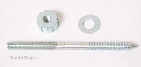

That doesn't make any difference, it would have been a builder's bodge back then, too. The traditional method a carpenter would more than likely have used is handrail bolts:
The coarse thread is a wood screw thread. You pilot the newel post, put two hex nuts on the finer thread locking them together and screw the "stud" into the newel post using a wrench, and finally remove the nuts. The handrail is end drilled to take the bolt and a pocket chiselled-out of the underside of the handrail to accommodate the slotted nut and a washer. The slotted nut is hand tightened and final tightening is done with a sort of bent flat drift (straight drifts can be used but are nowhere near as effective). I used to have one years ago which an uncle in the trade made, but AFAIK they were always made-up by the local blacksmith out of an old cold chisel, because they were a tool you bought once in a lifetime, if that

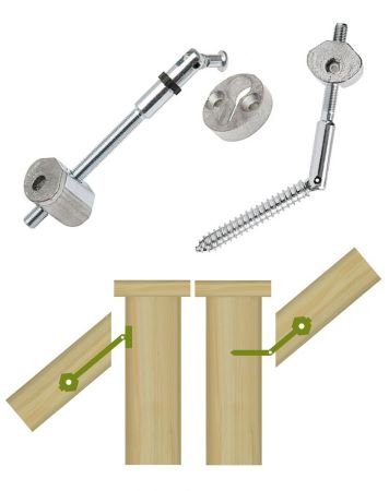

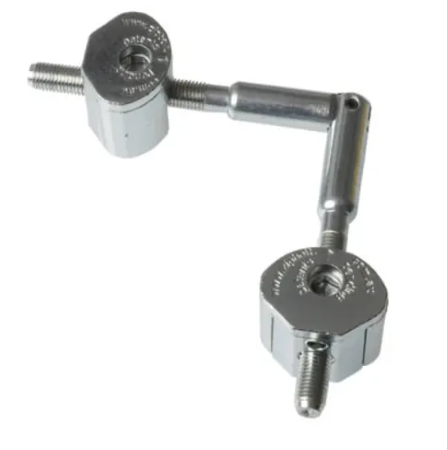

Before I had my Festool Domino machines I used to use these jointed connectors:
which can be installed with a drill, a 10mm auger bit and a 25mm Forstner bit. They work well and they are fairly forgiving of minor errors. At one time I had a firm locally which stocked them, so maybe that has coloured my view. The other ones I've used are Zip Bolts:
These require the same 25mm Forstner/10mm auger bit to install. Zip also do fixed straight connectors for landing handrail to newel post connections
