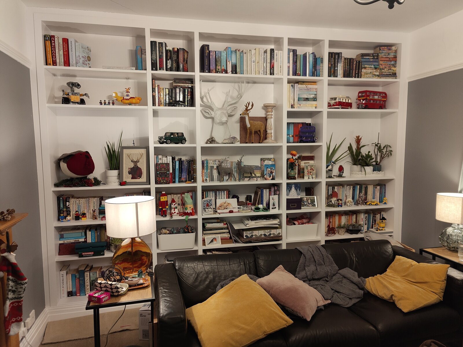

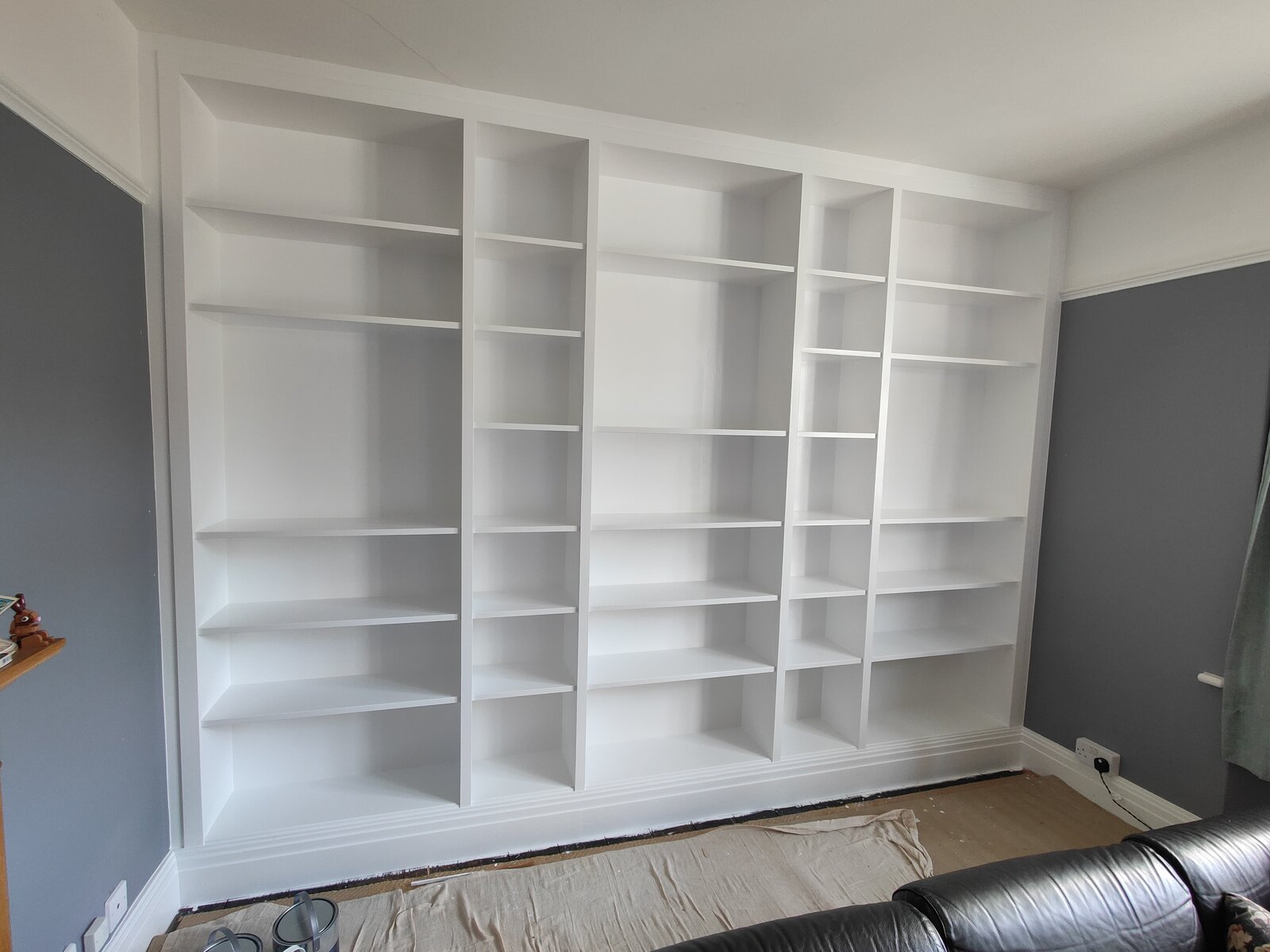

Well funny you mention cracking, I used it at the sides and top of a massive built in wall shelf unit, a bit like a bath, the whole thing sank about a mm or so at the top once it was loaded with books so there is a hairline crack at the top, so I guess in retrospect I should have caulked (the top at least) after it was loaded next time, not that you can see it unless you're right next to it but I guess that's not really an issue for you.
I followed the instructions in this thread with regards to priming, then caulking, then painting: https://www.diynot.com/diy/threads/painting-shelves-unit-where-it-joins-the-wall.632871/
