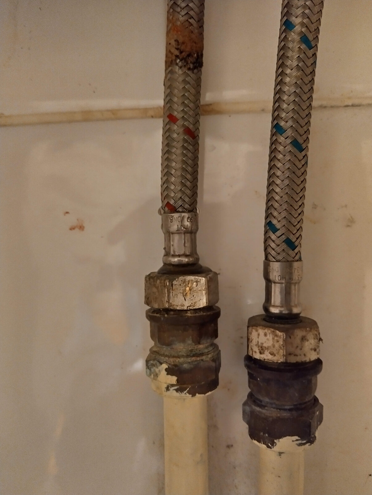

the fitting I can get to is about 22mm af for the flexi and the pipe fitting it connects to, it is leaking from the top of the crimp that connects to the plumbing.

Yes, the two tails go directly into the tap body, at the end where it joins the rest of the plumbing it has a fitting with a rubber seal, and not a compression fitting so most of the ones I have seen on screwfix and toolstation are not suitable, that was the bit I was trying to help with until I can get a picture done.

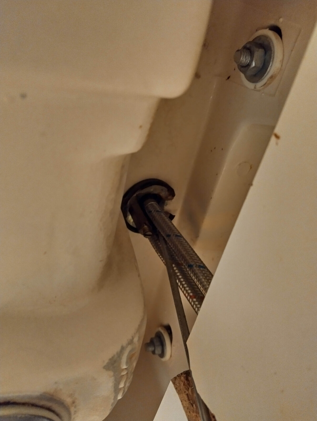

but still not sure it is the right one to buy. I am going to be working under the sink inside the two door cabinet underneath, and I cannot see there will be room to turn a spanner up in the gap between the wall mounting part and the rear of the basin, also has the overflow running down next to the tap itself.

Well here are two pics, I have the horizontal cabinet support in the way too, but would really really like to leave the sink in place.
Looks like there is plenty of room to put a spanner on those
exactly, its the tap end that has to come off one of those, I already undid the leaking one and replaced the rubber as it was looking quite collapsed, but still leaking and then noticed the water coming out at the top of the left hand crimp in the top
picture. It would be a pain to take the sink off the wall and cupboard unit just to do that single flexi change. not sure how to get access with a wrench or spanner to the underneath of the tap.
You need a box spanner to loosen the tap, Once the 2 flexis are undone at the other end the tap can be removed from the basin.
