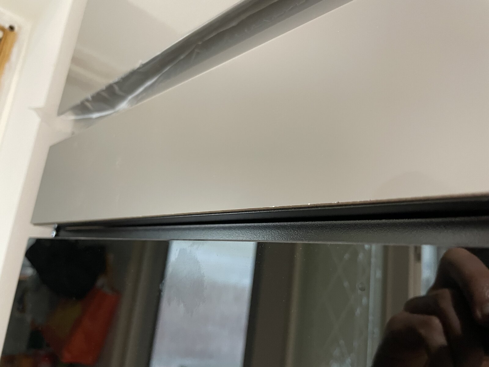

I need to cut kitchen end panels, they are painted MDF; at least two of them will need to be super accurate and without chipping because there will be no caulking: one of them is going between two wall units and the other one is a filler panel above the microwave door (the cut edge will be against the microwave metal frame).

One is the panel above the microwave, that had to be cut to size (not all ovens are equal I guess)
