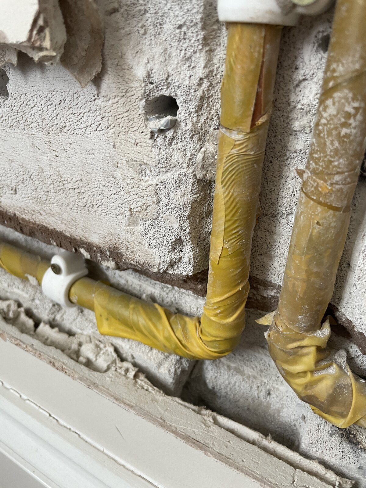

On another thread, someone kindly suggested that this yellow tape on my central heating pipes was simply pvc tape
I need to extend so need to get back to clean copper to do a proper soldered joint
Any advice on what to use please ?
The tape is so brittle it comes off by the millimetre
Is it just a case of keep at it and thrn when the majority has gone, use fine grade wire wool it ?
Or is there anything better for cleaning copper pipes ?

Good grief, you'd think they could have done a better job with better stuff to coat the pipe.
Noting better unfortunately. Scrape it with a stanley blade? Burn it off then wire brush?
That tape will do but TBH any coating will work, even painting with an oil based paint. Anything that keeps the plaster/mortar from contacting the copper.

Think I’ll start picking away at it then ☹️
I’ve bought some of this to replace it with :
Better off with gaffer tape and wrap it longitudinally around the pipes... Like wrapping a label around a bottle style.
@Madrab
What’s your thoughts on these strips :
…or 180 grit strips ?
Used them ?
Downsides is they are expensive but benefits I see is being able to get around the back whilst still clipped and obviously, not having wire wool fibres all over the place, stuck in fingers etc
Multi solve will melt glue.
Stanley blade glass scraper as it is ridged
Thanks @dilalio …I’ve not seen that before
Have you used it on copper and can confirm it doesn’t affect the metal ?
No. I can't.
But you're not leaving it soaking in it and will be wiping it off and diluting when clean.
I've used it on all surfaces.
Flux is much more aggressive and yet is essential for copper soldering - as long as it's cleaned off!
