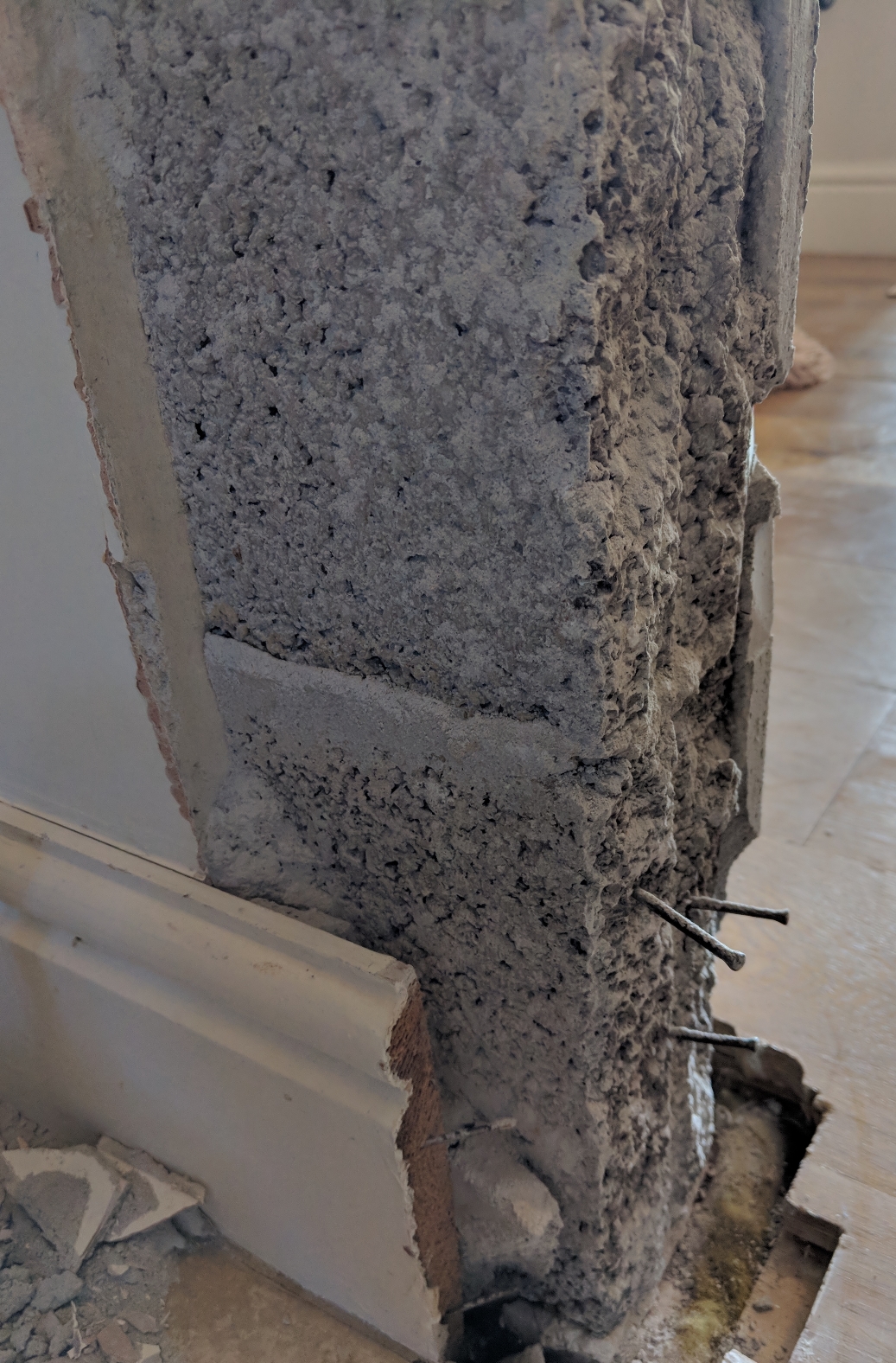

I'm shifting an existing doorway by about 15cm, which is framed by concrete blocks - full photo attached. The engineering is all approved - lintel end bearing still good and all. But I'm not sure how to best cut the block in place without making a huge mess. These blocks are dense and much tougher than the lightweight celcon and such that cut easily with a masonry saw. Last resort is the angle grinder... is will work but takes weeks to clean up the dust!
Also, any suggests on how to build out the other side of the doorway by about 10+ cm? Bricks? Celcon blocks? On end?

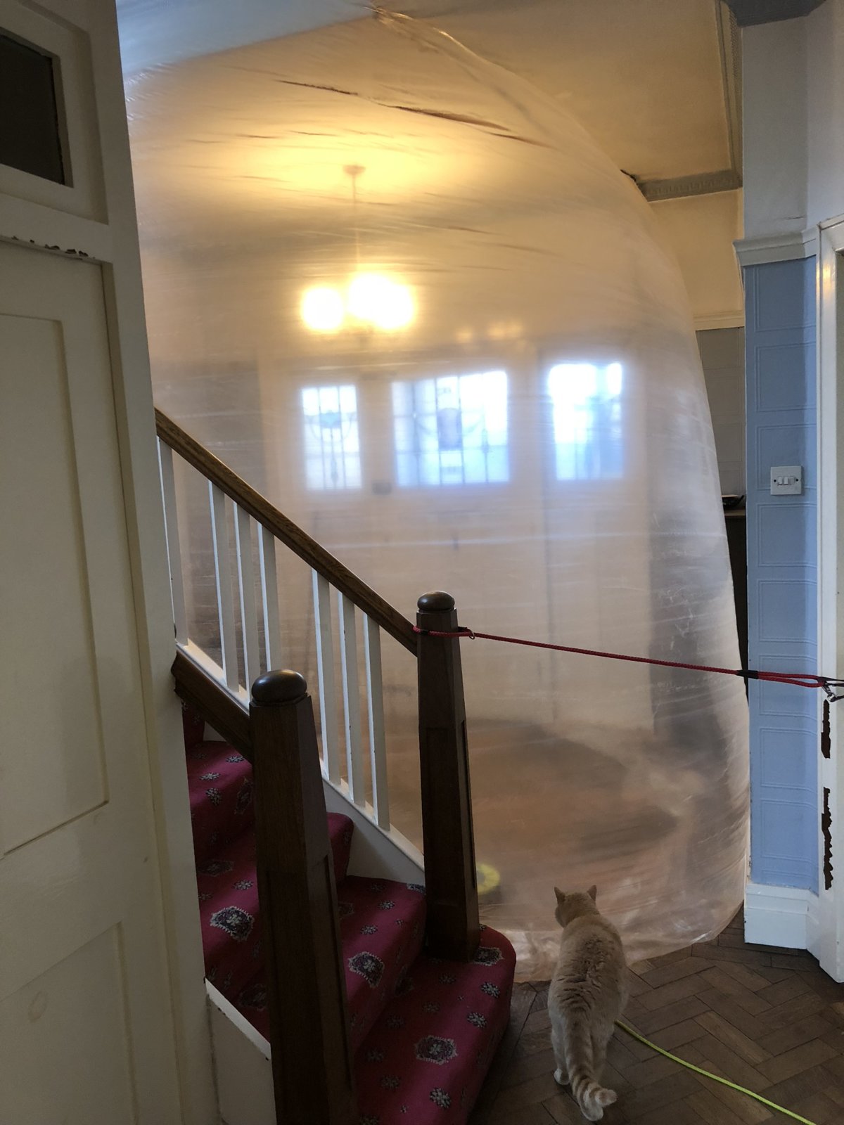

I did something by building a polythene tent with wooden frame to minimise dust and a wet/dry vacuum on full

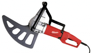

Hire a Kango KS wall saw?
They cut reasonably quickly but produce far less dust than a Stihl saw or a grinder. I believe that production has now ceased but a lot of hire places still have them. Arbortech still sell a similar product, the Allsaw, which is available in both electric and petrol versions

I think the poly tent is a must and wetting is worth trying too. Stitch drilling is probably the best way to go as of now at least.

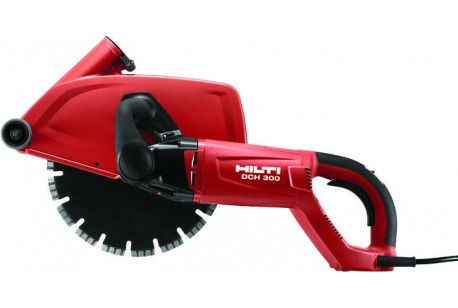

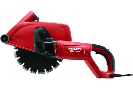

Look at hiring a Hilti DCH 300 + M.class. Vac.

Stitch drilling with a 12mm SDS, a bolster and pry bar worked very well. Thanks for the suggestions.
