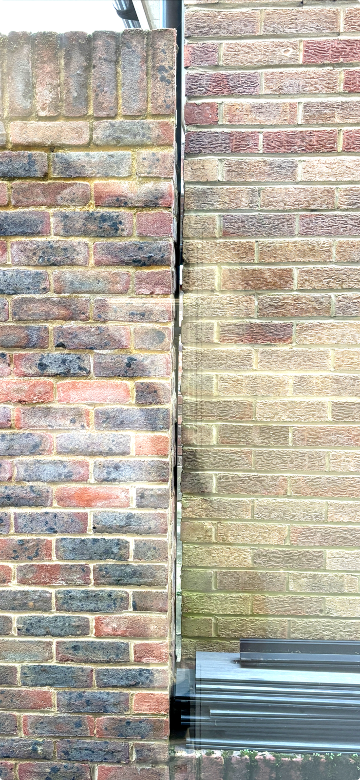

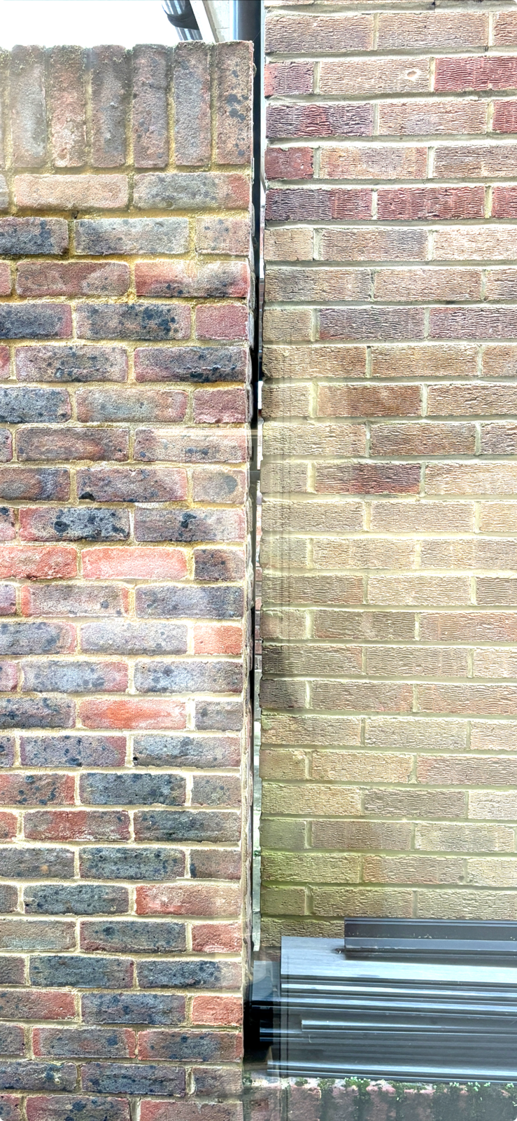

There is a brick wall at the boundary between me and my neighbours house. This wall is made of two sections and there is a ~1.5 inch gap between the two sections - see photo. What’s the best way to fill this? Expanding foam?
Thanks.

Why do you want to fill it?
For privacy
For that you would use a backer rod to fill in most of the gap and then apply a sealant over the joint to finish it, same on the other side normally eg
Gap 30mm+?
Actually gap is 15-25mm (not the same width the whole way). Need it to be about 1300mm in heigh
Given the gap is not the same the whole height, should I get 25mm backer rod (as 25mm is the widest part) and will I be able to easily compress the backer rod to say 15mm where the gap narrows?
thank you!
The 12mm expansion joint foam can be pushed in without cutting simply hold against the gap with a flat paint scraper push into the gap all the way down give you about 100mm inside the gap( folded double)
