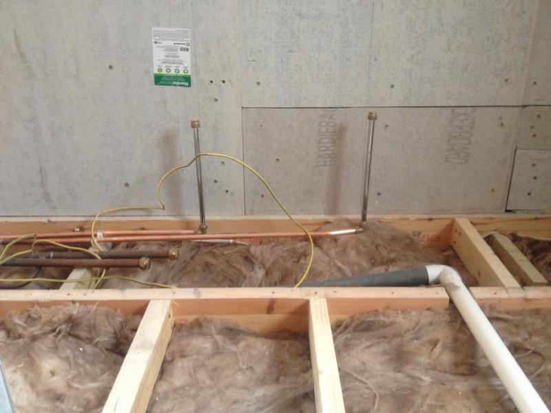

I'm about to plump in a towel rail radiator in the bathroom. The pipes come up from under the floorboards, and i'm wondering what is the best way to go about it. I'm using plastic pipe, but have some copper pipe lying around if necessary.
Do i either...
1) Feed the plastic pipe vertically up from the floorboards straight into the radiator (using straight valves)
2) Feed copper pipe vertically up from the floorboards straight into the rad (straight valves)
3) Hide both pipes in the wall (somehow) in the center of the rad, and then come out of the wall and horizontally into either valve (angled valves)
4) Do some other funky more professional way...
Thanks!

Stems answer about finishing the plastic below the floor and coming up in chrome finish pipe sounds good.
Pipes in the wall insulated along their length to the exit point.
That allows movement and the other obvious benefits.
Then the valves fitted straight on.

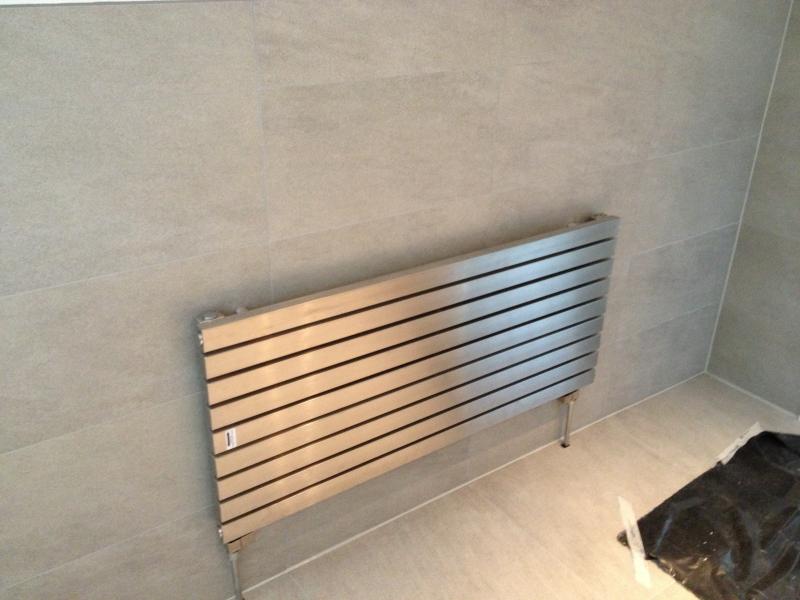

Virtually no pipe exposed and fit the chrome escutcheon plates on the exit point.
Like this one I prepared earlier...
http://s26.postimg.org/qv1gnul61/Bathroom.gif
You can see the pipes in the bottom right hand corner.
Rail is set on packers to the correct level and plumb then the valves are fitted.
Then the holes are marked, rail removed, holes drilled, plugs inserted and rail re set on the packers, valves tightened, brackets screwed on, escutcheons snapped on and packers removed.
Job done.
