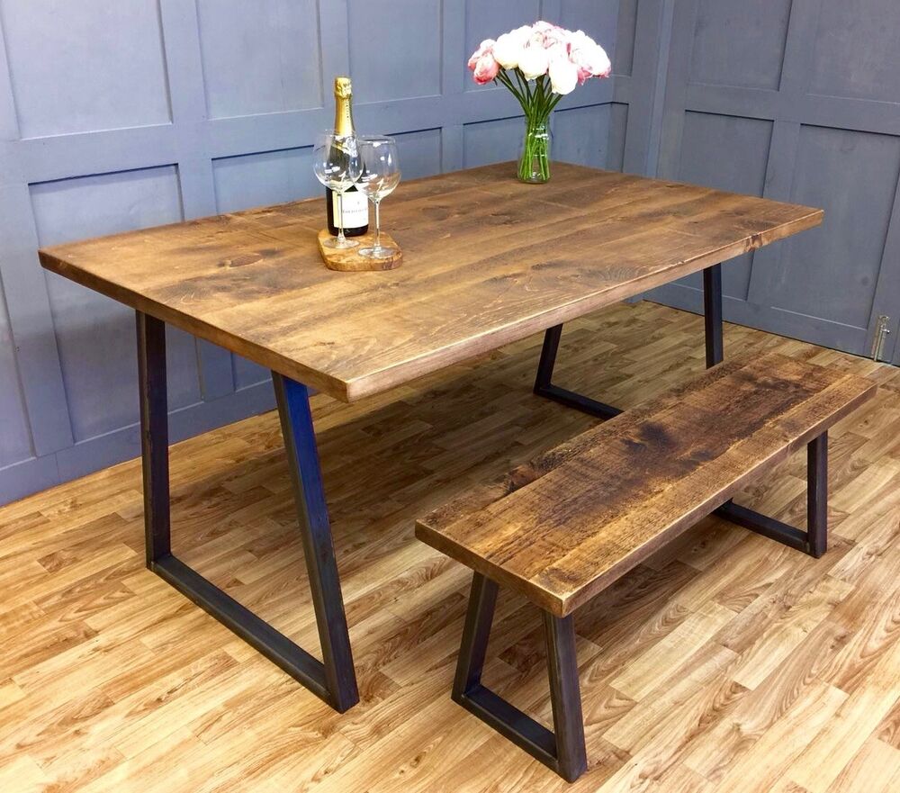

I have an industrial reclaimed dining table and two benches (see photo) which I have been using indoors for several years. Due to a house refurb I now ant to move this set outside and use as garden furniture. What do I need to do to protect it? FYI the wood is 'north american pine that has been professionally kiln dried'.

It won't stay kiln dried for long outdoors! It is going to go from 8 to 12% MC (moisture content: indoors in a CH environment) to 16%+ outdoors and you cannot stop that happening, so it will swell a bit. I'd suggest it is liable to cup or bow across the width no matter what you do, and more so if the fixing holes aren't elongated to allow for movement (wood swells and shrinks much more across the grain than along it), so that's the first thing I'd look at. after that I'd have the timber bits off and give it 3 or 4 coats of a good exterior lacquer such as Sadolin, and if the steel bits are bare (which they look like they are) I'd give them all a coat of Hammerite unless you want to get rust stains on your clothes in a few months time

replace the timber with say 6x2 cls or scaffold boards store the pine in the dry till later
i have 2 benches and 2 tables made from 6x2 cls now about 5-7 years maybe more untreated
yes its grey but little to no mould or decay i designed with sacrificial pads in case off rot but none has been noticed yet
Unless you use really expensive marine finishes that have UV inhibitors, I would expect the wood to fade even if the finish remains intact.
Although I like Sadolin, if offers little UV protection.
Owatrol seem to say that the following offers UV protection. Before buying any, I would recommend that you ask them about potential fading first.
https://www.owatroldirect.co.uk/product/linitop-yacht-vernis/
Additionally, ask them how much you will need, it ain't cheap.
