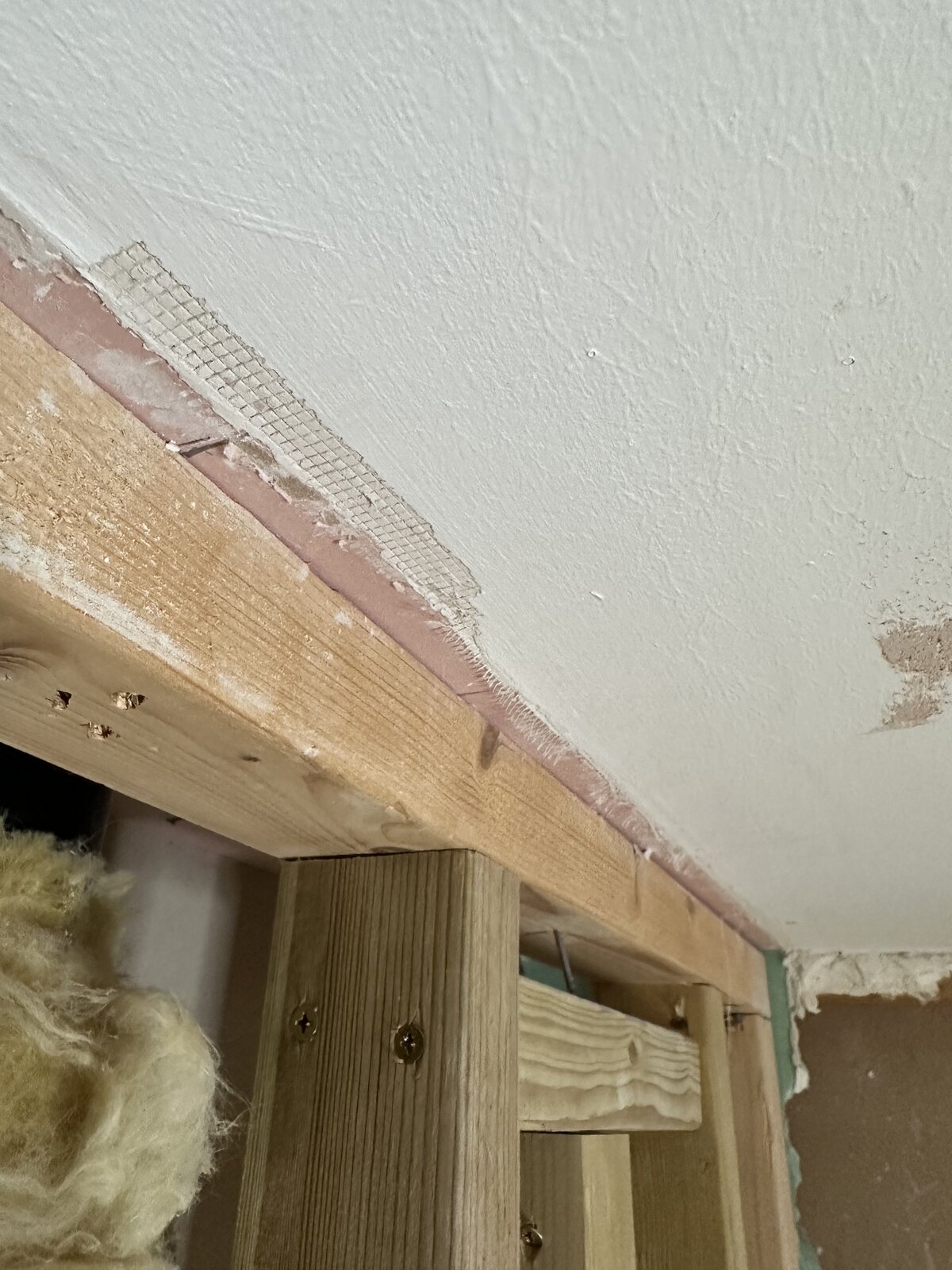

What would be the best way to plaster the edge of this ceiling? The joining walls are going to be tiled. I have a bag of multi finish so could use that? Or purchase some easifill?
Box of toupret powder.
Damp sponge the edge of filler to blend in with existing ceiling.
180 grade lightly sand.
Paint
