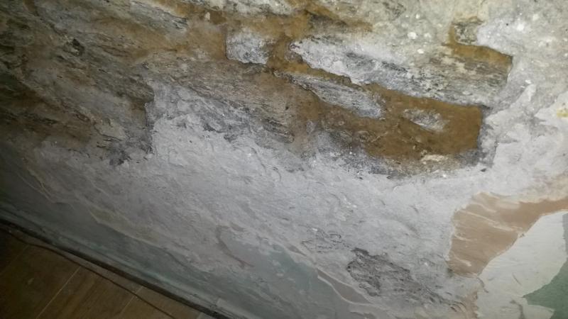

Ok well as the title suggests we want to remove the internal concrete render that has been put on all of the internal walls of our 1860s Cornish cottage.
The wall itself comprises of a layer of plaster, then about an inch thick layer of cement render, under which is a rubble wall with earth between the stones in lieu of mortar.
We are going to remove the plaster (the majority of which is blown) and the cement, point the wall with lime mortar then insulate using some form of breathable insulation such as cork, before plastering over with a breathable mix.
I think the best way to remove the render is using my SDS drill with chisel attachment with a relatively high angle of incidence so that I chisel down, not in, to the render - thus hoping to remove it relatively quickly and not disturb or damage the stones underneath too much.
My wife, however thinks this will damage the structure of the wall, and instead has been using a hammer to weaken and break the concrete and plaster, before using a chisel to prise it off. The photos show the results which took approximately 3 hours.
Who is right and what is the general consensus? I am happy for there to be minor damage to the stone underneath as we are going to cover it, but obviously do not want to disrupt the integrity of the wall.

Sand and cement render can sometimes be hell to remove - as the render comes off so sometimes does the backing masonry. But you wont damage the integrity of the wall.
Your tool doesn't seem powerful enough. Maybe go hire a Milwaukee Kango Breaker or similar.
Insulating with cork is new to me, quite how do you propose to do it? I'd suggest that you research the subject on here and in the Building forum.
