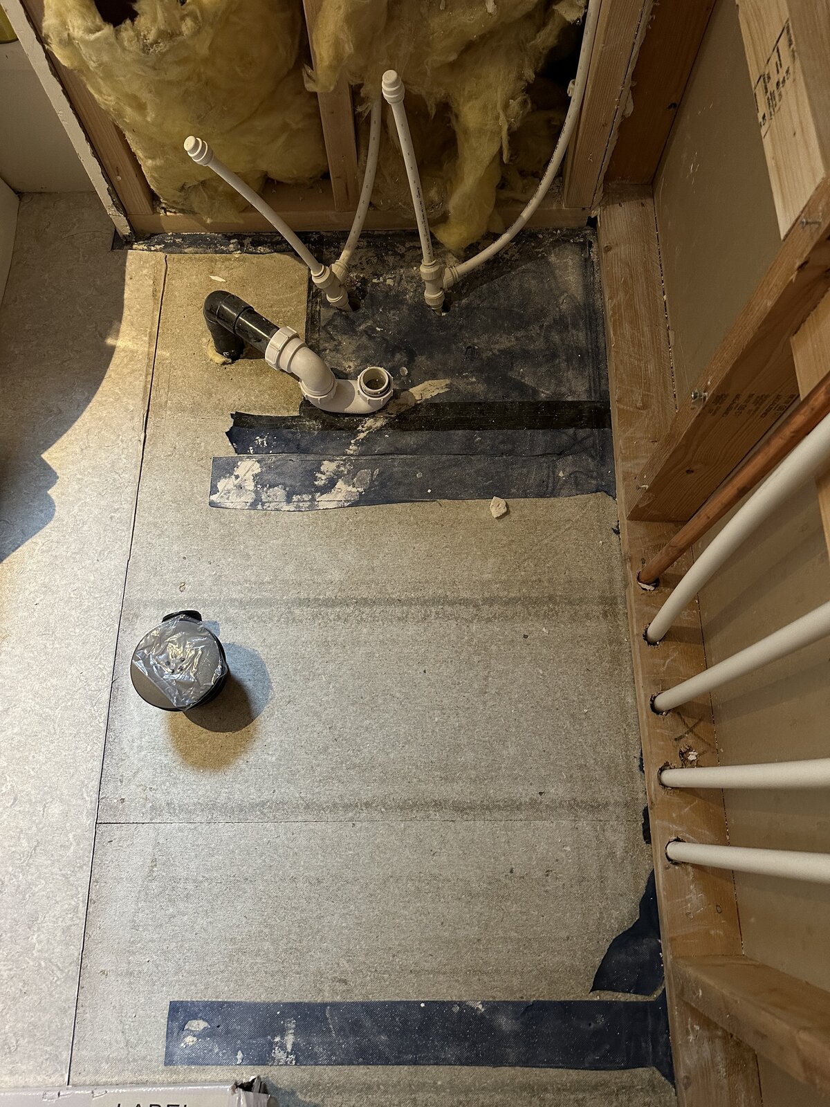

I’ve removed my bathtub and currently have the hot and cold water pipes coming out of the floor. I’m planning to install a shower tray and a thermostatic shower. However, I’m unsure what to do with the exposed pipes.
Should I cut into the floor and move the pipes behind the wall, or would it be better to build the shower tray on a frame and route the pipes behind the wall above the floor?

Remove the Tee's and connect with straight couplers, redirect under the floor and then up into the frame's cavity.

Thanks! I assume wooden batten joists would be sufficient to secure the chipboard after cutting it?
If there's nothing under that section of P5 Board then it can be strengthened with a piece of baton underneath if the tray edge is to sit on it, ideally as a noggin in between the joists. If the tray is sitting on P5 and the edges of the tray will be in between the joist then add extra support noggins underneath to stop the P5 from deflecting where the tray edges will sit.
I would also tank the space - any water onto P5 will cause all sorts of nasty issues.

No matter what you do, don't lay the tray directly onto P5, it's will need a more substantial surface as in ply or OSB3.
The important thing to consider here is if the tray edge seal did become compromised, the water will head down, if it then gets to that chipboard and it's not seen then over time the chipboard will break down and the tray will move/drop. Seen it and repaired it countless times.
That why you want to get the pipework under the floor and then up though the wall baton and into that wall space. Then that wall is sheeted to the floor and then the wall and floor wet space is fully tanked to make it water proof. Of course where the trap will be there will always be hole, if the waste run is up out of the floor but there's nothing that can be done about that so ideally that's kept to the centre or outside centre edge.

What would be the best way to cut the chipboard? It’s either 2 small sections or one large piece.
I’d need to cut one section to move the hot/cold pipes and another to move the waste as it’s located in the middle of the tray, or one large section for both.

Look down the board for the current nails/screws. I presume the line to the left is already a cut line? What way are the joists running? If the line towards the bottom also has screws in it then that would suggest it's on a joist too. Alternatively that could be a T& G joint line. You want to cut it to the middle of a joist so both side of the board can be screwed back down.
Do you have a multi tool/circular saw? If the latter then set it to 1mm deeper than the board (18 or 22mm) and cut down the centre of the screw/nail line, multi tool blade, piece of tape to the same depth and cut.

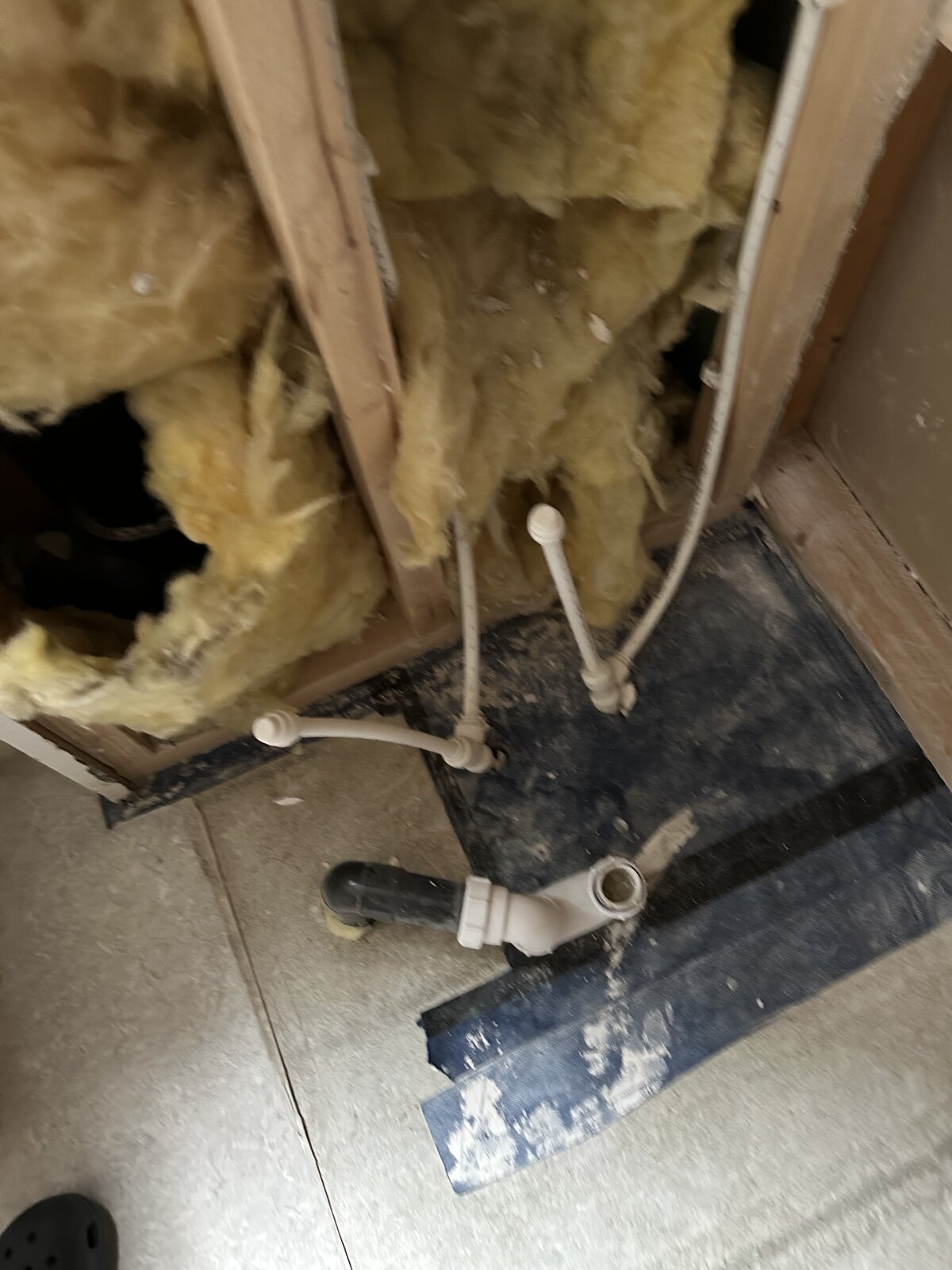

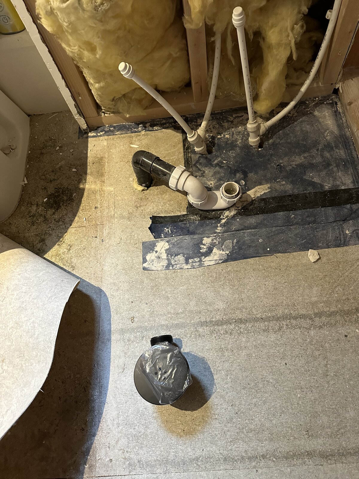

The line to the left marks the edge of the old vinyl flooring. I’ve attached another picture with the vinyl lifted for a better view. If the joists are aligned like they are on the floor above, they should be running parallel to the pipes, from the trap to the wall (if that makes sense). The chipboard flooring is tongue and groove, as I discovered when cutting into it in another room.
I have both a circular saw and a multi-tool, so I’ll use these to get the job done.

Ah OK, it looked like a floor cut line.
So what you need to do is find the nails/screws that were used to secure the flooring down. That'll mark where the joists are - draw a straight median line through the line of nails/screws and cut along that - you should hopefully be hitting roughly the middle of the joist doing that. If the joists are running North to South in the pic then you need to find the centres left and right, top and bottom won't matter so much.
I'd lift a section the size of the tray to do the pipework and add in supports under the floor whist you're there, as suggested earlier. How big is the tray?

Yes that makes sense. The tray is 1400 x 760mm.
Yes, if it's that large a tray then I'd be adding support under that floor. As suggested especially where the outside edge of the tray will land to stabilise the P5. Consider a supplementary board (WBP Ply/OSB3) on top too to add resilience.
