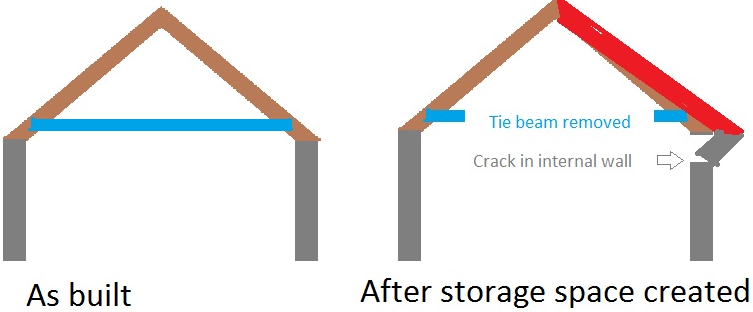

A photo of the inside of the loft would help.
Roof spread can happen if the roof relies on tie beams and some of these have been removed because they were in the way when a previous owner was using the loft for storage,

As, bernardgreen above the roof spread is as detailed [very well in images] or? in some occasions the ceiling ties are not fixed to the rafters? if you consider the "dynamics of a roof, in simple terms the roof load including [especially] tiles or slates that are really heavy are pressing down on the rafters, which in turn are resting on the wall head, if Un-restrained the walls at some time can spread [move outwards] to counteract this downward / outward movement a "Tie" which doubles as the timber to which you fix the upper floor ceiling to is inserted, with the proviso that these "Ties" must be securely fixed to the rafters. The above effect is exacerbated by the action of wind which causes a [best called] vibration, that in turn assists the roof spread.

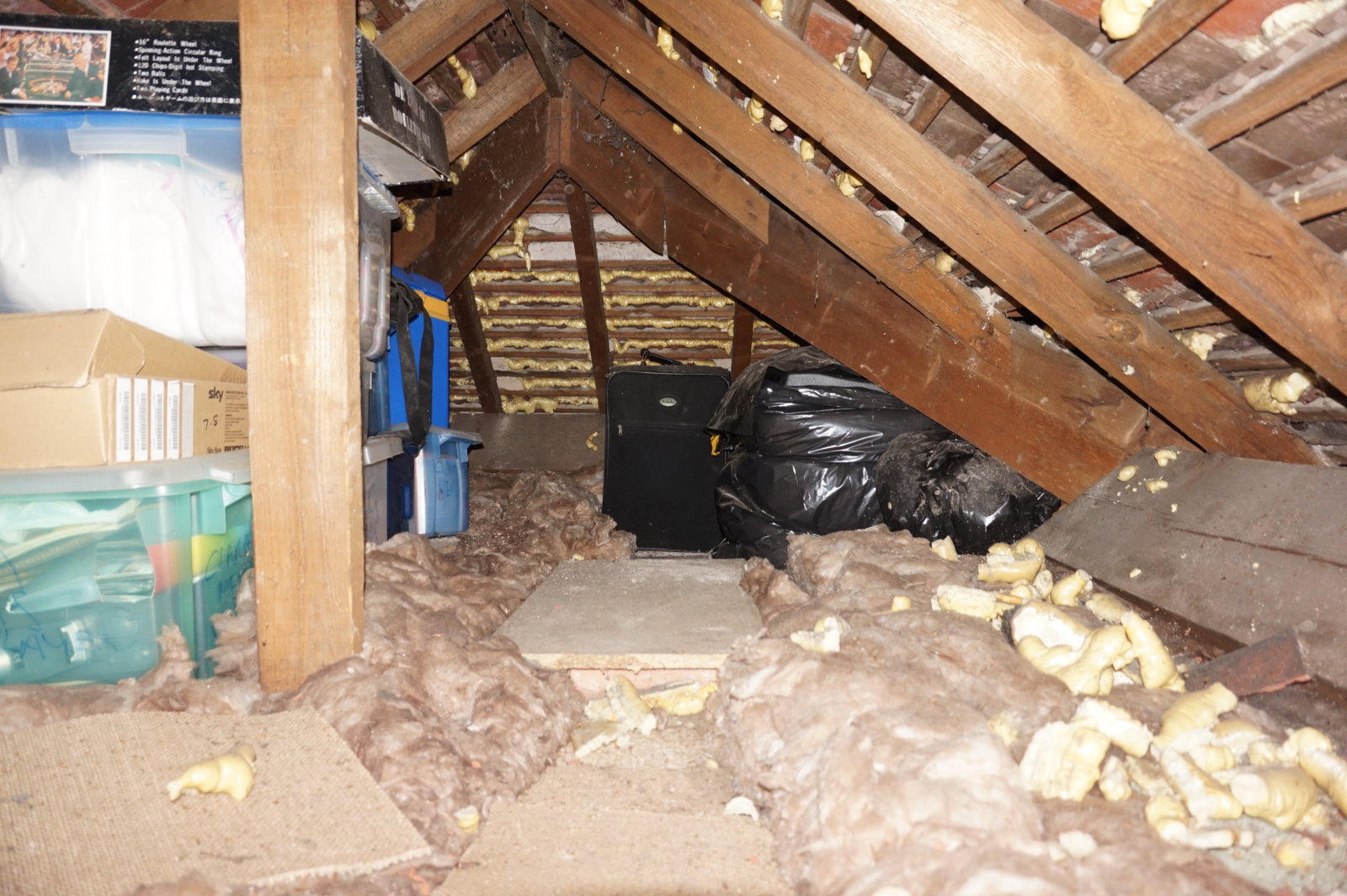

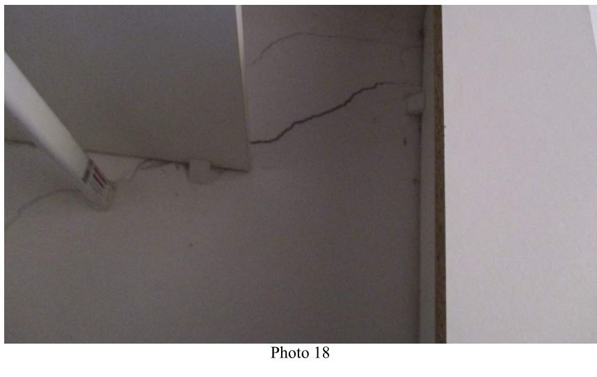

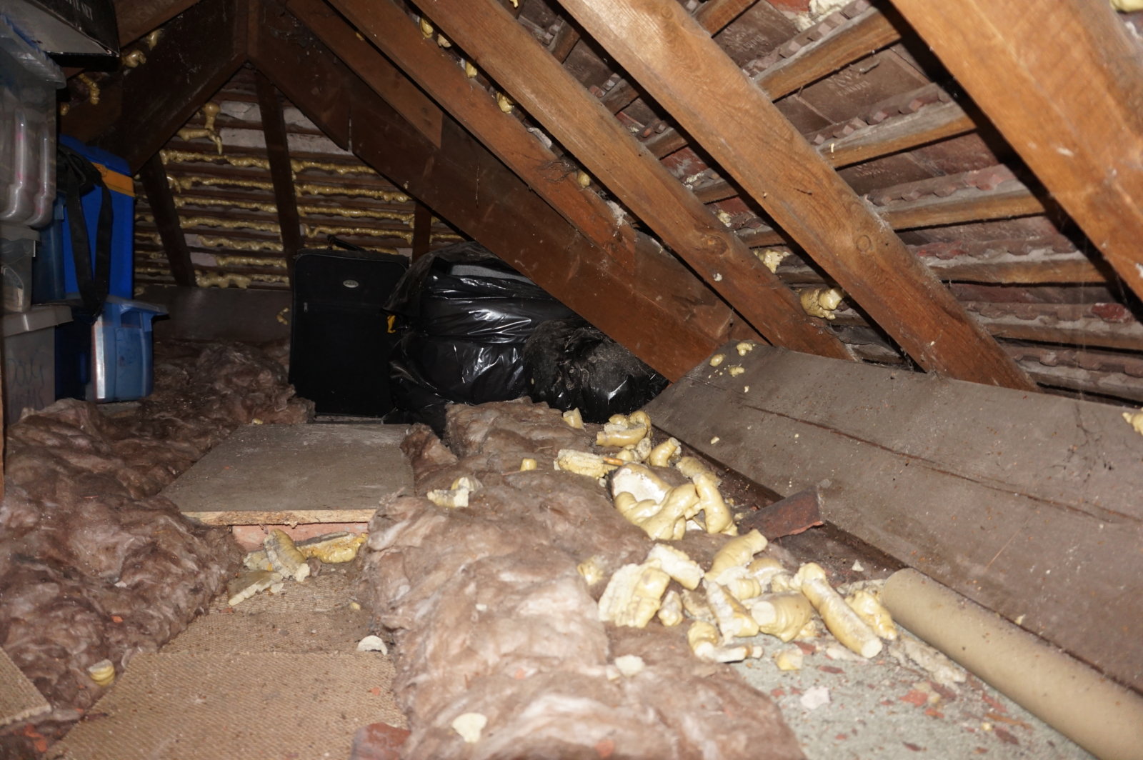

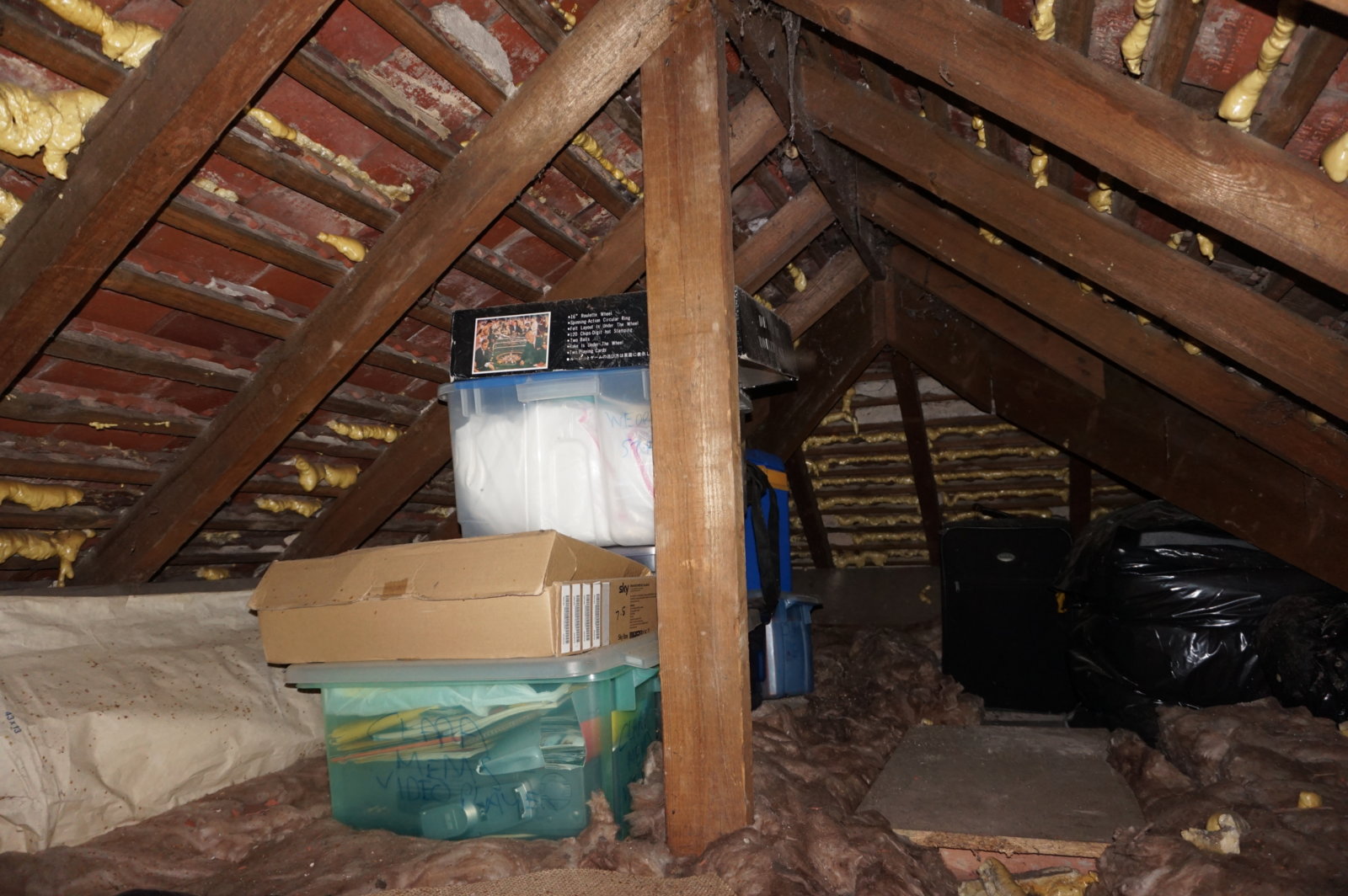

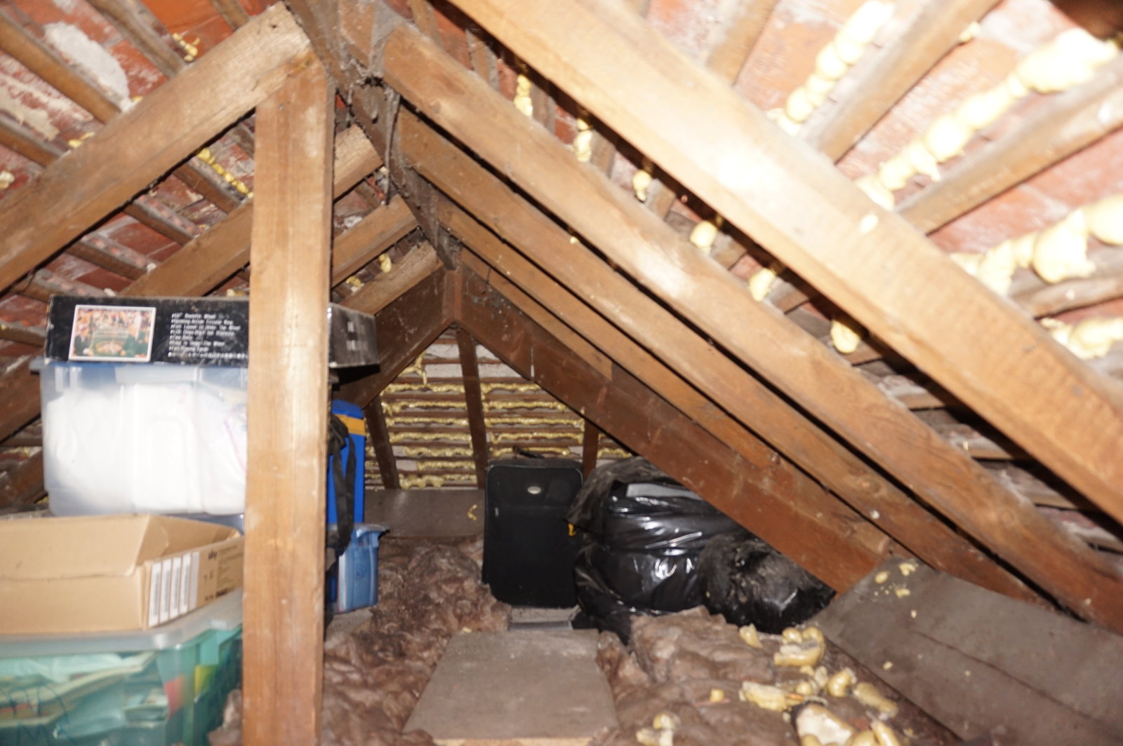

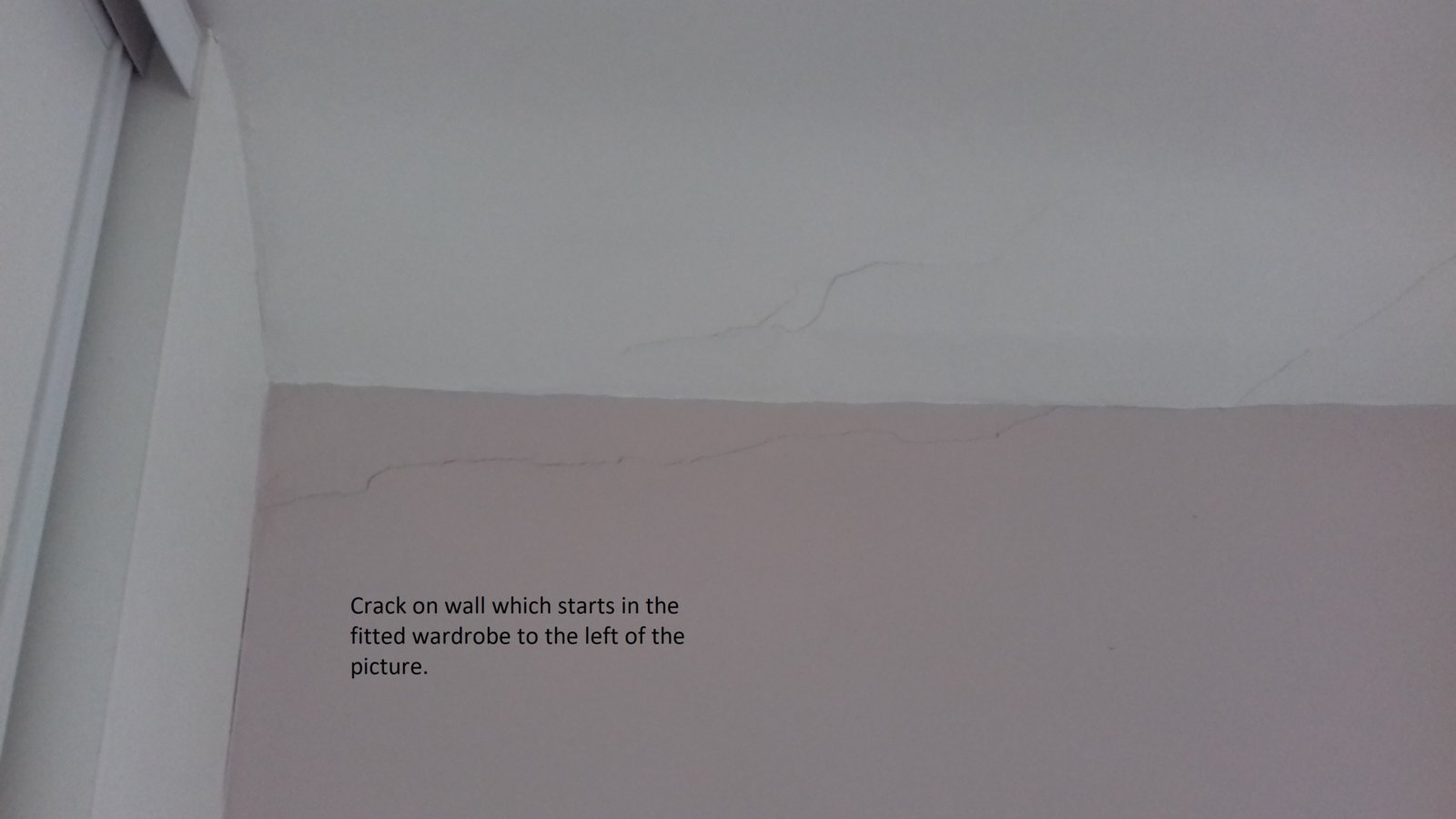

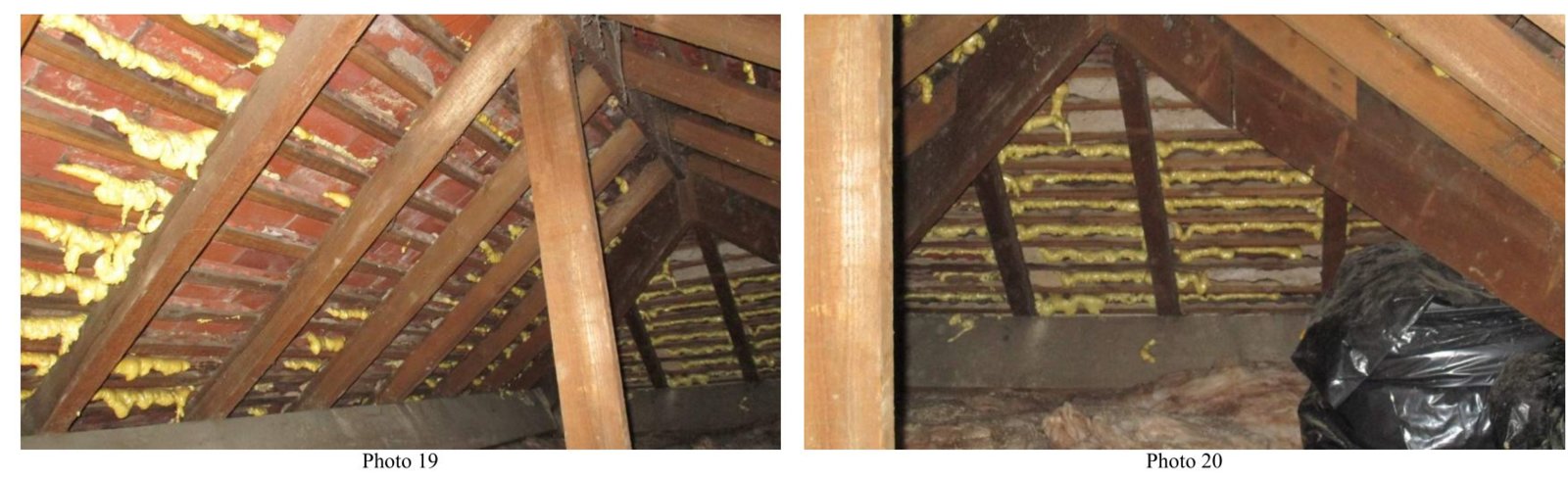

Hi, thanks for the responses. We have been having to deal with a wasps nest in the loft that is in the process of getting sorted so cannot go up there at the minute to take pictures. I've some pictures taken of the loft from when the survey was done and I'll upload some more of the wall / ceiling areas with cracking tomorrow morning. The cracking in the wall in these pics is a little awkward to see since it is inside a fitted wardrobe but these cracks are located around 2 feet from where the ceiling meets the wall and do not appear to have gotten any worse in the last couple of years. Hopefully these images will show ok...
Edit: you can see in some of the pictures what looks like a cracked beam but it is actually the lower part of a beam fitted at an angle to the upper beam. There is still a gap between the two beams though but I don't think this is in the area where there is the cracking in the wall / ceiling below.

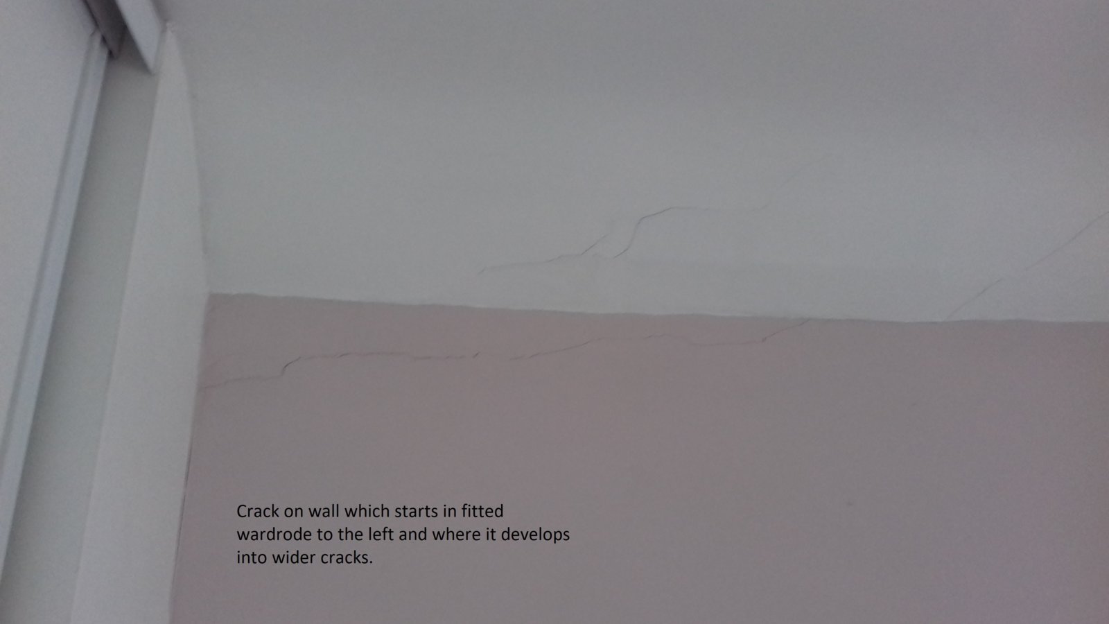

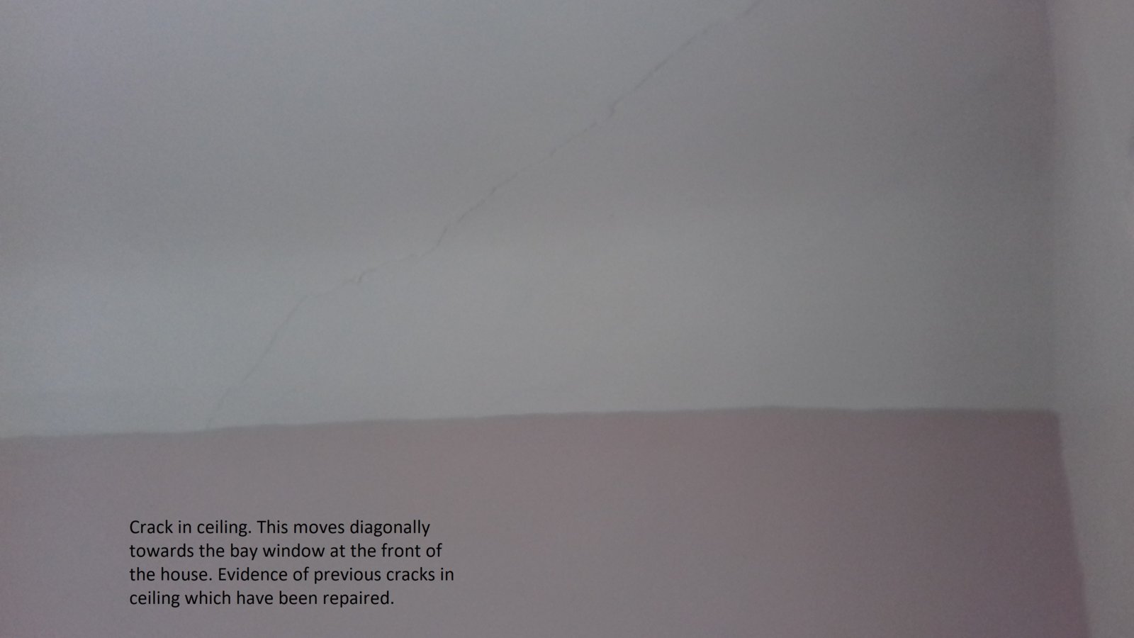

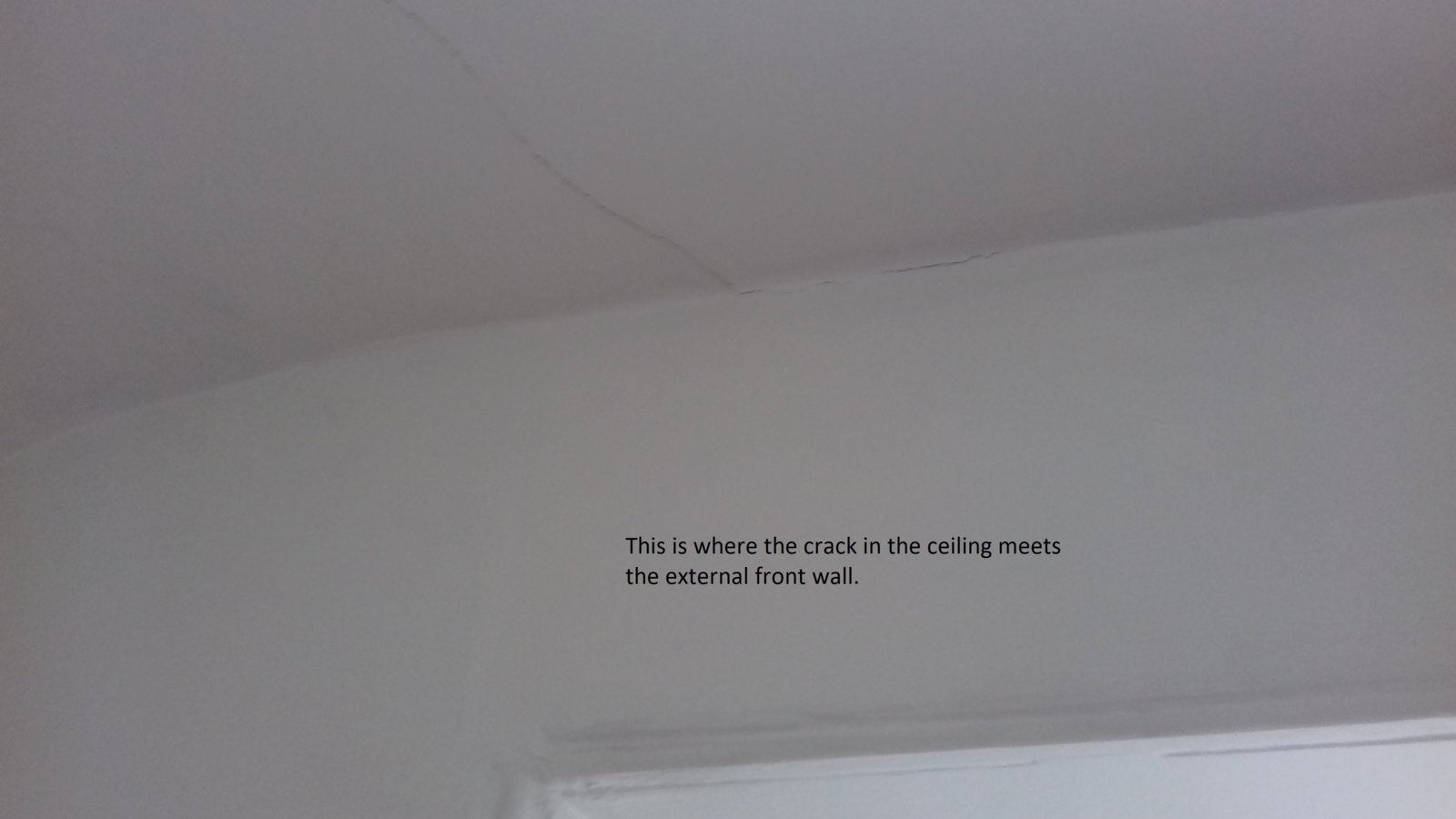

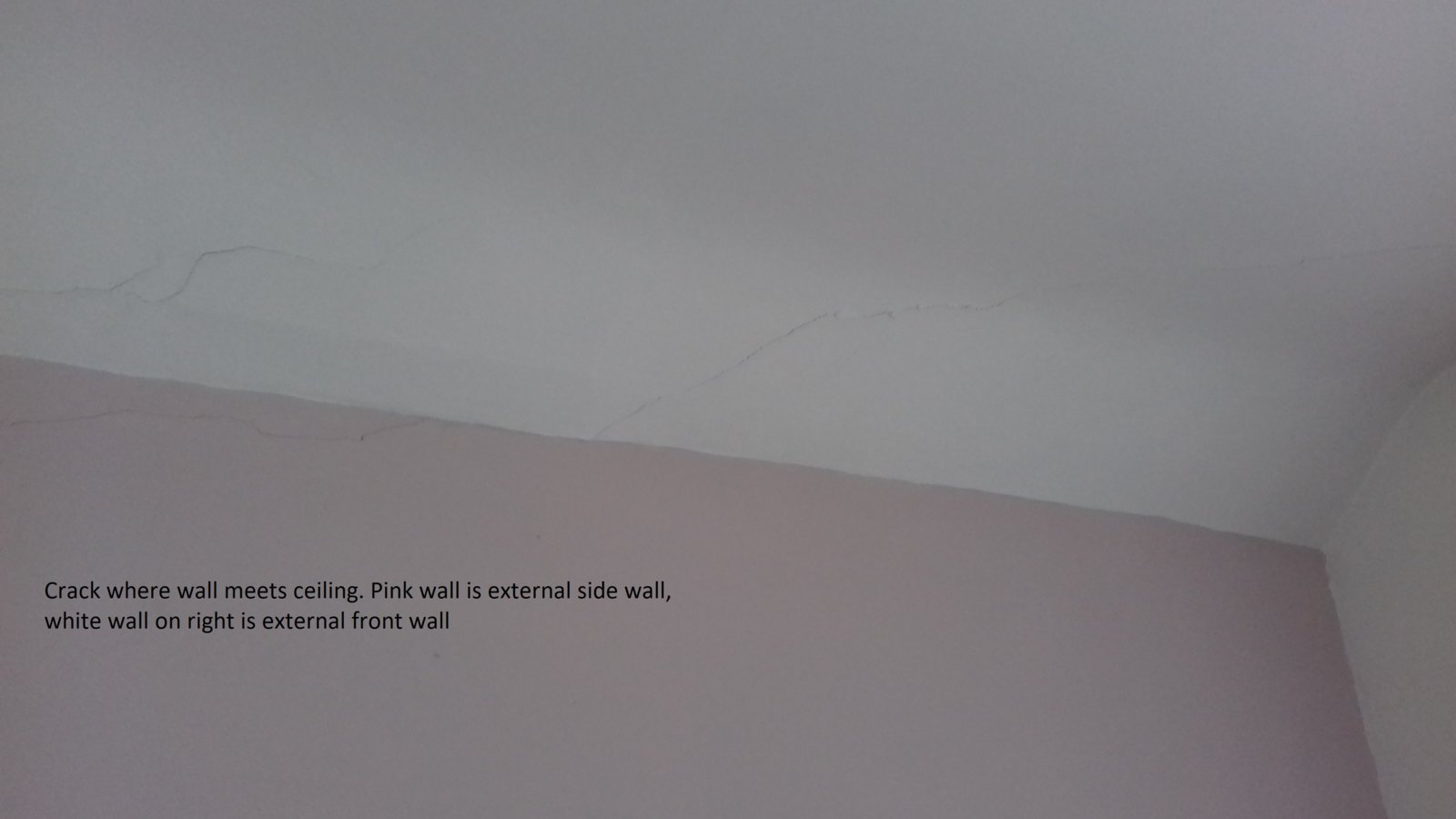

More pictures as promised. These are of the actual wall and ceiling area. If you need any more pics or info let me know.

Hi. Bumping to see if anyone can advise... I have bought a light and extension and will be heading into the loft in the next couple of weeks for myself to see if there is anything amiss there. Failing that we have told it is potentially a case of getting some roof ties fitted (the metal things that are fixed onto the timber on top of the wall the roof sits on, and then attached a few feet down to the inside wall).
Those are holding down straps, and have no purpose in dealing with roof spread.
The ceiling joists are the ties that stop the rafters spreading. If those are in order then you don't have roof spread.
If you had a proper structural engineers report on the problem, then he should have given you the required remedial work. If not then you need an engineer's report and schedule of work, and do not rely on any tradesmen's "I think you need to do this" type opinions.
anb010, good evening, again.
The holding down straps are intended to prevent the roof "lifting" [caused by strong winds / and suction on the leeward side of the roof] and as "woody" above have absolutely nothing at all, at all to do with roof spread, suggest you Google roof hold down straps.
As the H/D straps are made from Galvanised steel, a magnet run over the external walls will locate them, they are about 700 / 800.mm long down the wall.
If you are venturing into the loft, images of the connection between rafters and ceiling joists [sometimes called "ties"] would be good.
