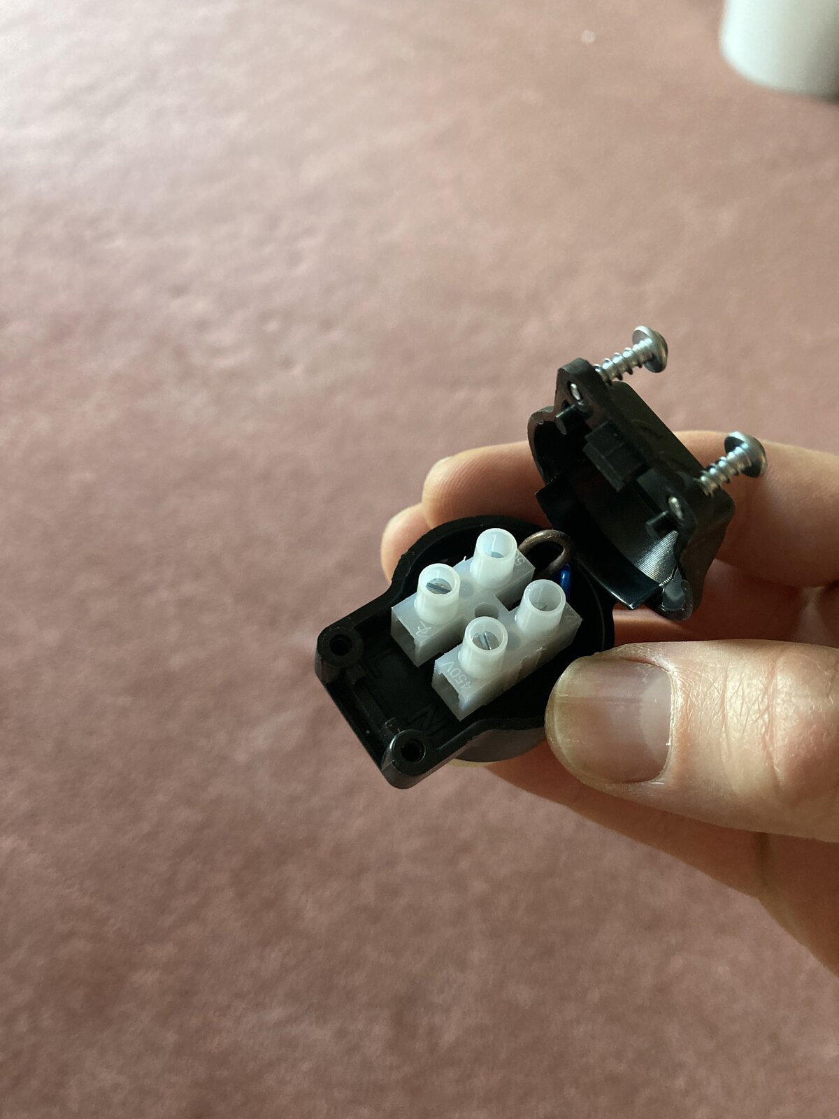

Hi all.
I have a set of 3 spotlights to install (GU10 bulbs) and I was expecting a loop in/loop out type connection to be able to daisy chain them. However, all I have is a terminal block as per photo, for each one.
Do I need to wire these all individually from the one location where the ceiling rose was (now wago connectors in a junction box) or is there a better way to do it?

These: https://www.toolstation.com/greenbrook-lighting-connector/p79534 for the circuit wiring, and a short length of 2 core flex from that to the light.
If this is replacing a ceiling rose or similar that needs 4 terminals, then the first one uses a 4 pole variant, https://www.toolstation.com/greenbrook-lighting-connector/p13165
For future reference, decent lights are supplied with similar things prewired to the light which is much faster and usually cheaper than buying things separately.

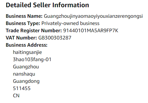

Would something like this work, and then I can take the live switch/neutral from the 1st light, to 2nd and 3rd?
https://www.amazon.co.uk/CESFONJER-...d2lkZ2V0TmFtZT1zcF9zZWFyY2hfdGhlbWF0aWM&psc=1

Such things would need a suitable enclosure, and even then they are still unknown junk imported from a vendor far away with a made up name with no recourse when they cause a fire..

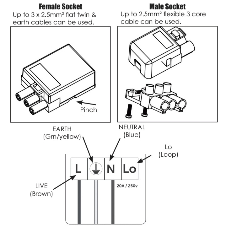

Why would the 4 pole Greenbrook be needed to replace the rose in this instance, when the 3 Pole connector has 4 terminals including the loop?
No doubt a stupid question- how do you use the single loop terminal, to next light fitting?
Sorry to revisit this and appreciate this might be reaching the point where it might be questioned if I understand the basics enough to be fiddling with this- but it is moreso (I think) just double checking I understand correctly and wanting to learn, to do it properly.
The female socket states up to 3x 2.5mm core and earth can be used- thus am I right in thinking each pole can accomodate up to three wires and therefore I simply run two additional cables, connected to the same live and neutral at my first connector, to the two additional lights (using a further two connector sets at each end obviously)?
What would the loop terminal be used for?
