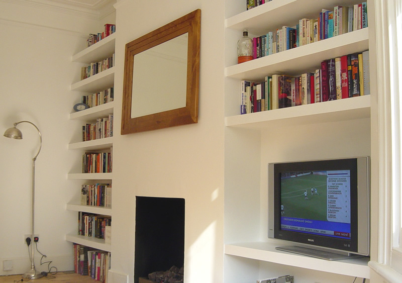

Looking to build a shelf that will sit inside a recess formed by a chimney breast and wonder what the best wood to use is?
I had planned on building a ladder frame and adding a top and bottom.
The width of the shelf is quite wide, approx 10ft
It will be pained white a bit like the attached image so no need to have raw wood showing.

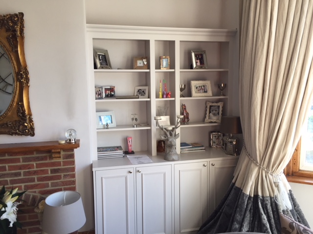

Above is one I built a few years ago.

We can't really have any supports going downwards so I guess a floating shelf system is my only option?
We want it similar to the bottom shelf in this photo:
