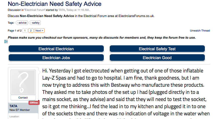

There is an interesting, and associated, topic on A.N. other electricians forum that starts off like this:
I hope it's OK to throw up the URL of a competing forum...
but its here
https://www.electriciansforums.co.uk/threads/non-electrician-need-safety-advice.160862/
