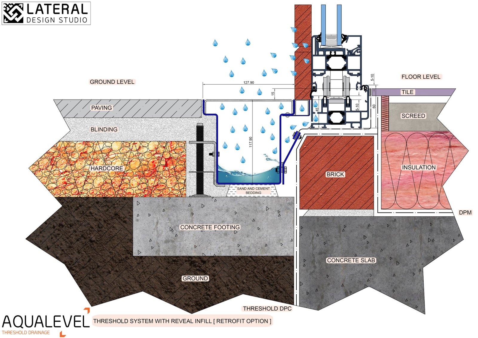

I want this doing properly so wanted your advice please. I’m having my patio taken into the same level as the inside of the house and I’m having new bi-fold doors installed. I’ve seen that some people set an ACO drain against the house and the cull of the doors runs straight into the ACO.
I realise this will work but I wondered how it can be done so you don’t see the cill. Is there a certain threshold that can be fitted that can drain into a provison so the water gets again from the property.

don't use a cill use a standard threshold with an aluminium pressing instead of cill
The purpose of a cill is to cast water off and away from a building. Now, if you are raising the ground to the threhold level, then this removes the requirement for a cill.
But it does introduce a new requirement for water to be prevented from running directly under the frame/thresold, and that needs dealing with.
You don't need a surface drain unless the ground or patio is sloping towards the building, but depending on the design, it may be adventitious to have a drain to catch run-off from the doors. But a well drained patio would acheive the same thing.
With levels the same garden litter will tend to blow into the home very easily.
Bringing the outside, in, literally .
Yes, good points about litter blowing in.
woody, yes, I agree that the cill would need removing in this instance. Just trying to work out how I can have the patio built up to the doors though without causing a drainage/damp issue.
I've now got a price for the drainage system I originally mentioned and it's come in at an incredible £4.5k. I am genuinely shocked at how they are managing to make sales of what it essentially a glorified ACO drain for those sorts of figures. I need to look at other options as this sort of money is simply not doable at all.
If anyone has any suggestions on how I can achieve this then I'd be really grateful please. Thanks.
Check with your bifold manufacturers carefully. Most state in the small print that low thresholds are not weather rated!
Personally I like Smart's DV176 combined threshold/cill but it does have a 20mm lip
