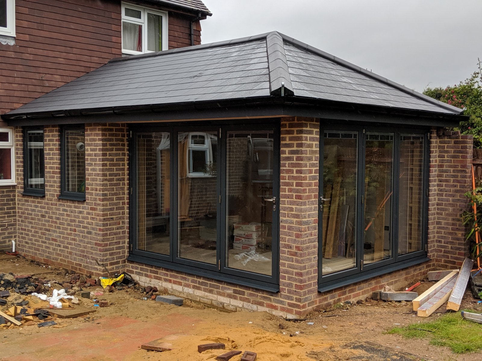

Hi guys, my little extension is starting to take shape at last.
We are having some 3m bi folds. ( well probably 2.85m now to be exact due to some other issues but that’s another story.
Anyway. I had in mind aluminium. Not sure why but I was adamant I didn’t want UPVC. Think I was worried about expansion In heat then having problems with them down the line.
My builder didn’t have a preference, my architect said straight away aluminium. The guy who had just done the rest of the windows in my house said aluminium but UPVC are ok but wouldn’t want them if the door size was over 3m
Opinions please?
May cost a bit more but no hassle once fitted.

I was leaning towards aluminium but in my head at least I have concerns over the UPVC expanding and contracting with the heat then giving us problems later down the line. Our window guy was trying to steer us towards Ali but did say UPVC was ok for less than 3m. He wouldn’t do them bigger than that was his words.
I’m happy with the extra cost, as long as I’m getting something “better”. Think this is why i posted.
Ali all day long

As Ive prob mentioned before, Ive manufactured and installed many timber bifolds without issues -hardly any call backs. However its true wood will expand and shrink (the stiles change width). The more doors there are the more potential there is for bigger movement. Bifolds are best made from accoya or engineered laminated timber.
Aluminiums only disadvantage is risk of condensation.

Aluminium will be fine south facing. Powder coating may fade over a long period of time but not to badly.
