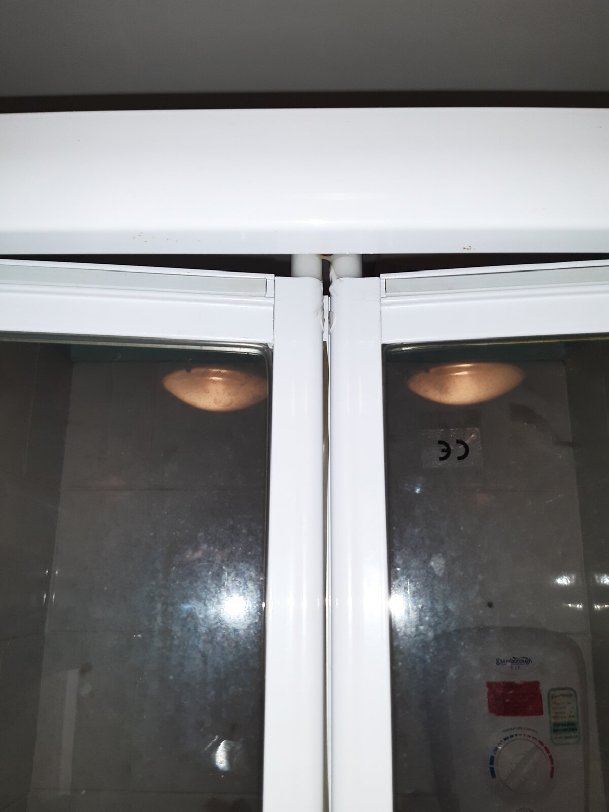

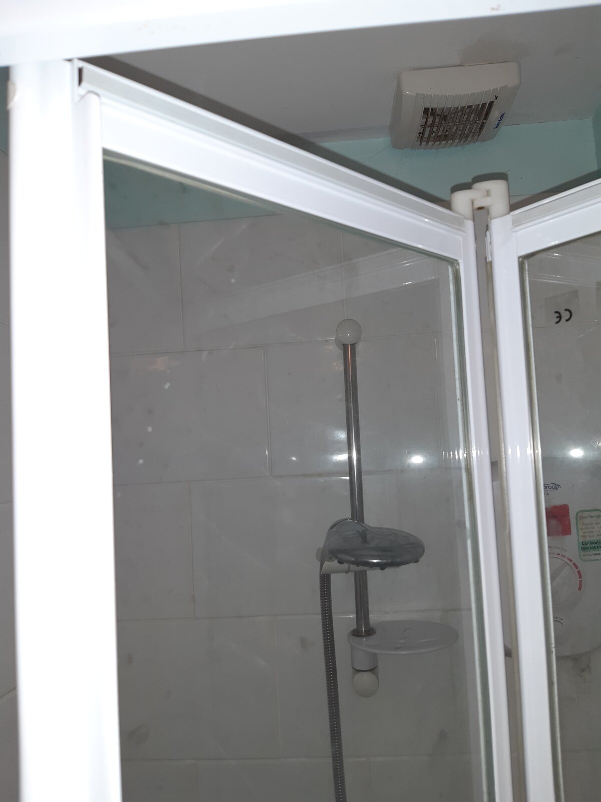

Hi, I have a bi fold shower door, it won't shut flat, I can't see any stops on the rail or adjustment of any sort.
Any ideas please ?
Need a better picture, such as a full width one showing the centre fold and other end.
Is that any use ?

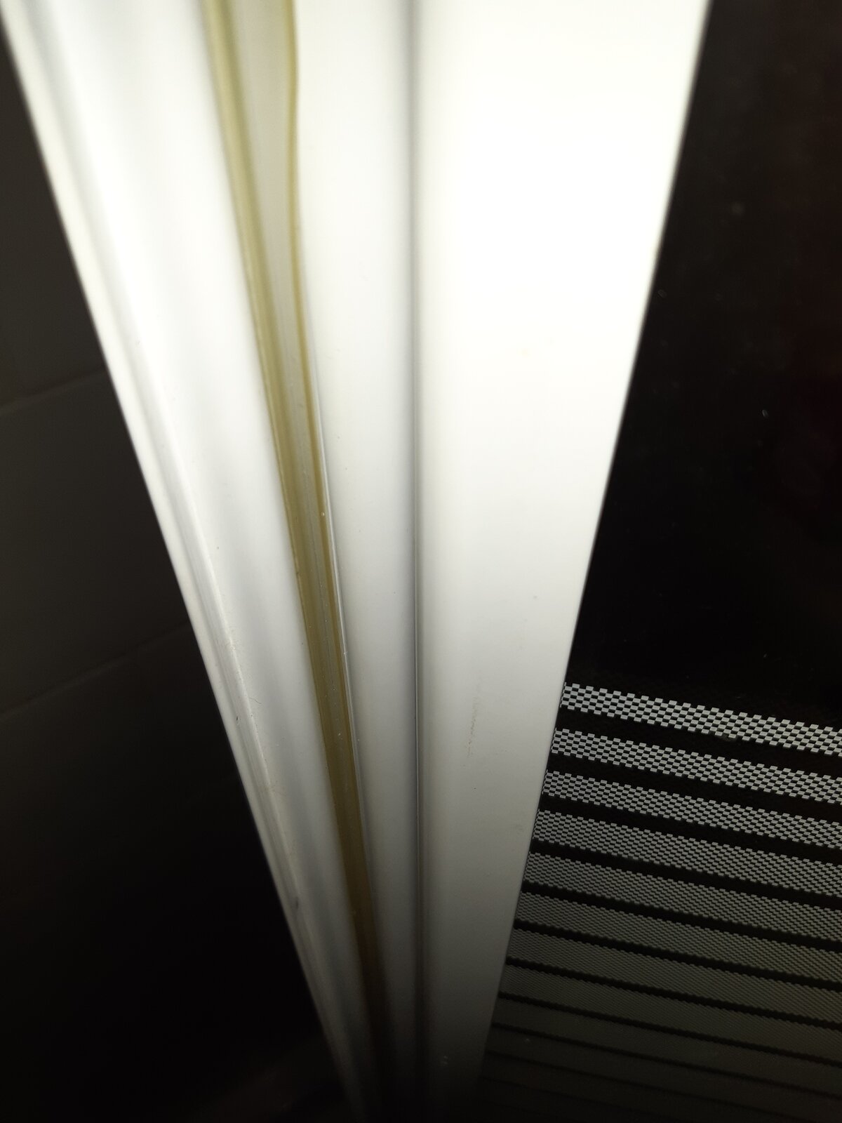

I notice the seal in the middle looks warped, maybe I could trim the part that goes the opposite way ?
Also there are strips at the top and bottom , which I assume are magnets,
one of which looks like it's maybe 1cm out of place, can't see that making the difference though.
Also there are screws on the top of the upper wheel blocks that I've tightened which I think may have been a slight vertical adjustment ??
Seems like it helped a little
It's done it for some time, I'm not sure if from new as I bought the property with it in
Might just be poorly fitted doors then? Adjustment on those could be the screws to the frame.
