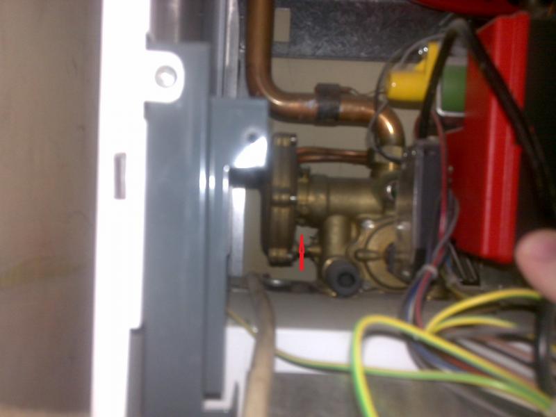

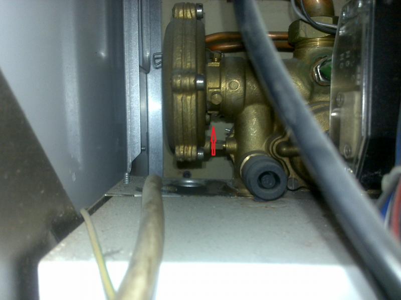

Hello, i have a biasi 24s combi boiler, it is working finr for both hot water and central heating, however i have a small leak that appears when i turn the hot water tap off, i have looked at the manual and it says its the diverter valve. I have attached these 2 pics to help, it is not leaking from the large part of the valve but the small part in the middle as shown by the arrows. Does anyone have any suggestions as to how this can be fixed?

Does the system pressure drop? If so it may indicate the leak is on the system side of the diverter valve.
To confirm, isolate the cold feed to the boiler, remove the retaining clips and disconnect the two small pipes at the back, loosen the two screws and pull out the left hand circular brass lump. Either the gland seal in this part or the corresponding gland in the main diverter body will be leaking.
There are 2 spindles in there. You will find the small o rings are perished (probably on the rh side which is the ch side). Should be able to get a service kit for that (drain down required). I think Halstead boilers use the same diverter valve so try them if unable to get it from Biasi.

If its NOT dropping then the fault is the pin seal on the hydraulic unit and the water leaking is mains water.
The tiny seal has to be replaced but its essential to ensure the pin shaft is totally clean before reassembly and the pin is lubricated with silicone grease.
Biasi can supply the seal but you are better going to a local parts supplier otherwise you may end up paying a lot of carriage for a small part.

Sorry m8, was late and my brain wasnt functioning properly!!! The system pressure isnt dropping at all, it stays just about 1.5 bar. Hope this helps

In that case its as my 1255 posting today as I had expected!
