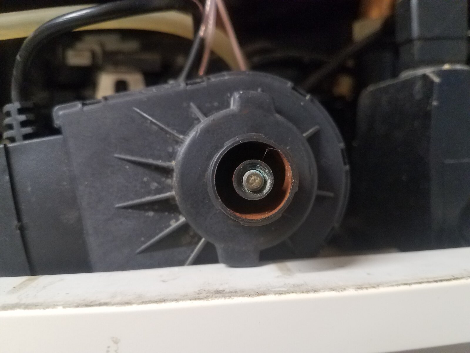

Normally when I turn on the hot water tap I can hear a thud which is I believe is the divertor valve switching position via the actuator, not now. After disconnecting the actuator I can see that the pin is always in the forward/out position. I am able to manually push the diverter valve in and out.

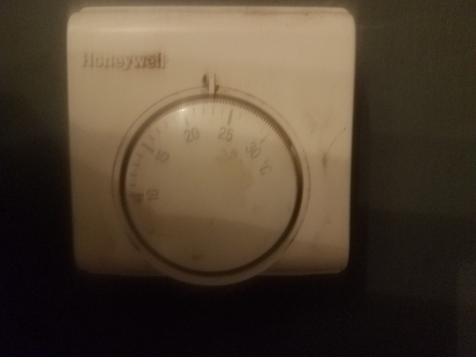

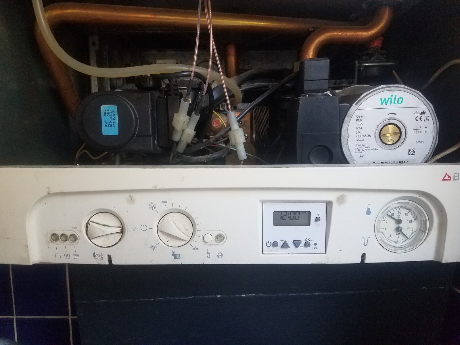

post pics of your thermostat and any other controls you have a the control panel on the boiler
Thanks for the replies here are some pics
Have you set timer to constantly on?
Yes, was working fine like this for years and then suddenly after being off for a few hours the CH stopped! Are you saying it simply reset itself?
That is why I asked you to post a pic of the control panel, your on board timer is not calling for heat, you need to set it to constantly on, a pic is better than a thousand words, those timers are absolute cheap rubbish ,press the little M button (manual till it says H ON then you can control it with the thermostat
@ianmcd Thanks, silly me, sorted! Up and running. Sorry for the trouble guys. Embarrassing! When you don't know, you don't know!
