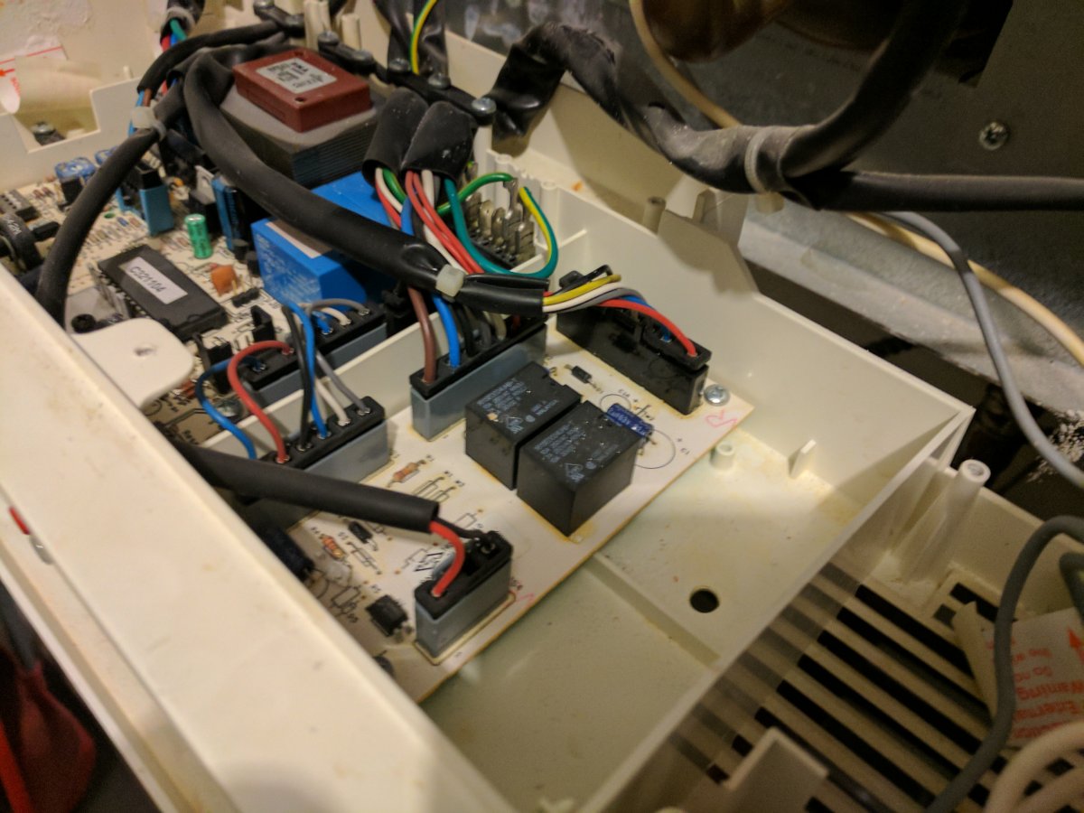

Hello. I am in the US. One of my clients has a Biasi Riva m35.30CB (older version than this thread) and had intermittent issues where he would have to constantly run up to the boiler and turn it off and turn it back on. ONce the heating system reached temp it would then blow cold air. Two flashing lights with a solid red in the middle indicated that the ignition was not occuring properly.
Thanks to my conversation with QHT inc. and reading this thread, I determined over the phone that the APS/Fan controller board was most likely the culprit.
I arrived having never replaced one of these boards before - 2 screws on the front plate, 2 on the bottom, pull out the entire control panel, 3 more screws for the plate covering the main board and aps board. Had to shut off the central heat in the apart, reset the boiler one more time, and everything has been wokring perfectly.
Thank you to Philip Smith for posting this info. The part was out of stock but I managed to find a salesperson for QHT who had it in his travel kit. Woo hoo!

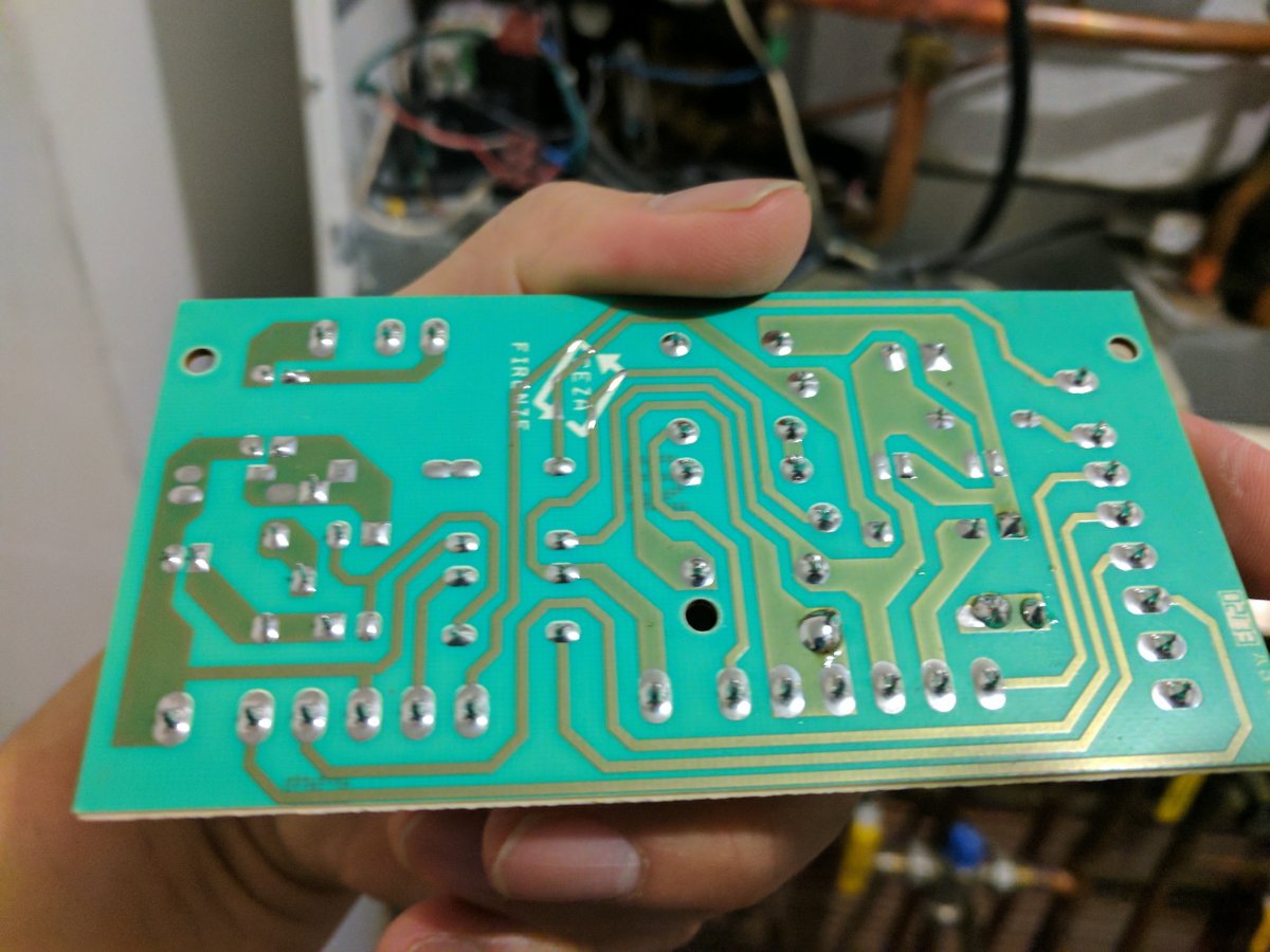

Here are some pictures of the bottom of the defective APS/Fan controller board BI1555108 that I replaced. As you can see this board was beyond repair. Being in the northeast and in an unheated rooftop room I can see how condensation and the heatcycles could cause some condensation as well as expansion/contraction.
Compared to the new board:

That is what we call a storage combi. Biasi ones are rarely seen in the UK.
The normal way to use them is to leave them on 24/7. The resulting heat loss from the hot store would usually prevent any condensation.
There should be a plastic cover on the top of the PCB box. I do hope yours is in place.
I would have expected to recover the old PCB.
