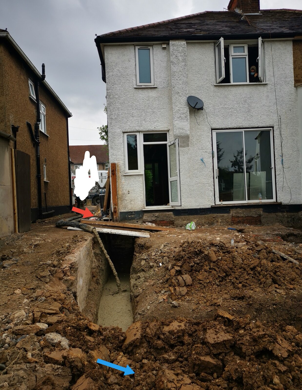

Not sure what to do from the sliding opening to the garden. There is an approx 1.3m drop. Initially planned for steps but would like a 3m long towards the end of the garden patio to be flush one eng brick under the air vents. Would you construct this from block and beam to have some storage under? See picView attachment 246290
went down prior approval, and the height for the extension was measured as the highest natural ground adjacent. As there is an approx 1m drop at the lawn would rather have a patio at the rear, rather than stairs. PP is a must? Thanks woody, fmt, tony etc in advance for your wisdom
Without planning permission, any patio or raised deck height is limited to 300mm above the highest natural ground level beneath it.
We calculated the PD height of 3. based on the immediate ground adjacent. The red arrow is 0.3m lower than the front of house and The blue arrow is 1m lower. It will mean the end of the extension is 4m heigh. Also we have taken away a lot of the land from the slope as a large garage was previously sitting on it.

Woody does the above make sense and would you see that as acceptable given the end of the extension being 4m. The PD under prior approval says max height is 3m but the definition of height says any land adjacent so I'm hoping this is OK.
