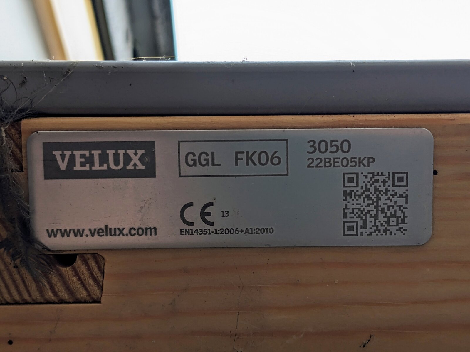

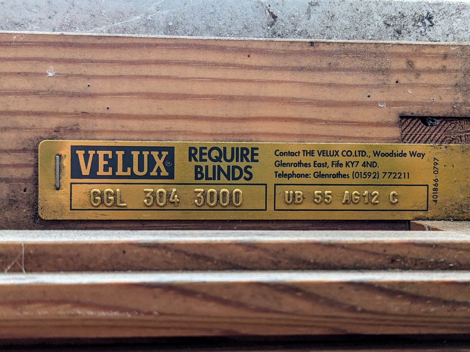

If you open your skylight with the large bar at the top it will reveal a data plate, if you post this and your neighbours I will be able to tell you if there is any difference in your skylights.
Thanks, enclosed here. Mine is the newer look
ing one with the QR code on it.
Yours will have thicker sealed units ( 24mm ..16mm air gap) and Low e glass( and safety glass ), your neighbours will only have a 16mm thick sealed unit ( 8mm air gap ) , no low e glass and probably not safety glass either as standard. So you've actually got a better insulating velux than your neighbour which is another reason why they will be getting more condensation

You won't get the thinner units in new veluxs these days , due to minimum u value (energy efficientness ) requirements of windows . You used to be able to get kits to put the thicker sealed units in but the last time I looked they were no longer available
Hi Remona
The skylight with the gold data plate was made between 1992-2000
and the silver one is the current generation, so as Ronnie has pointed out the new ones are more efficient.
