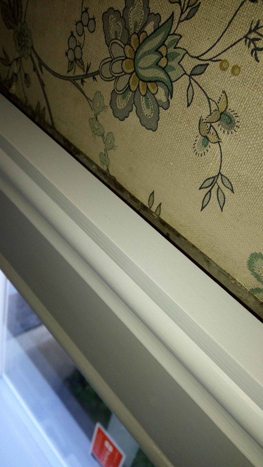

Big Gap Behind New Sash Window Architrave All the Way Around!
6 Mar 2016
17

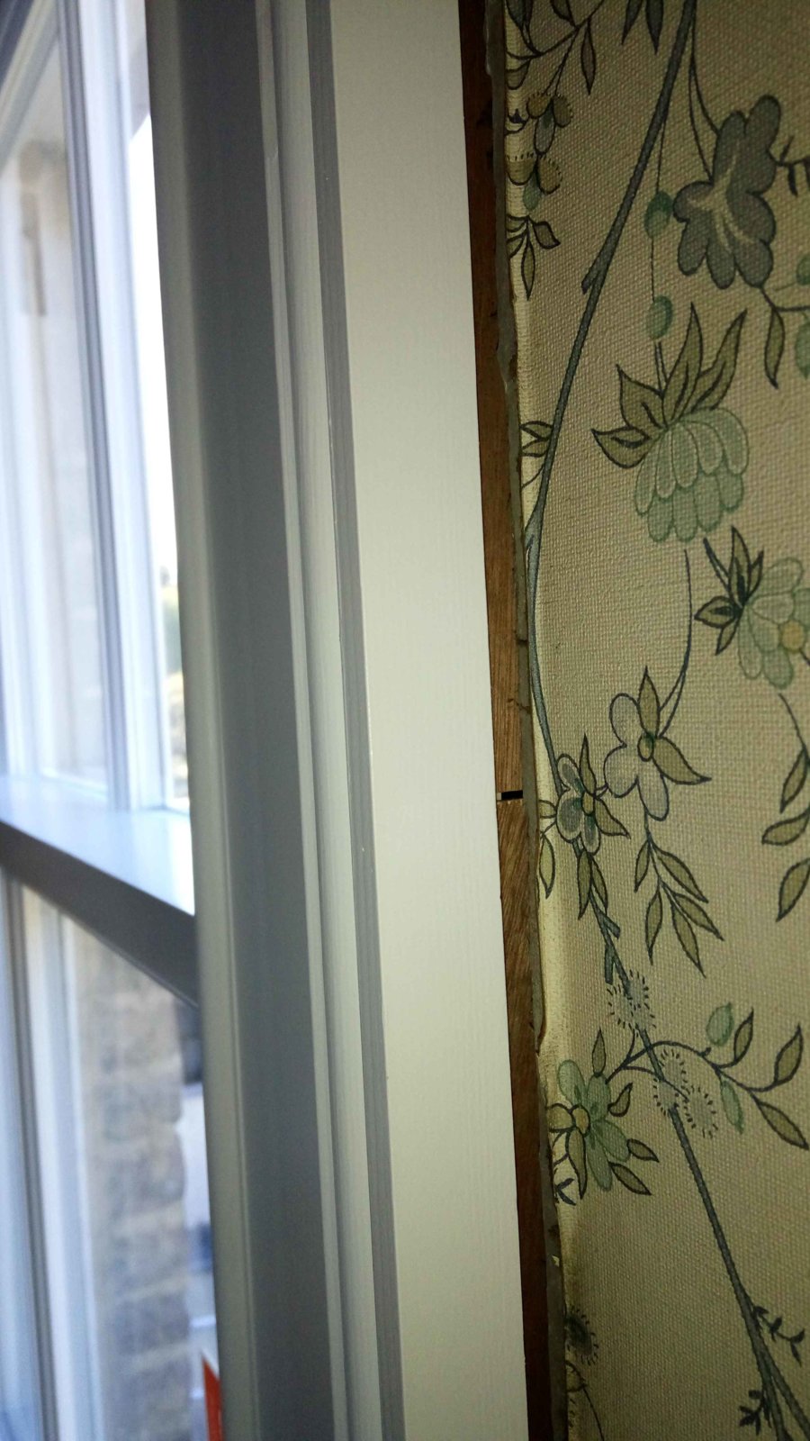

Just had a complete new double-glazed sash window fitted into our Victorian terrace property. Original window was single-glazed. After being really chuffed at having a beautiful, brand new energy-efficient window, a closer look revealed that the architrave doesn't sit flush on the wall, as you would expect. There is a 1/2 inch gap between architrave and the wall behind it; I can put my fingers into it and even curl them round to feel into the actual cavity (or aperture) between the box itself and the masonry! There is no apparent draught to be felt from outside, the room feels warmer etc but having a big gap all the way around a window like this is is ridiculous!
And this is was done by a FENSA registered window guy who is a Which Magazine Trusted Trader.
I was originally told, prior to install, that the window would stick out further into the room compared to the original one but I certainly was not told about any gap! I assumed the new architrave would simply be deeper, yet still be flush with the wall.
What has gone wrong here and what should I do about it? The refurb and install job of a total 5 windows is wrapping up today; I still have 25% to pay. Do I demand a re-install before paying up or what?
Assuming the general workmanship is ok, the gap is because the new architrave is flat but the wall isn't. Maybe some filler or even fillets of wood would do the trick. Do you have a written contract (IIRC trusted traders are required to provide this)?

They havent trimmed up the window properly. Is it a upvc window or timber? -skilled joiners would do it Im sure, upvc installers, maybe not.
The new sash box depth is much bigger so its proud of the internal wall. When the architrave goes on, it needs a 1/2" thick batten fixed to its rear outer edge.
Tell them you want the architraves taken off and redone. Dont accept a naff bead or quadrant added on.
Are they new architraves, or the originals

It's a timber sash and the architrave is new. The window installers have their own joinery workshop.

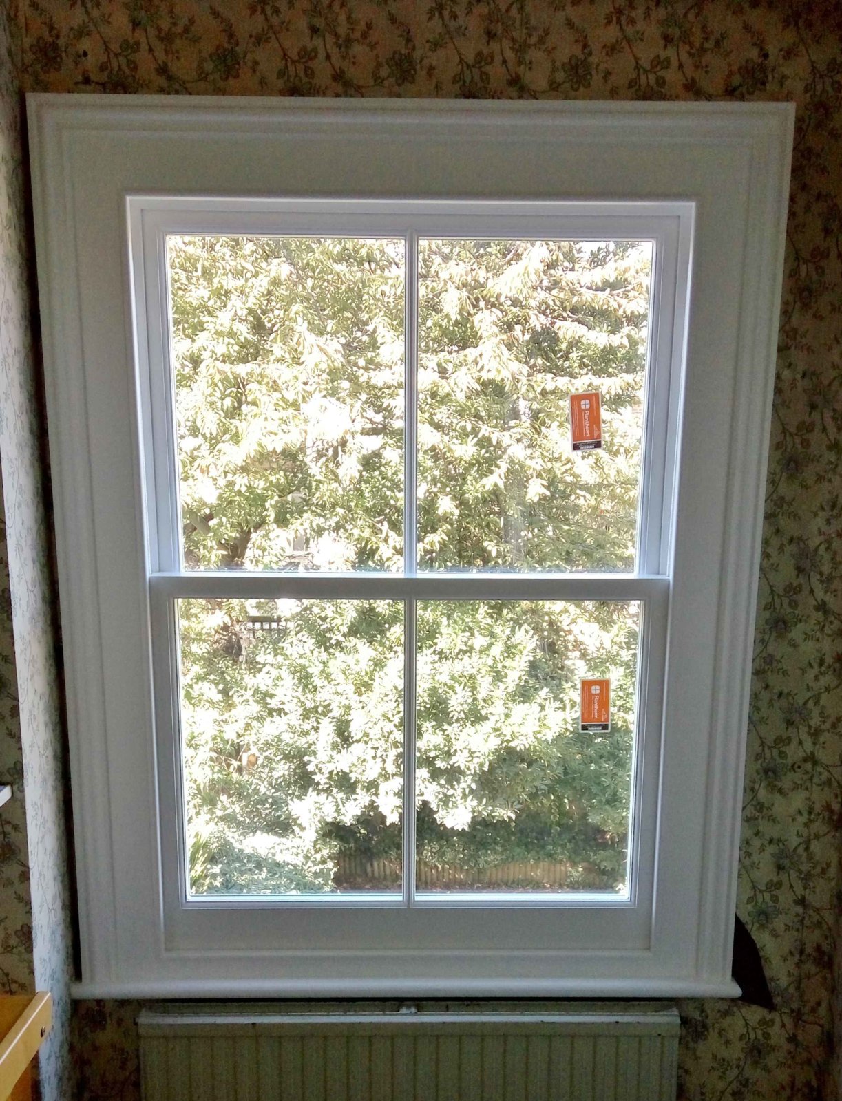

I've attached pics of the gap problem. From left to right, there's a side view, a top view and a pic of the window itself.

Also, they've supplied a noticeably higher and wider architrave compared to the original, so the left side nosing touches the chimney breast and the whole thing looks huge in proportion to the small bedroom; I can live with that, I suppose, though I don't know why it's so large.
So, get them to remove architrave and increase depth all round? Is it a big pain to remove and refit the architrave?
Architraves are usually pinned (nailed) on so apart from a little bit of redecoration it shouldn’t be a problem.

Thank you Notch7 and Blup. Your responses gave me extra courage to insist that the only proper way to resolve this matter was to take off the architrave and add battens all round to make up the depth, which the window guy has agreed to do onsite next week; he was trying to get away with just filling the gap. o_O Let's hope he doesn't try to oil out of it!
View attachment 149220 View attachment 149221 View attachment 149222

The architrave closing the gap from the wall to the front face of the frame should just be removed and repinned to correctly fill that void. Alternatively, another thin trim can be used face over the gap but this would increase the width/height of the window and make it even bigger than it already is.
It may be possible to reduce the size of the window by reducing the size of the architraves closing in the sash boxes - that depends on how deep the sash boxes are though. old sash windows are single paned and new are double glazed - the letter being considerably heavier and needing bigger weights. This can require a bigger box, especially on smaller sash windows.
