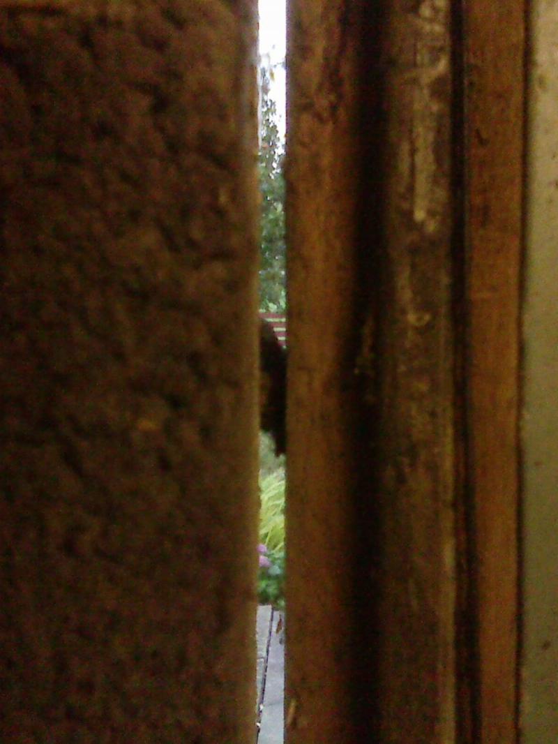

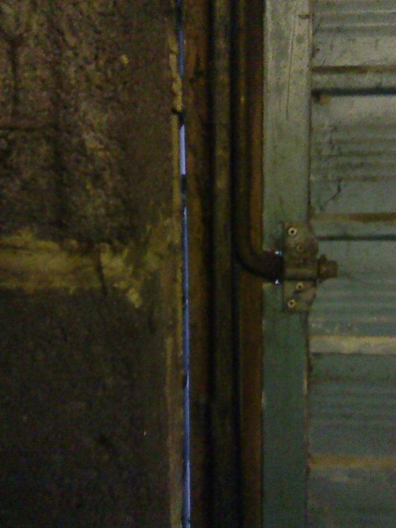

Which is best for a gap between a garage door wood frame & brick wall - silicone sealant or expanding foam?
The gap on one side is pretty much 5mm, top to bottom and pretty similar on the other side. Don't know if the photos do it justice:
The garage has doors at either end, so the wind blows through all the time and the side of the house gets very cold in the winter. I'm sure the winters are going to be minus zero a lot more often as well, so I need to draught proof everything.
I've looked at what's available in Screwfix, Toolstation, UKSealants and lots more online, but there are so many and I don't know which ones can survive cold weather. Maybe they all can.
I'd be grateful for some advice.
Thanks.
Foam it.
It will actually help to bind the two surfaces together. Just make sure the fixings are secure and that the ex-foam is not allowed to push the frame.
if you make wooden trims to hide the gap, you can inject the foam through holes drilled in the trims. This will help the fresh foam stay in place to fill the gap and not bulge out uselessly.
Inject from the bottom and let each squirt expand before you inject through the next, higher hole. It expands more than you think. Spraying with water hardens the surface quickly.
Wrapping the trims in clingfilm before you fit them means they will not be glued in place by the foam so can be removed if necessaey. You can paint or stain the trims for appearance.
